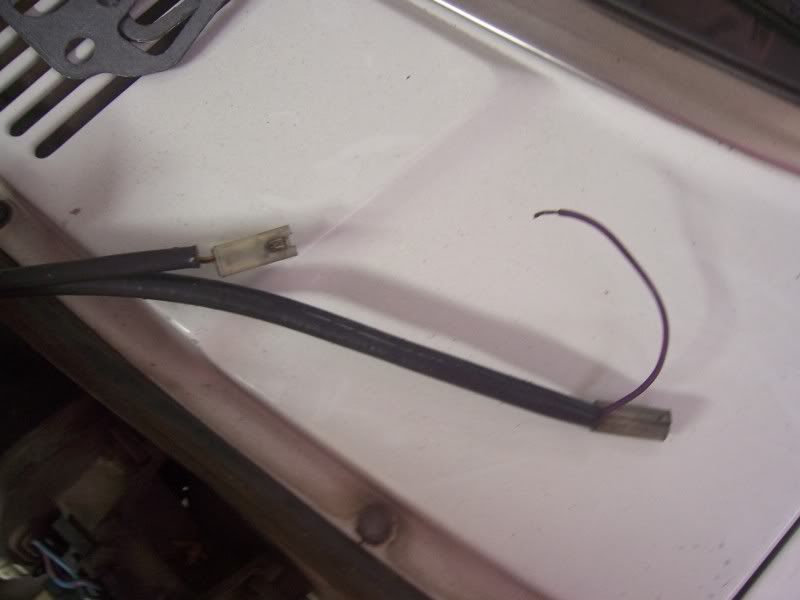

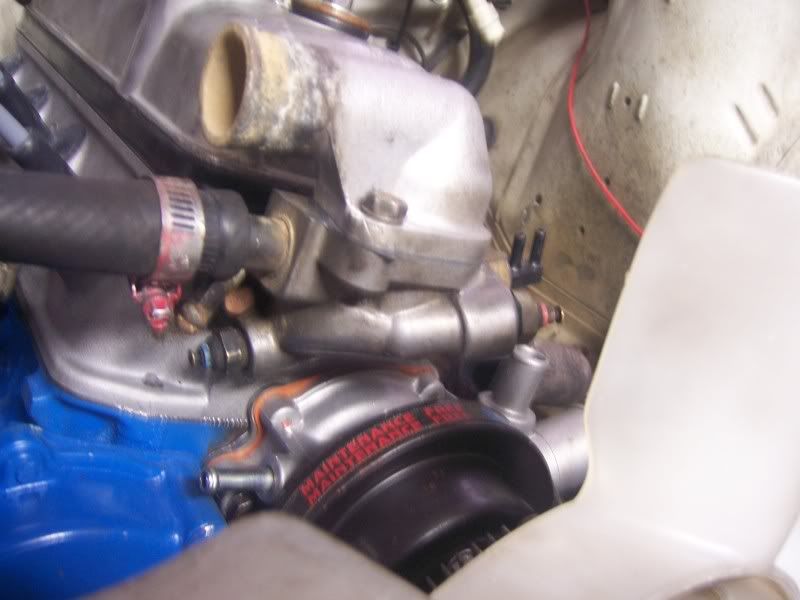

anastasios Posted November 16, 2009 Author Report Posted November 16, 2009 (edited) Hey guys I have got my engine and gearbox in the car atm, but am confused about the K50 wiring, it seems the K40 plug on my 70 loom is different to the K50 white plug, also I am confused as too which wires go to which sensors on the engine. I have some pics to help explain. These are the 3 plugs that go to the box The plugs on the K50 The plugs and a random wire on the other end These are the sensors I have on the engine Also which side do the wires run? Edited November 16, 2009 by anastasios Quote
Taz_Rx Posted November 17, 2009 Report Posted November 17, 2009 (edited) Ok GB first: The white plug with 2 pins needs to be connected to the 2x red wires with the spade terminals. Just cut the white plug off and clamp on some new female spade terminals to join up to the GB. The other 2x single wires that go to the GB are for 4th and 5th gear indicators. These are connected to the carby and are for cruising fuel economy. Don't bother hooking them up (not that you can to the holley anyway) and I don't think fuel economy is high on your list anyway. Now onto the other wires. Third pic down - I'm pretty sure the plug on the left is the oil pressure switch (should be black with a yellow trace IIRC). Plug on the right is for the temp sensor on the driver side. loose wire would be the other one on the passenger side of the thermostat housing. All 3x of those wires run down the drivers side past the dizzy, other side of the engine can get a bit hot! :blush: Edited November 17, 2009 by Taz_Rx Quote
anastasios Posted November 17, 2009 Author Report Posted November 17, 2009 What about the green plug on the gb? Quote
philbey Posted November 17, 2009 Report Posted November 17, 2009 (edited) Just to elaborate on taz's post, yes, the oil pressure is black/yellow. That's the sensor plugged in just next to the oil filter. There are two switches on your Thermostat block. the drivers side one will most likely be the temp sender, the sensor on the other side is possibly a thermoswitch for a thermofan, or perhaps an emissions thingo. Edited November 17, 2009 by philbey Quote
Taz_Rx Posted November 17, 2009 Report Posted November 17, 2009 thanks Tom, I breezed over a bit. You're right - Drivers side one is the actual temp sensor, left one doesn't even have to be hooked up. Think it also connects to the carby for something or other. Green plug is the GB end of of the 4th/5th gear indicator which also doesn't need to be hooked up. :blush: Quote
