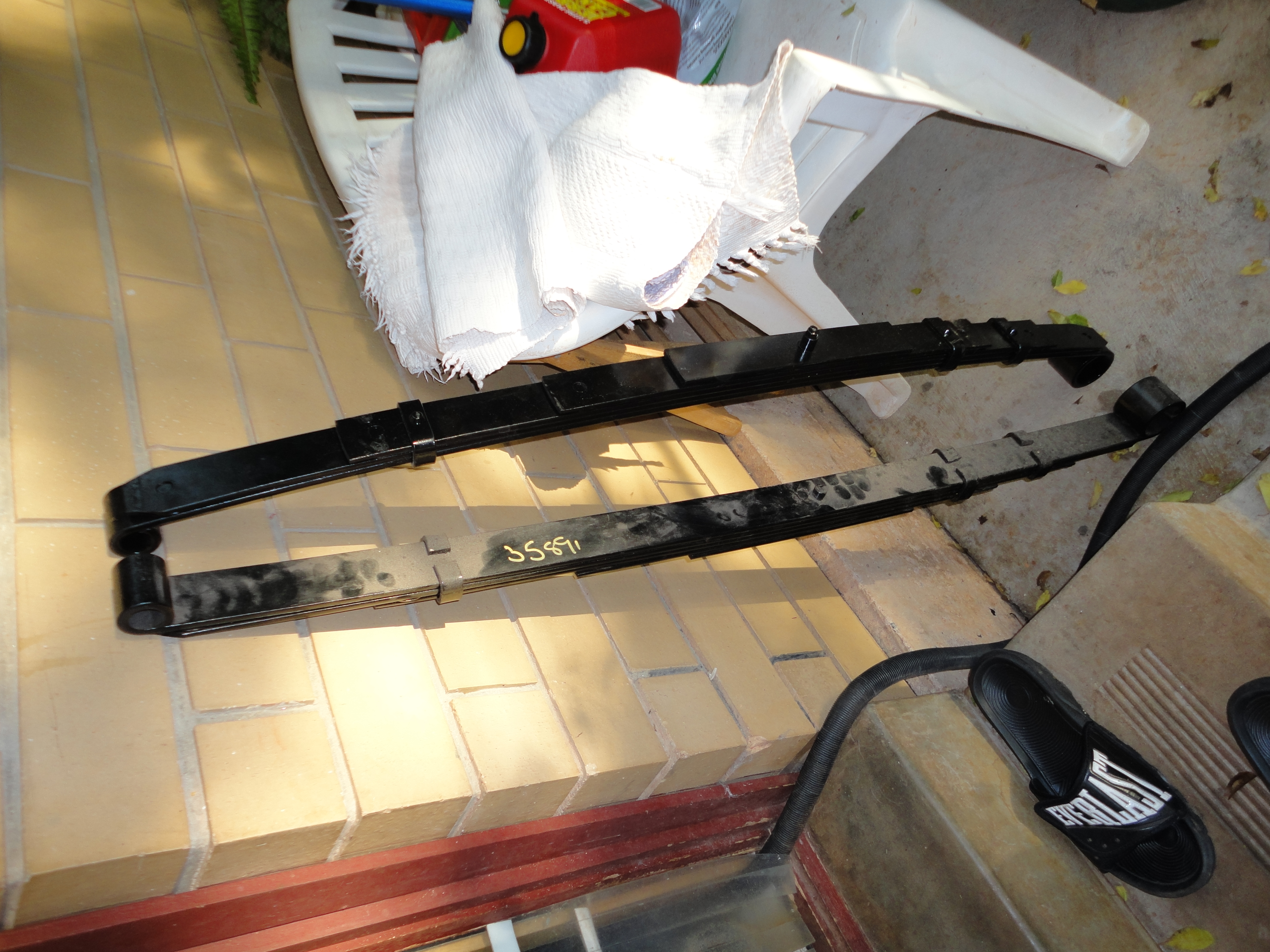

-=KE30=- Posted June 13, 2010 Author Report Posted June 13, 2010 Not much has been happening latly..just been doing bits and pieces on the paint/rust. I did however get these from Mr SLO 030 :y: Random photo lol Cheers :P Quote

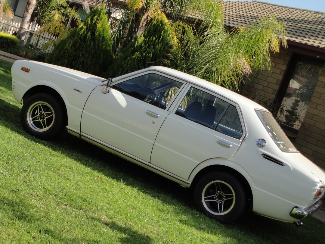

-=KE30=- Posted January 17, 2011 Author Report Posted January 17, 2011 Been so long since I updated so as it stands at the moment it has new Goss fuel pump King springs lowered Monroe GT gas shocks (fronts) new Front end bush kit Brand new stock carb the front calipers had a seal kit put through them and cleaned new front pads new brake lines new brake rotors new headlights with a semi sealed beam and just some h4 globes, within the next week i will be rebuilding the headlight loom with relays etc to make them brighter and lastly new crome number plate lights I think thats it for the moment. In a few weeks i will start sanding it and hopfully respray it Cheers Josh Quote
JJT036 Posted January 17, 2011 Report Posted January 17, 2011 Venetians and SLAM! :yes: Looks good mate. :y: Josh :cool: Quote
bmxsexmonkey Posted January 17, 2011 Report Posted January 17, 2011 I like what you have done, nice clean and simple. I applaud your efforts in rebuilding that carby. I had twin aisan carby's and the rebuild kits. I said "f@$k that" after looking at the diagram and sold them haha Quote
jaygore Posted January 17, 2011 Report Posted January 17, 2011 On 1/17/2011 at 9:19 PM, ewt said: Venetians and SLAM! :yes: Looks good mate. :y: Josh :cool: hell yea totally agree here... Mine is getting picke up today after being slammed =] and I have venetions, they really do set it off nicely Also I am loving those wheels!! Quote
ijg033 Posted January 18, 2011 Report Posted January 18, 2011 Nice clean looking 30 , wheels suit , Cheers Dave Quote
