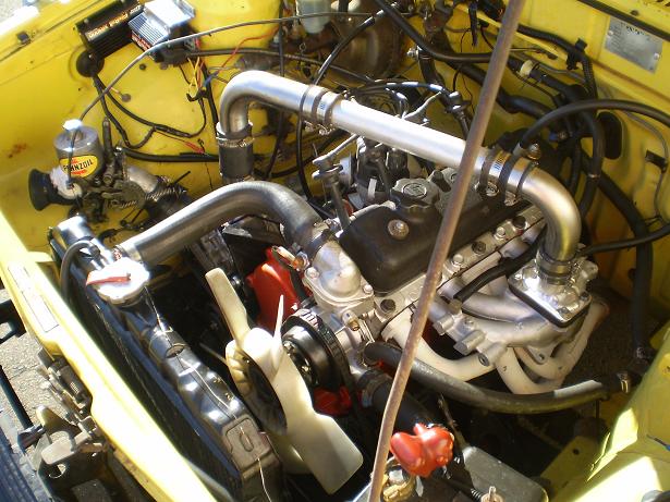

charged kid Posted August 3, 2009 Report Posted August 3, 2009 how bout a charged on you engine :hmm: this my car.I rebuilt it by my self. Quote

**chumps** Posted August 3, 2009 Report Posted August 3, 2009 (edited) does that cooler setup work? i wouldnt think so because i thort all the fuel would flud at the bottom of the intercooler.thinkin of doing the same for mine if it does work. draugh through supercharges are faily good and cheap to setup. Mine makes around 70kw but my old one made 110kw in the pic below i am useing a amr300 witch is off a little front wheel drive. i think it would work great on a 3k :hmm: Edited August 5, 2009 by **chumps** Quote
Taz_Rx Posted August 3, 2009 Report Posted August 3, 2009 **chumps** said: does that cooler setup work?i wouldnt think so because i thort all the fuel would flud at the bottom of the intercooler.thinkin of doing the same for mine if it does work. It would work chumps, no doubt about that.......... Its just a ticking time bomb though!!!!! charged kid - remove the intercoller IMMEDIATELY!!!!!!! ....did I make that attention grabbing enough!? Why (again :hmm:) - Because you're running a draw-through setup you're currently pumping your intercooler fuel of a perfectly mixed combination of fuel and air...... ready for combustion. If you happen to have a back fire, it will travel up the inlet manifold and cross over pipe and into the intercooler.... then bad things happen...... Or you might just 'blow the welds on your intake'. :) Quote
charged kid Posted August 4, 2009 Report Posted August 4, 2009 .....but i use this setup with this intercooler few month aready.and withoult it will over heat. few track event i go for testing this setup....so far no problem......... Quote
Taz_Rx Posted August 4, 2009 Report Posted August 4, 2009 No it won't overheat. You might need to need pull a little bit of timing out, but not heaps. Do you even have a bonnet scoop over the cooler? cause if not its not doing anything anyway!! Look that's how it is, do you want to run the risk of doing some serious damage in your engine bay!? Its only matter of tiome before somethig goes wrong....... but hey, what would I know! :hmm: Quote
charged kid Posted August 4, 2009 Report Posted August 4, 2009 :hmm: .............before the intercooler it a straight piping.and really over heat every track day what ever i retard or advance the timing.after 2 round in track sure over heat.after this intercooler fix in no more heat problem.and can burn out 5 to 8 minutes no problem. Quote
