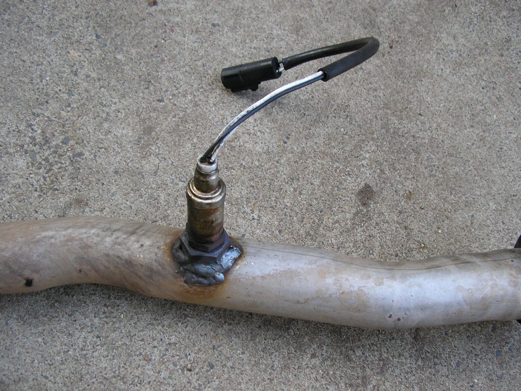

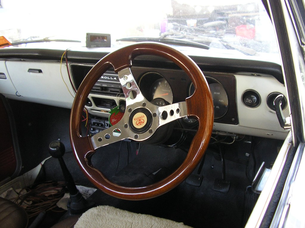

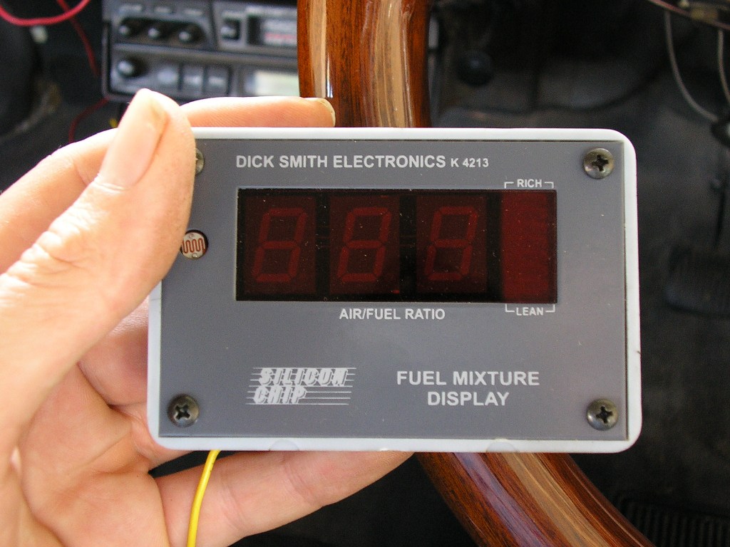

Felix Posted July 14, 2009 Report Posted July 14, 2009 I just had a look at a couple of stock carbs. Unfortunately there is no way to crack open the secondary throats. You would really need to drill holes in the butterflys to be able to get the full effect from the idle circuit in them. Attached is a few old pics of my Digital A/F ratio meter and O2 sensor. Quote
