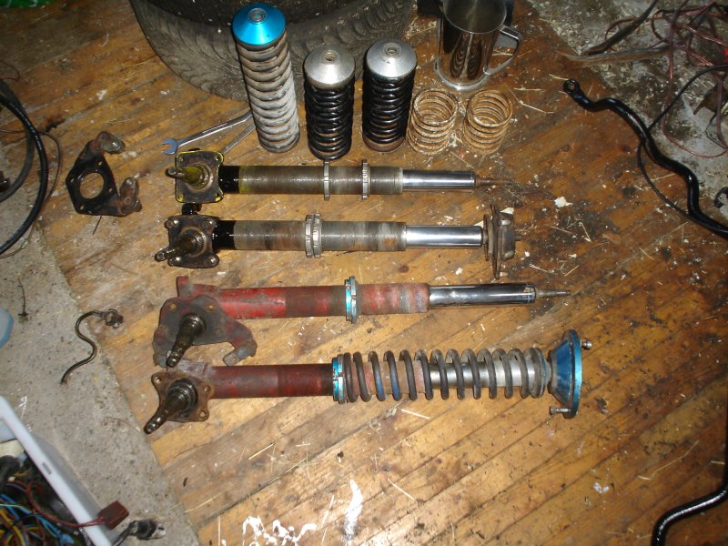

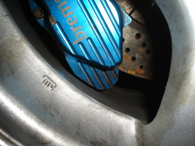

David[RL] Posted September 2, 2005 Author Report Posted September 2, 2005 I just got rid of the axle tramp 100% now!!:bash: 1. gear dounuts into 2. dounuts until you stand still and it's smoke everywhere :D I did lowered the rear of the car yesterday: I did buy special tools for adjusting the coilovers today, and started.. lowered a few cm then it began to be hard.. bad threads.. so I will swap for the tarmac suspension, with lower springs and shorter stroke on the shocks.. then I found out why my steering wheel was vibrating between 90 and 110km/h.. really really noisy wheel bearing.. I didn't hear it when I drove because my exhaust is so loud :D so I guess I will park the car for a while, removing rust, a new paint job, buy new discs, pads, and wheel bearings, etc.. then I will make some new mounts for the caliper, because I want more clearance to the rims so I can remove the spacers to get the wheel inside the wheelhouse :D some pictures of the brake clearance problem: as you can see, I can move the caliper about 5mm back.. and maybe even fit wider discs.. ( mine is now 25,4mm wide ) I also have some pictures when I changed the clutch on monday and tuesday this week: as you can see, I managed to break one of the bolts on the flywheel :blinks: luckely I managed to remove it by welding another bolt to it :angrybird: the old and new clutch. still waiting for the trd 212mm clutch and pressure plate.. very nice tool for centering the clutch:D ( wrong spelled, I know.. ) I also did buy some blue samco vacuum hoses, looks nice :D, but I haven't got a picture of them yet.. Quote

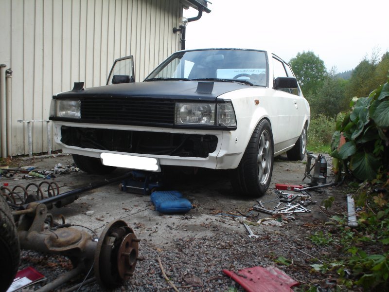

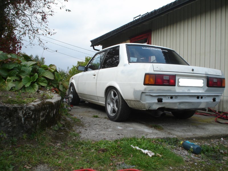

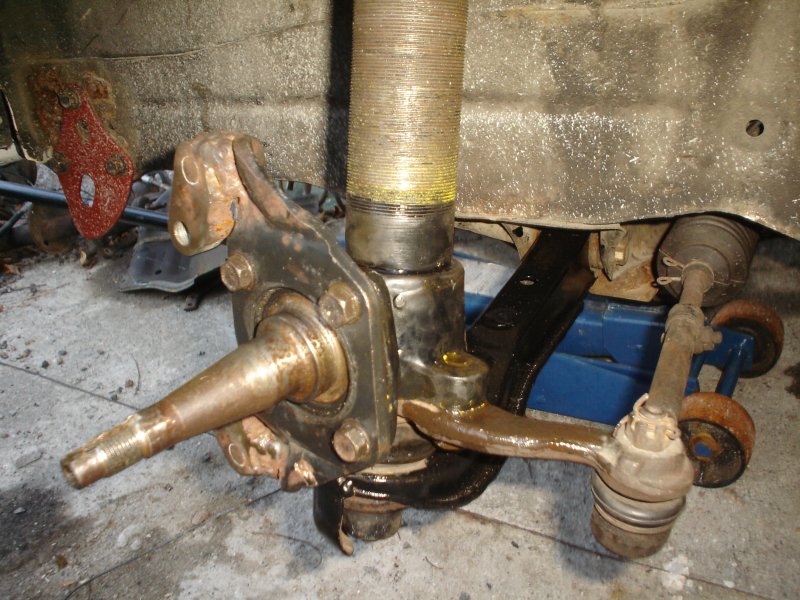

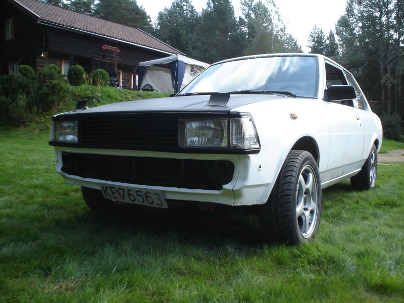

David[RL] Posted September 23, 2005 Author Report Posted September 23, 2005 today I finally got the suspension done since my wheel bearings was f@$ked I decided to changed from gravel struts to tarmac struts, with bilstein shocks "400.220"? I guess that's bound/rebound? springs are stiffer than the gravel springs too.. maybe a bit too stiff for road use, but who cares? :( lowered, from: to: now I really need some flares.. can't get my finger between the wheel and fender.. I'm 99% sure I'm going for this look: TA64 WRC Picture pics of the conversion: got better clearance from caliper to the wheel because of the new mounts, now I don't need the spacers anymore :D ( I had 10mm on each side before ) Quote

David[RL] Posted September 25, 2005 Author Report Posted September 25, 2005 what struts are they? I'm not sure, but the red ones is the gravel struts, they look like ae86 struts I guess but the black ones that I use now I'm not sure, since they has different location for the caliper mounts.. maybe someone else know? Quote
