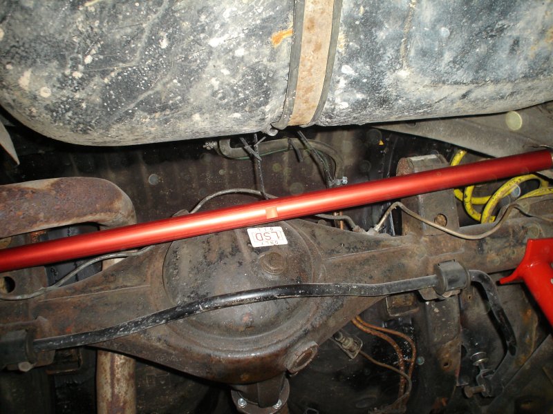

also got a adjustable panhard rod from technotoy,
I think he makes his parts for show, not hardcore-use

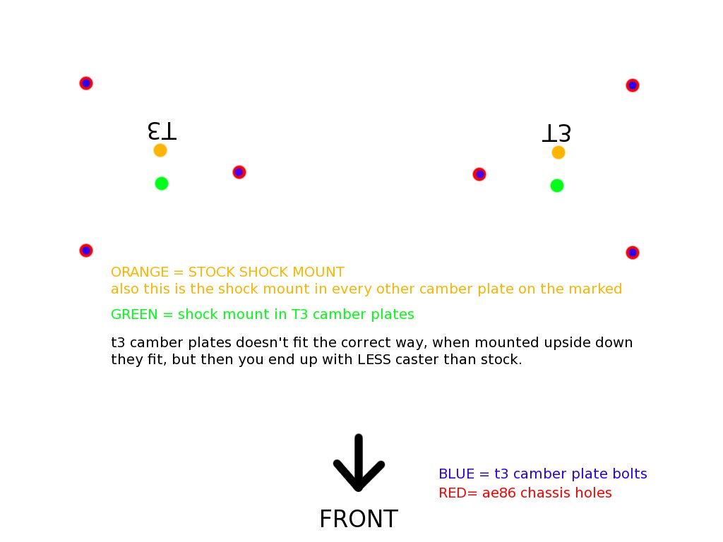

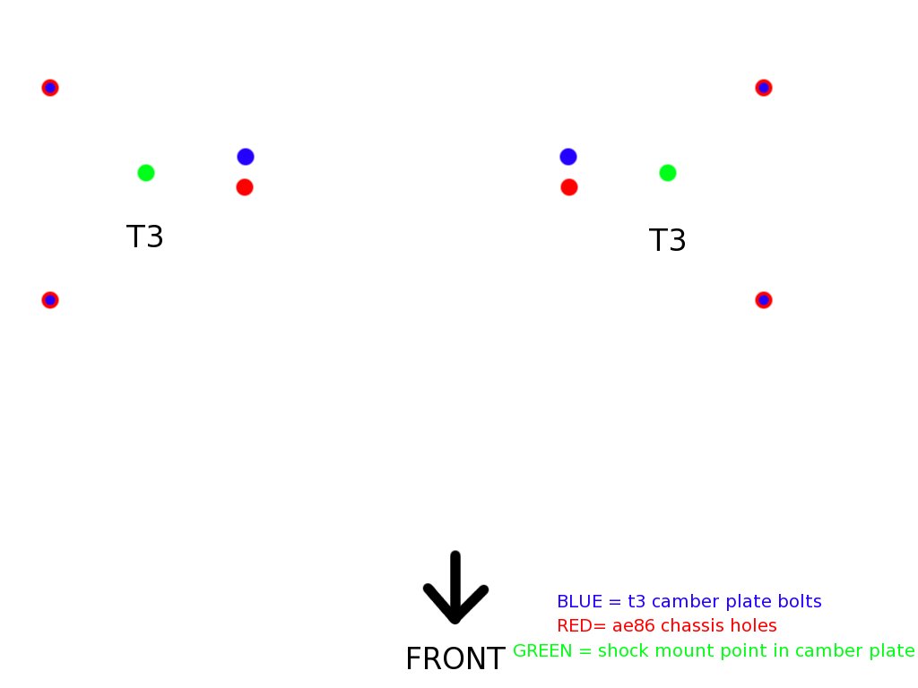

I'm telling you and the other here because t3 wouldn't fix the problem
I don't have a AE71, the strut tops is the same, but originally they fit both ways
because some missalignment when t3 made up their camberplates they only fit 1 way.. and that's the wrong way
my cusco units is stamped LEFT and RIGHT.. and I mounted the left camberplate on the left side in the ke70
and that align PERFECT!, just like the origininal genuine toyota part
yes T3 makes camber plates for ke70 too.. but that's only for 79-81 ke70, not 82+
so if you are so smart to know this "old trick", you also know 1982 ke70 strut top is the same as ae86
t3-gabe is talking about the problem is that there is a different strut top for powersteering and non-powersteering.. thats bullshit
he is telling the AE86 strut tops has less caster because he wanted to give the ae86 people more CLEARANCE to the wheels
and WHY do you protect him.. ahh now I know..
I'm not defending T3 if they're not willing to swap the product to a KE70 part, so don't make assumptions :D I'm trying to work out for everyones benefit what's going on here.

ke70 has 2 different types of genuine toyota shock mount
ae86 has 1 type
the clearance problem t3 described was clearance behind the wheel, but that's just bullshit
the caster rods is adjustable, and that's the best thing to adjust if you don't have clearance, simply add some more caster and there is no problem..
if t3 didn't make them wrong by mistake.. why is the text-logo that says T3 upside down??
and another thing.. ke70 82-84 and ae86 stock strut mounts bolt up each way
if you mount the left side unit on the right side of the car you end up with less caster
but the bolts on the t3 unit doesn't line up at the same point as the stock toyota parts.. which removes the possibility to mount them both ways
the distance between the bolts are wrong
and to ironkin: yes I know.. I bought the one that's FIA approved for group A. which has stock caster
I don't know why anyone wants reduced caster..? it's not like it has very much stock..
