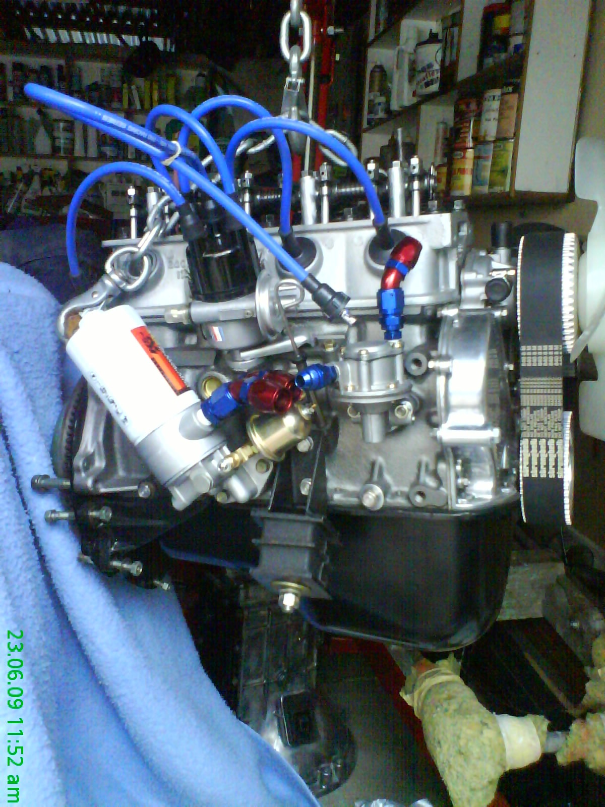

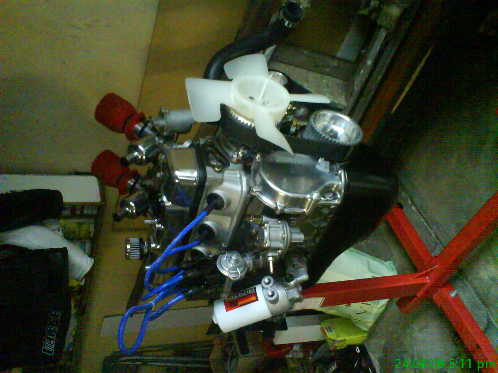

harun Posted June 23, 2009 Report Posted June 23, 2009 (edited) And here is a picture of my kit on a NA' 3K. Taz, hopefully will be on the road by the end of the year. Preparing the KE20 shell for some fresh paint at the moment. I also could not resist spending some big bucks on some speedflow fittings & braided lines. Edited June 23, 2009 by harun Quote
philbey Posted June 23, 2009 Report Posted June 23, 2009 The reason they will chew bearings is because the longer pulley will increase the "leverage" on the pump and alternator shafts. It's not difficult to work it out. The actual belt itself will have a specific tension value which you should try to use. Toothed belt drives are good because they can transmit much higher power without slipping, and they consume a lot less energy to do so. Quote
Taz_Rx Posted June 23, 2009 Report Posted June 23, 2009 Looking mighty nice harun! :bash: How long now until she's on the road? Quote
harun Posted June 23, 2009 Report Posted June 23, 2009 Taz_Rx said: Looking mighty nice harun! :bash: How long now until she's on the road? Updated previous post.... Quote
Taz_Rx Posted June 23, 2009 Report Posted June 23, 2009 harun said: Updated previous post.... Are they -8 fuel lines? -6 would have been plenty big enough, thats all I'm running. No big drama, just you would have spent a little bit more on the bigger fittings. Only -8 I used was for the turbo oil drain and I'm also about to finish off the oil cooler lines in -8. Defenitely looking the goods though mate. :bash: Quote
harun Posted June 23, 2009 Report Posted June 23, 2009 Taz_Rx said: Are they -8 fuel lines? -6 would have been plenty big enough, thats all I'm running. No big drama, just you would have spent a little bit more on the bigger fittings. Only -8 I used was for the turbo oil drain and I'm also about to finish off the oil cooler lines in -8. Defenitely looking the goods though mate. :bash: They are -8 fuel lines... And -10 for oil cooler lines... Quote
GTS-T_Sedan Posted June 23, 2009 Author Report Posted June 23, 2009 Taz_Rx said: Myself, harun and WinKE55 for the only 3 aussies who bought kits in the endevour group buy last year. WinKE55 did have his for sale a few weeks ago. Its cross out in the for sale thread but I don't know if it sold or not. For AUD$350 you'd be stupid not to send him a message and find out if he's still got it..... http://www.rollaclub.com/board/?showtopic=30781 Because they are a toothed belt you can run bugger all tension. They still make plenty of noise, just not as much as if you over tension them, which as said will just chew out your water pump and alternator bearings. Also here's a vid of my kit.... called WinKE55 - its sold so now for $530aud would this be worth buying straight from company? harun said: And here is a picture of my kit on a NA' 3K.Taz, hopefully will be on the road by the end of the year. Preparing the KE20 shell for some fresh paint at the moment. I also could not resist spending some big bucks on some speedflow fittings & braided lines. Looks tuff as mate what have you done to it? any internal or head work? Quote
