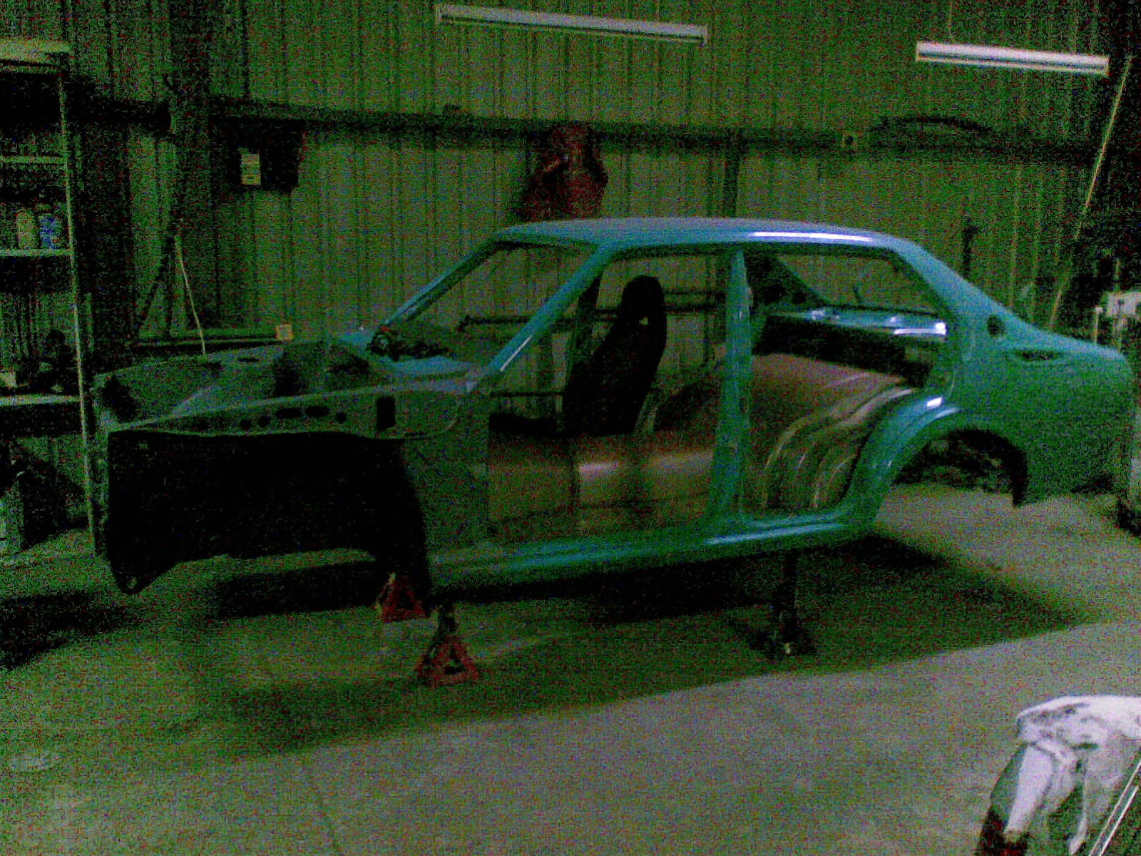

1JZKe55 Posted January 7, 2010 Author Report Posted January 7, 2010 question... when you cut out the floor did the car not wanna twist or anything??so after all this the chassis is still straight as? Na it wasn't to bad i tacked a couple braces in to help hold it all in place when we were cutting everything out The chassis is made out of 75x50x2.5mm so yeah its still straight lol gave myself a tolerance of + - 1.5mm to work with in Quote

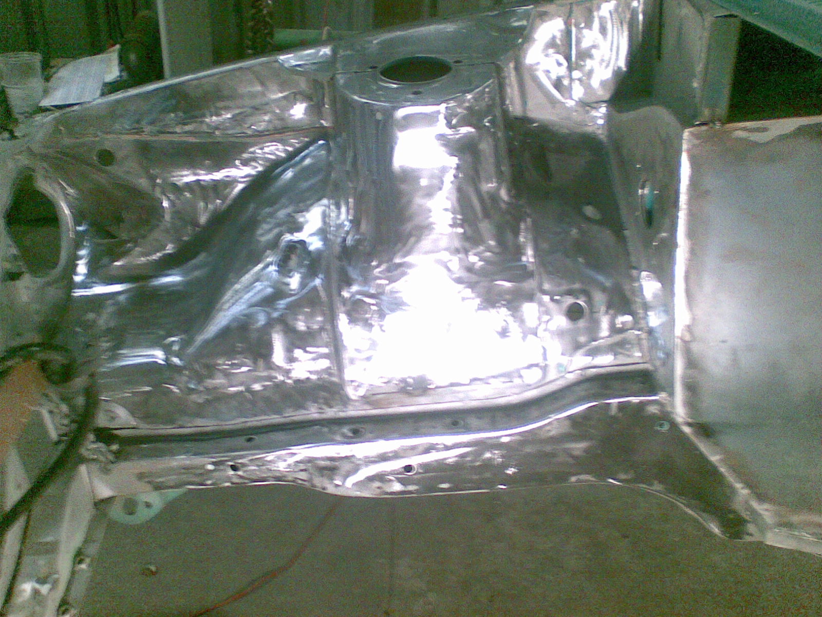

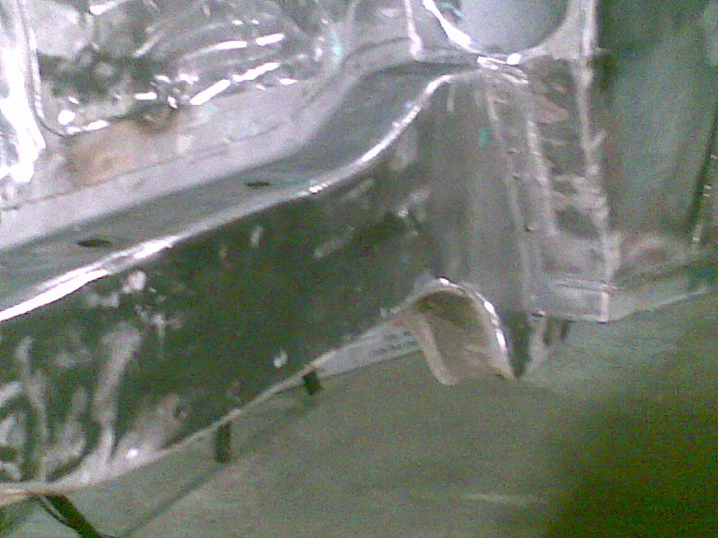

1JZKe55 Posted January 17, 2010 Author Report Posted January 17, 2010 its been long day's stripping it back to bare metal Quote

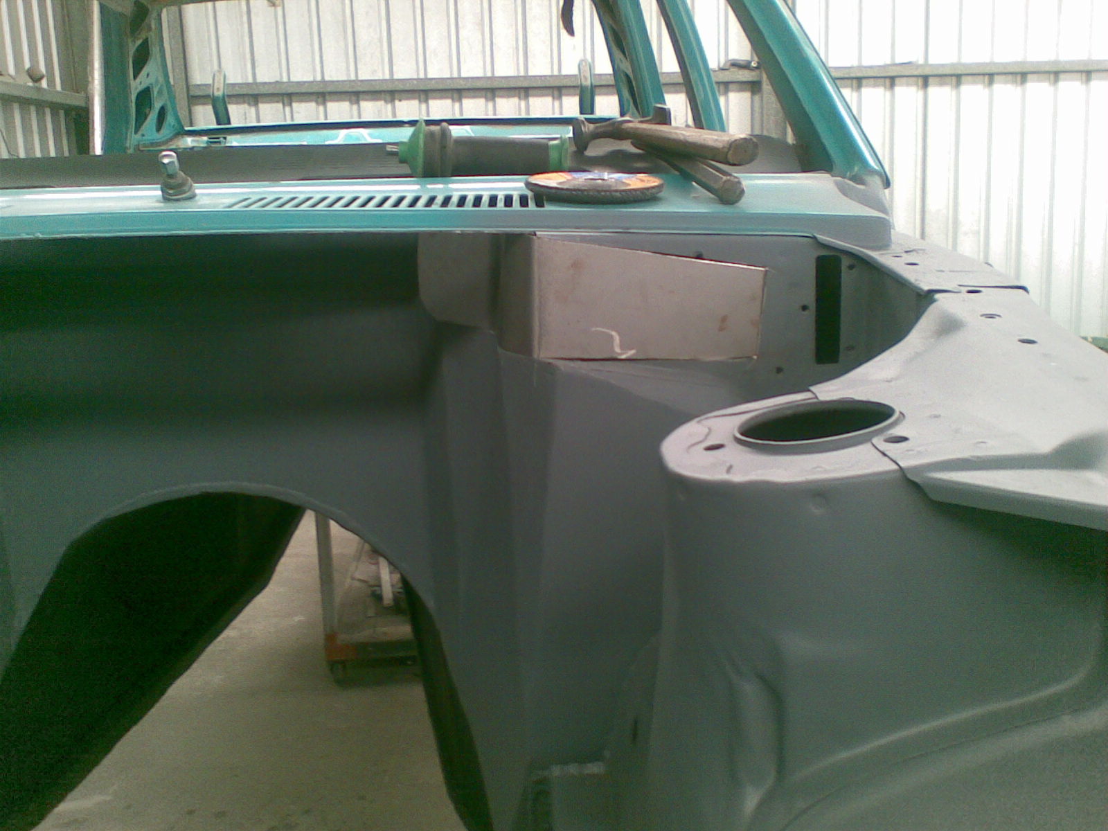

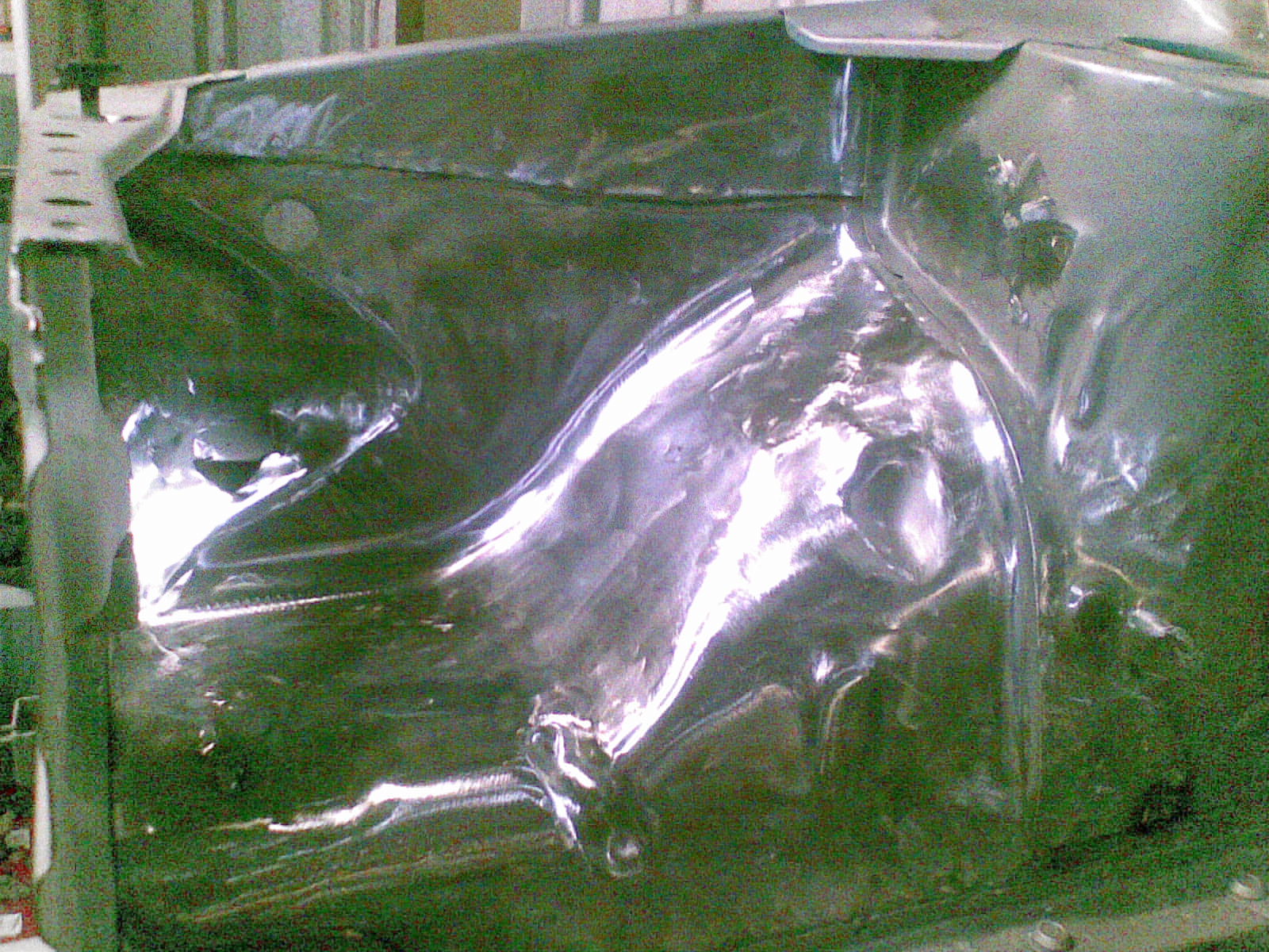

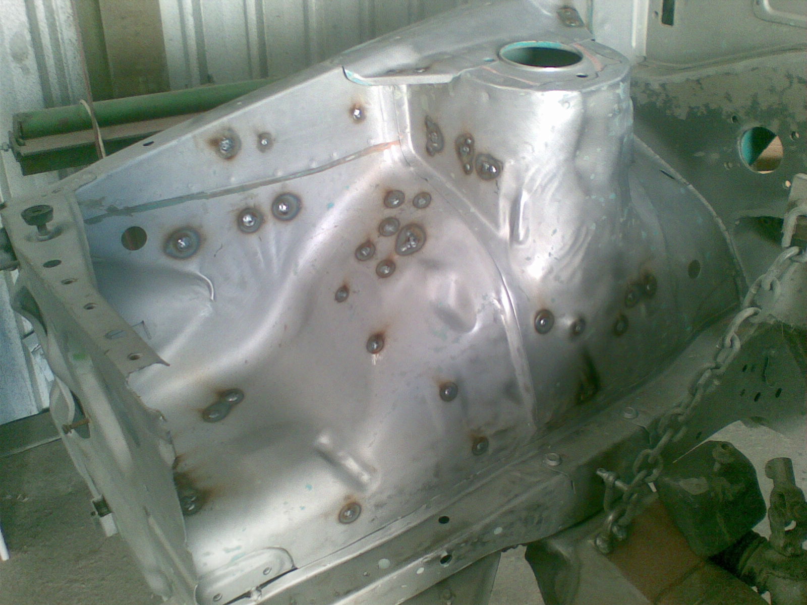

1JZKe55 Posted January 18, 2010 Author Report Posted January 18, 2010 Thanks guys yeah you need a big hole for a big motor lol smoothed out the engine bay and rails it was like swiss cheese :D Quote
67Rolla-Ken Posted January 18, 2010 Report Posted January 18, 2010 Reminds me of the skin cancer adds they're running at the moment.... just 30min in the sun :D Quote

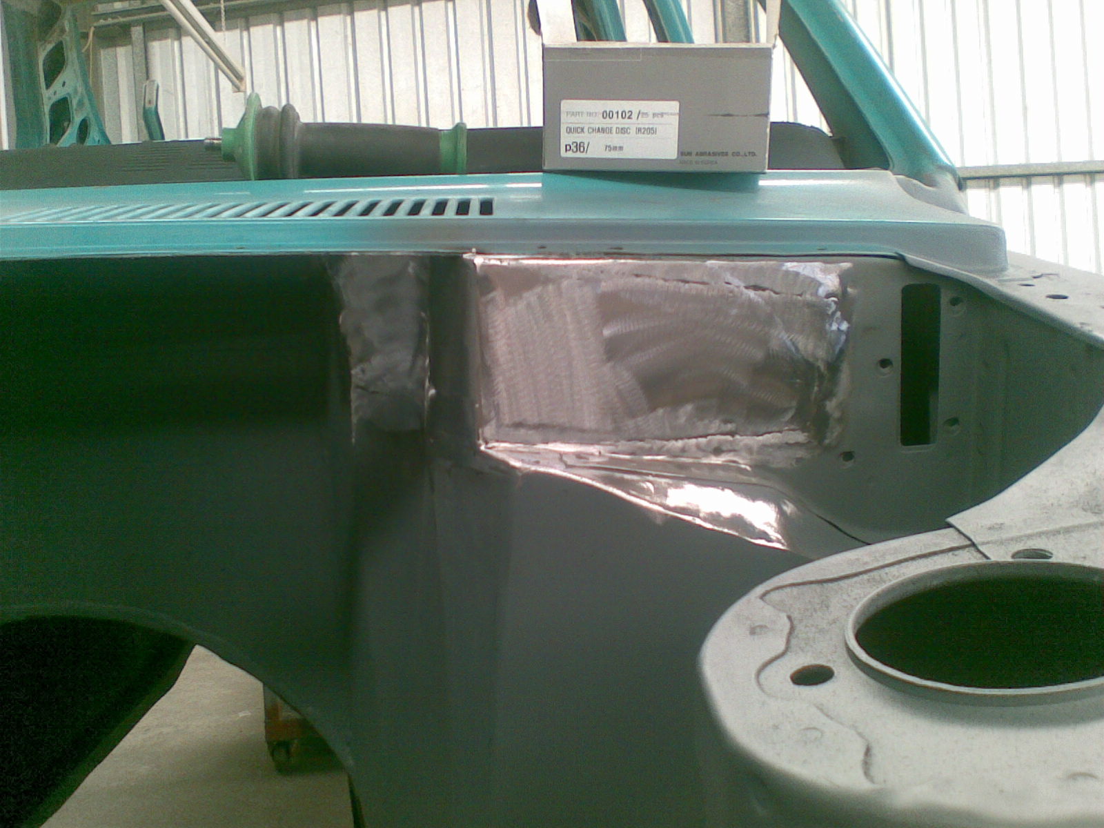

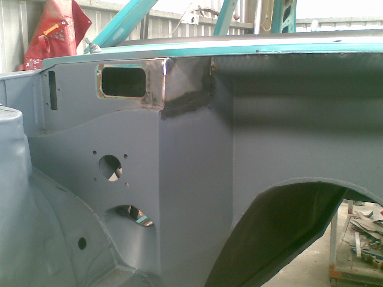

1JZKe55 Posted January 24, 2010 Author Report Posted January 24, 2010 (edited) finished making the last couple bits for the firewall and removed the wiper motor today :dance: Edited January 24, 2010 by 1JZKe55 Quote
67Rolla-Ken Posted January 24, 2010 Report Posted January 24, 2010 Damn that new trans tunnel is friggin huge!! Quote
1JZKe55 Posted January 24, 2010 Author Report Posted January 24, 2010 lol yeah you don't get much bigger It had to be that big to get the motor level in the car :dance: just waiting for parts to turn up got a 4core aluminum radiator 600x400x70 intercooler 600x400x76mm and oil cooler coming in the next 2weeks :y: Quote
Doogs Posted January 29, 2010 Report Posted January 29, 2010 Looking good. The trans tunnel and bay are neat. :) Quote
