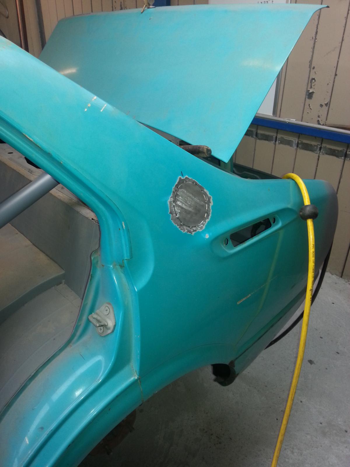

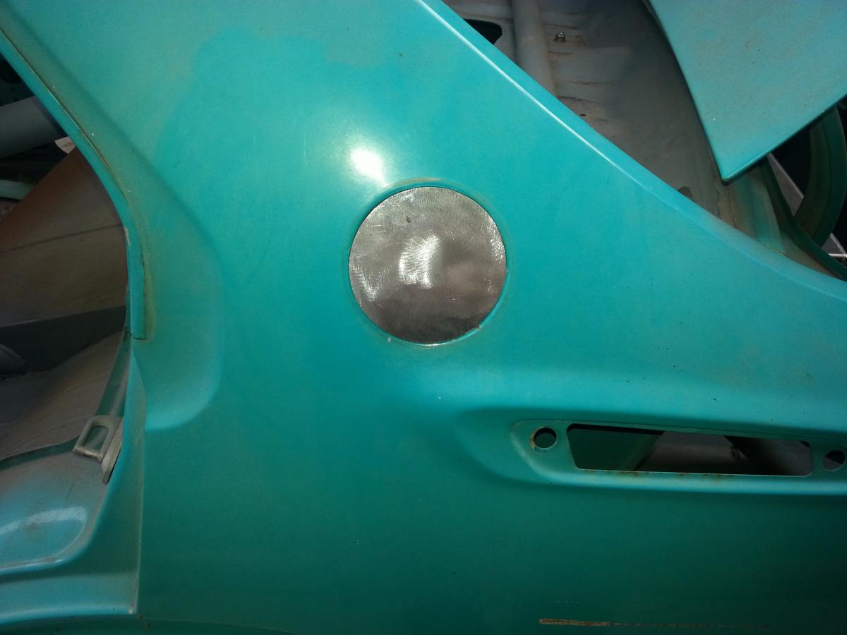

Thanks mate I spent a few more hours welding up the quarter panel and fixed the last spot of rust in bottom of the panel now just a little bit of shrinking to go then it will be ready for some primer :yes:

The rear quarter are just about done
