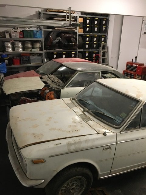

So finally I’m underway. After years of waiting I finally have some space and don’t have to jam cars down the side of the shed.
E8FF8F20-43CB-469E-9DD1-7A1B5EC1AF5E.jpeg.95da7cc74fb61d03fe6c01777b265438.jpeg.9e81a356f917328175c6b8e023aae5d8.jpeg
The KE15 is as I got it other than taking the tow bar off which got sent to Harry. and some series 1 RX7 wheels that actually really suit it (and hold air!)  I also replaced the seats with a perfect set with headrests I got from Japan.  The old ones going to Klayton only needed some small repairs, but I wanted headrests and ended up changing over at modest cost.  Otherwise it has sat quietly under cover waiting for some love.

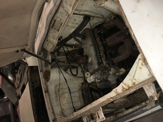

Adam had some engines issues in that it started blowing a lot of smoke and struggling under power after running for a few minutes.  I’m convinced it has a cracked piston. A quick compression check was even across 1, 2 and 4, but cylinder 3 has nothing. So work started on the weekend with pulling the engine. I’ll whip it out next weekend having disconnected everything yesterday.  Planning to stroke it with a 3K crank.  I went back to Adam’s original thread to see if he had comp tested it, and realised I bought the car 9 yrs ago!  A bit longer than planned.

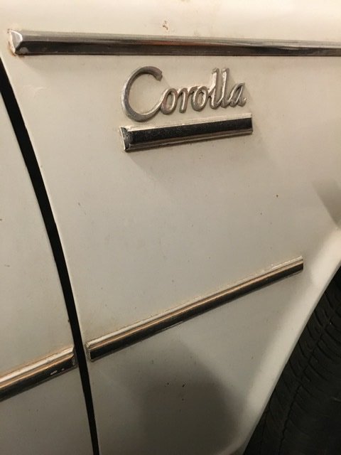

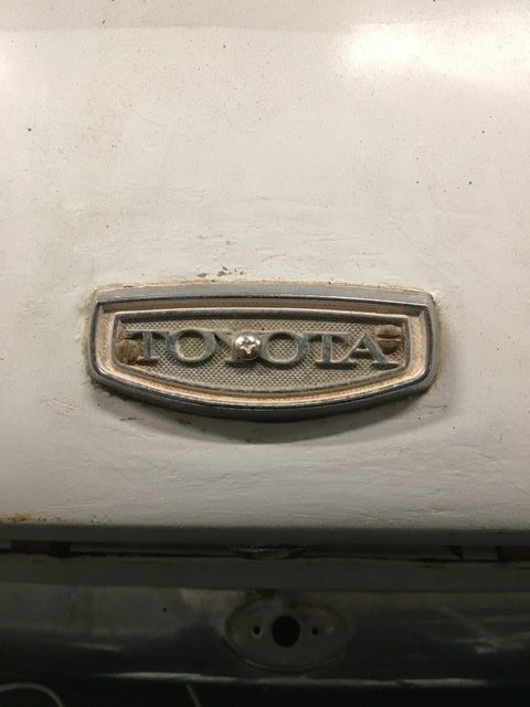

Would of loved to meet the original owner. Went to extremes of screwing self tappers through the boot badges, and added extra bump strips down the flanks and under the guard badges.

The body will need a bit of work but is extremely solid And issues are mainly cosmetic though there are a few areas of house paint doubtless hiding things. The bonnet will need a bit of work. Anyway, kids are old enough to amuse themselves, so plenty of time to work through all the spares I’ve built up

Another thing he did was carefully drill a little hole near the end of each chrome strip at the rear quarter.  I remember Adam saying he was a keen sailor, and I wondered if he might have set up a tarp off the back of the car, secured with fishing line. No self tapper this time

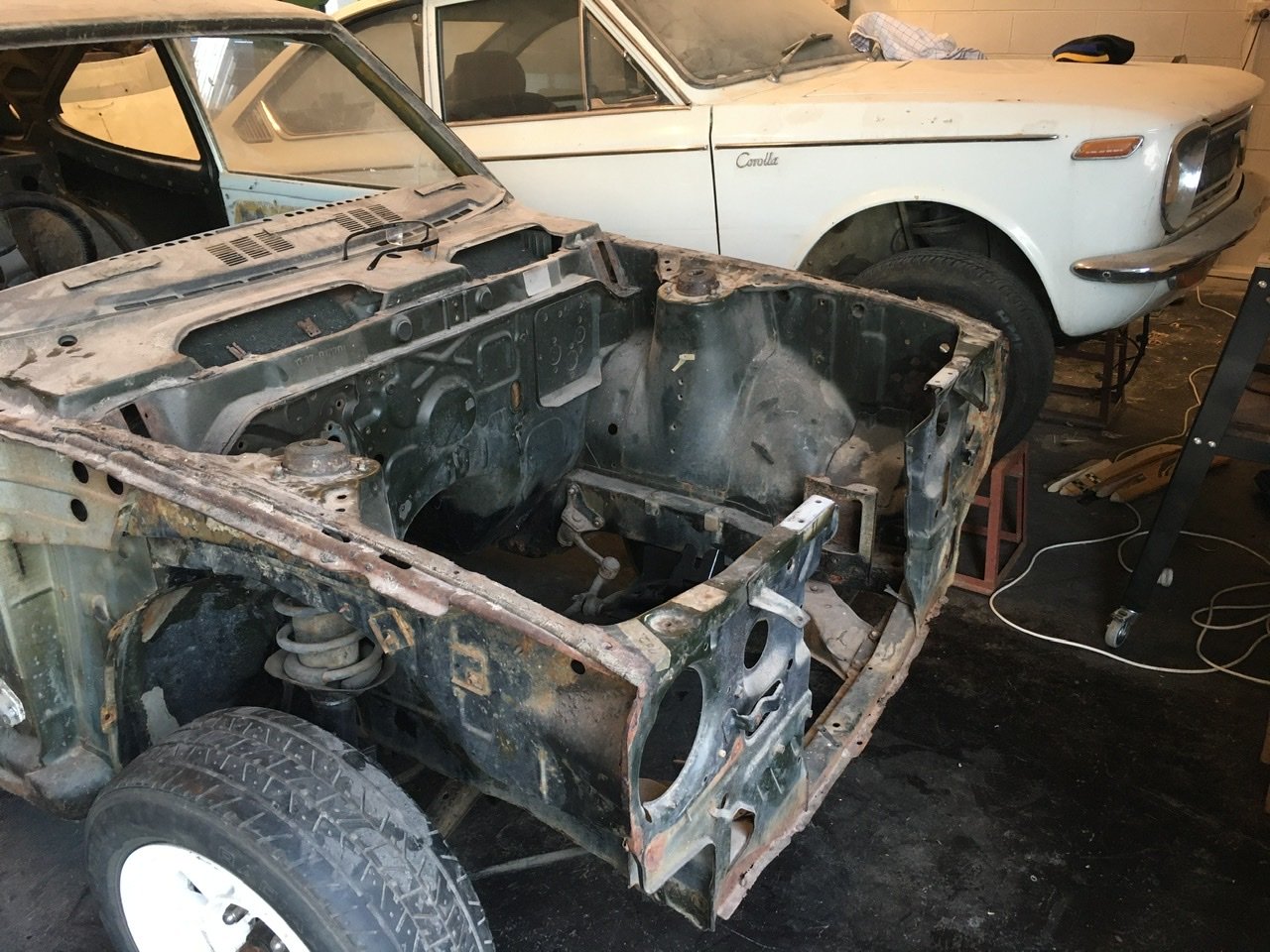

It’s been a while, but finally the TE27 is back on its wheels with the TE27 crossmember and TE27 struts. It had been sitting on a KE25 front end I borrowed from Dave since collecting the shell quite some time ago. So long ago he doesn’t want them back!  At this stage just for rolling about the garage and will need to come out for some welding.

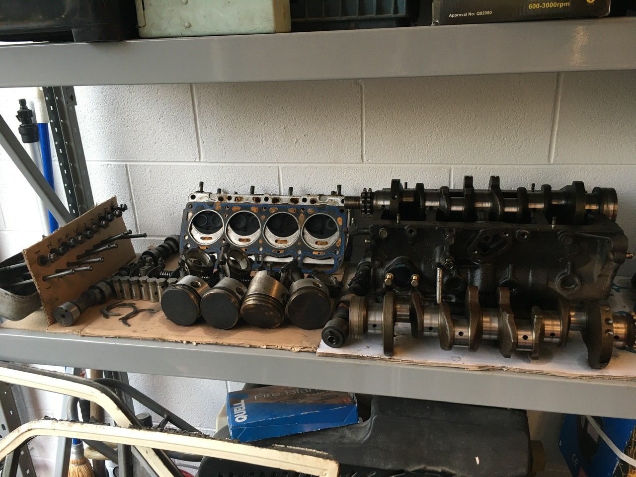

Now shutdown has eased off, I’ll get the K engine down to the machinists. Have a 3K crank I got out of a 99 cent engine for it so I can keep the original block, plus a Nicely worked head I picked up from a mate a while back.

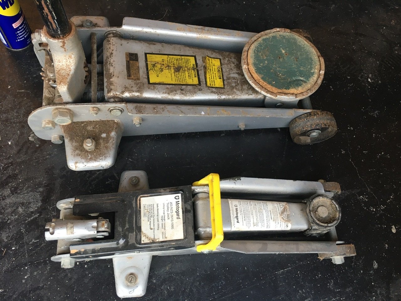

Latest addition to the shed I couldn’t do without is a proper floor jack I picked up at the local auction place for $80. Makes things so much easier. No effort required, lifts nice and high without buggering about. Wish I had this years ago.  Old faithful motor guard cheapy jack is pretty piss poor in comparison.

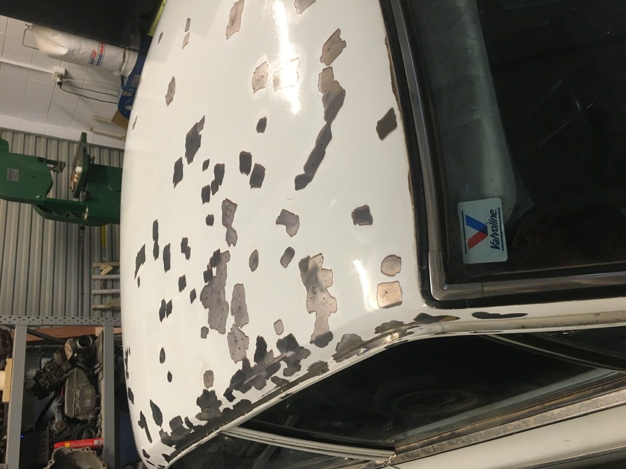

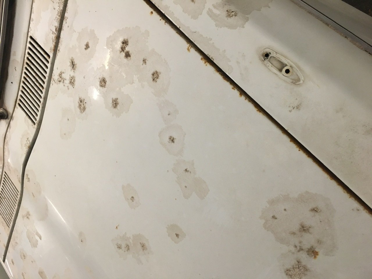

Amongst all this I have managed to get to work on the spot rust on the KE15. Elected to go carefully with a polystrip disc which effectively takes off the paint and virtually all the rust below without too much heat to distort the panel. Happily no evidence of panel perforation, so the years of careful storage without putting a tarp over it have saved it. Then treated what minimal rust remains with KBS rust blast which also etches the bare metal. The bonnet shows basically what the roof looked like beforehand. There’s a great old school paint shop, Milsome’s in Ferntree Gully who were able to put some factory colour, including for the TE27 into an aerosol, so shall see how that goes as an interim measure.

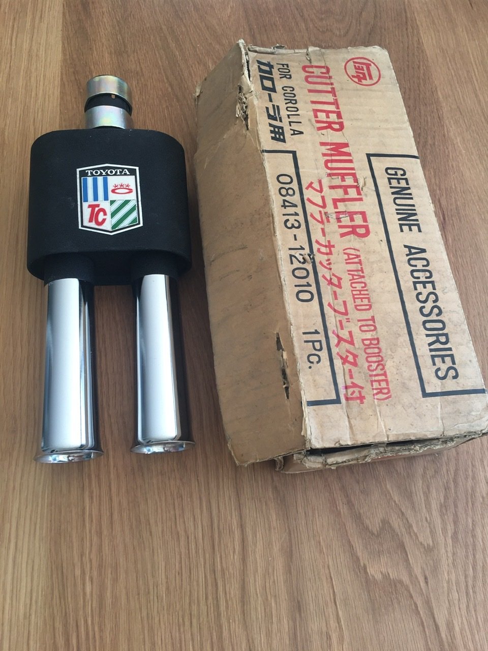

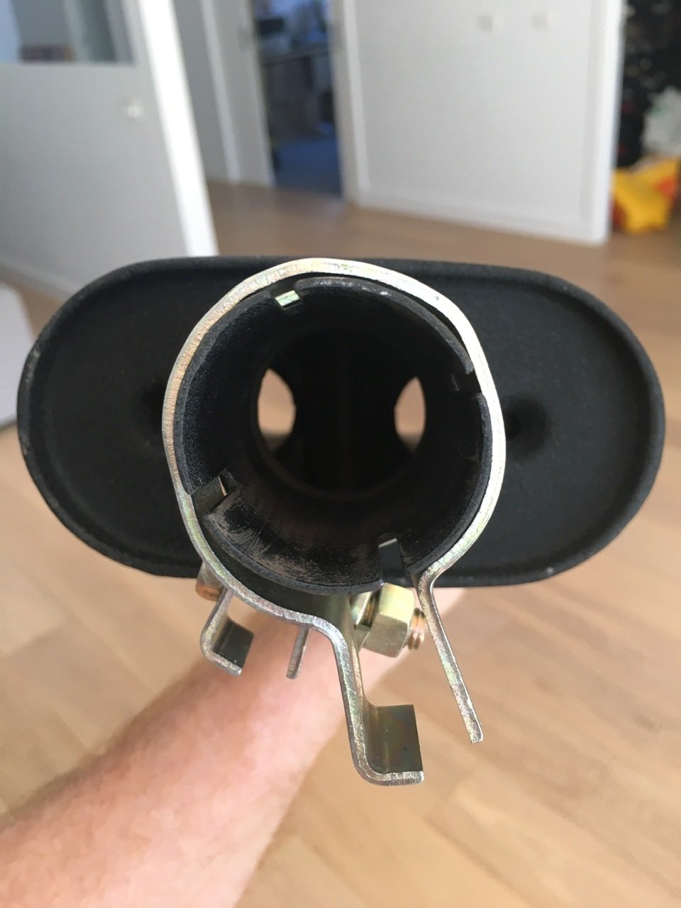

Finally treated it to a xmas present with a NOS factory option twin outlet exhaust contraption. The box is straight thru, and the whole unit bolts on after the muffler.
