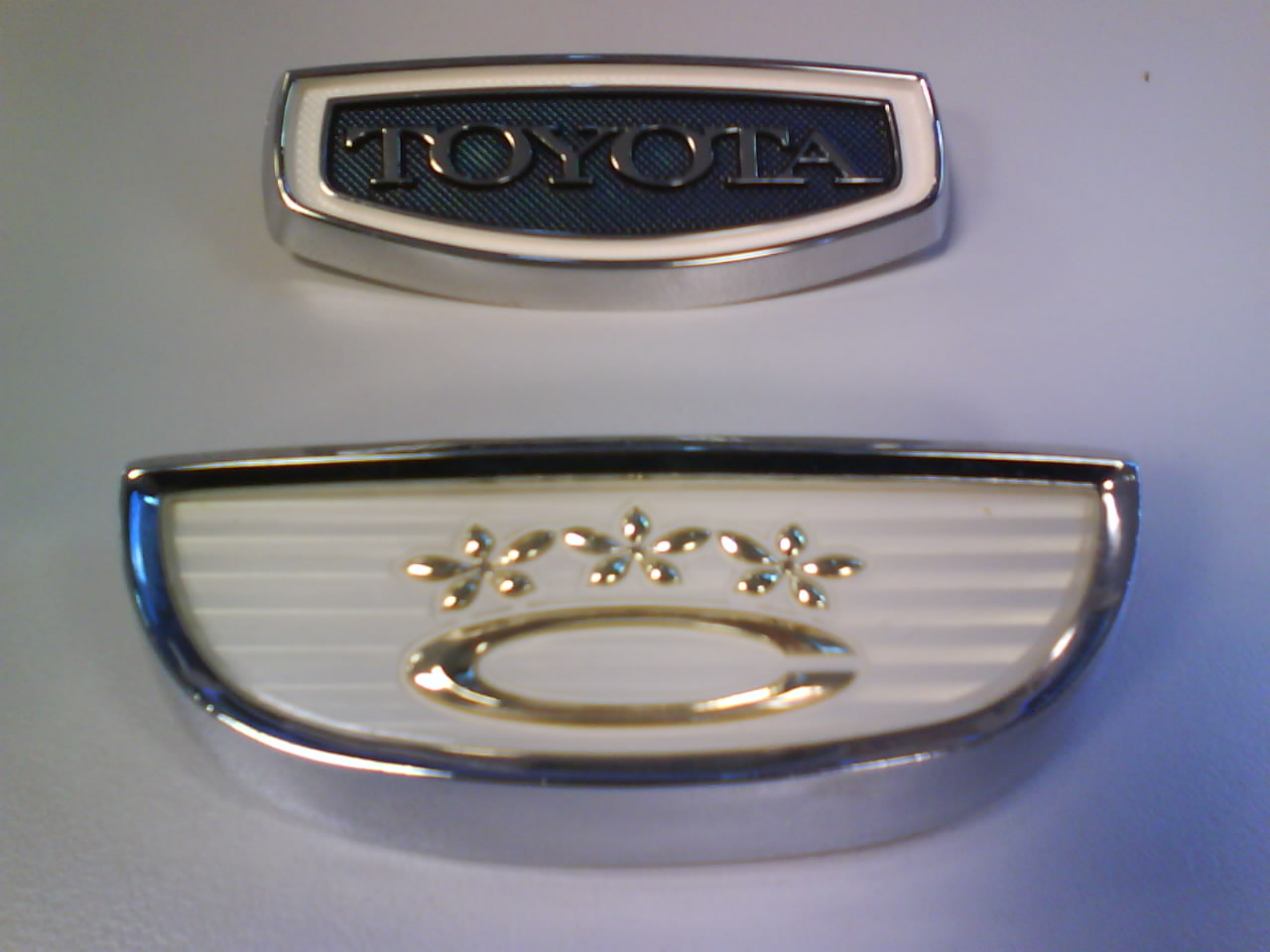

Tally Posted August 18, 2010 Report Posted August 18, 2010 parrot said: On the parts front, have picked up a NOS genuine Levin badge for the boot on the TE27, a NOS grille with brand new badge also for the TE27, plus at long last, the elusive interior roof panel for the factory sunroof on the AE86, plus a clock surround. I chucked out my warped sunroof panel about 15 years ago thinking I would just get another from somewhere..... OMG I so thought it was you that bought that NOS KE25 grill of ebay!!!! You out bid me by $2.50 lol!!! ahh well hehehe good that it went to a fellow rollaclub member though :D Quote
parrot Posted August 18, 2010 Author Report Posted August 18, 2010 Ha! Sorry Tally. Was a bit early in the morning for me too, but I wasn't missing it. Wife was wondering why I was sleeping on the couch. Didn't want her waking on the alarm and coming down as I hit the bid button! Only so much she needs to know, which explains why I have a post office box..... Quote
