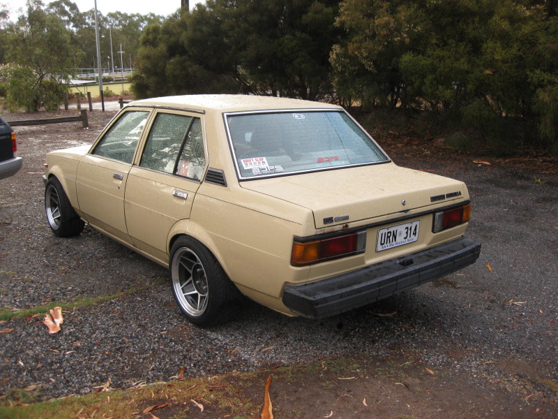

KE70's are cool Posted June 22, 2009 Report Posted June 22, 2009 (edited) Hey mate this is my 15x8 -9 challengers on my ke70, the tyres are 195/50/15 (not this side is bashed in a bit, you will need to roll the lip in.) Edited June 22, 2009 by KE70's are cool Quote
LukeAE71 Posted June 22, 2009 Report Posted June 22, 2009 Hope Ben doesn't mind... They fit fine and as far as I know these are standard guards so with a bit of a roll etc they will be fine. Also, these can be had from any tyre shop these rims so there is no reason to buy them from that place :bash: Shop around you should be able to get them for about $200 a rim plus tyres. Quote

benzo Posted June 24, 2009 Report Posted June 24, 2009 LukeAE71 said: Hope Ben doesn't mind... They fit fine and as far as I know these are standard guards so with a bit of a roll etc they will be fine. Also, these can be had from any tyre shop these rims so there is no reason to buy them from that place :) Shop around you should be able to get them for about $200 a rim plus tyres. yeah thats my old car when it had 15x8 -9 challengers on with 195/50. Guards were only rolled, fronts were pulled out a fair bit and had to cut front guards to clear while steering due to castor. Quote
joeyjoejoejuniorshabadoo Posted June 24, 2009 Author Report Posted June 24, 2009 you had extra castor yeah? atm i only have lock spacers and xt130 lca's Quote
