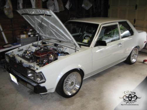

can you take a direct side on pic?
I'm just trying to pick the difference between these pillars and a true 2 door pillar, looks like it should be sortable to fit a factory set of rear glass...maybe
cheers, andy
My doors measure 1155mm on the body line... tad shorter than van doors...
Heres a pic of the side on shot...
I measured the rear glass also, along the base was 650 and 420 high on the front edge
Is it just me or does the rear glass look too long on the part closest to the door?
