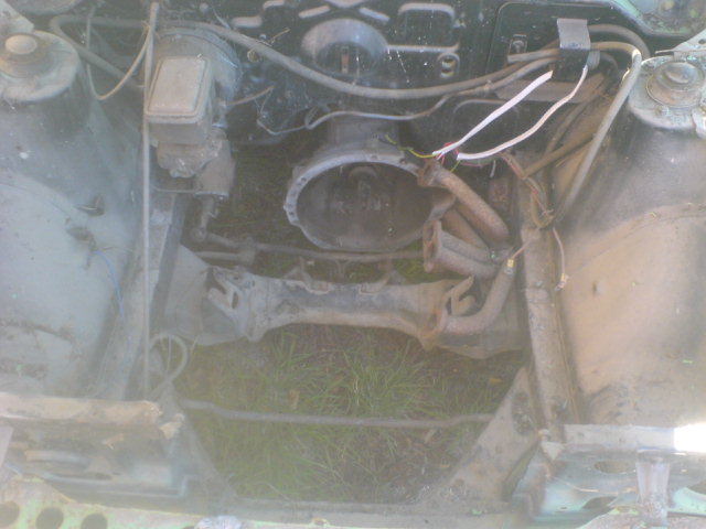

son of stig Posted May 23, 2009 Author Report Posted May 23, 2009 (edited) Redwarf said: Why bother? Just curious as i have all the bits lying around, i like seeing what can be mixed and matched. And have seen a couple of photos of KE2x engine bays with the same setup. Ive looked at my KE20, KE35, and KE55 today and scoped off the car spares. From the looks of it all it would need is 4 holes drilled through the firewall to mount the booster and possibly a bit of reinforcing, the rest should line up. this pic was from seabiscuits for sale thread: Edited May 23, 2009 by son of stig Quote
Redwarf Posted May 23, 2009 Report Posted May 23, 2009 By all means change it to a twin system (a very good idea...) but i can't see the point in a booster on a sub 900 kg car, when even "Big brakes" aren't even that big. I've had a 25 for nearly 20 years andd never felt the need..... Quote
