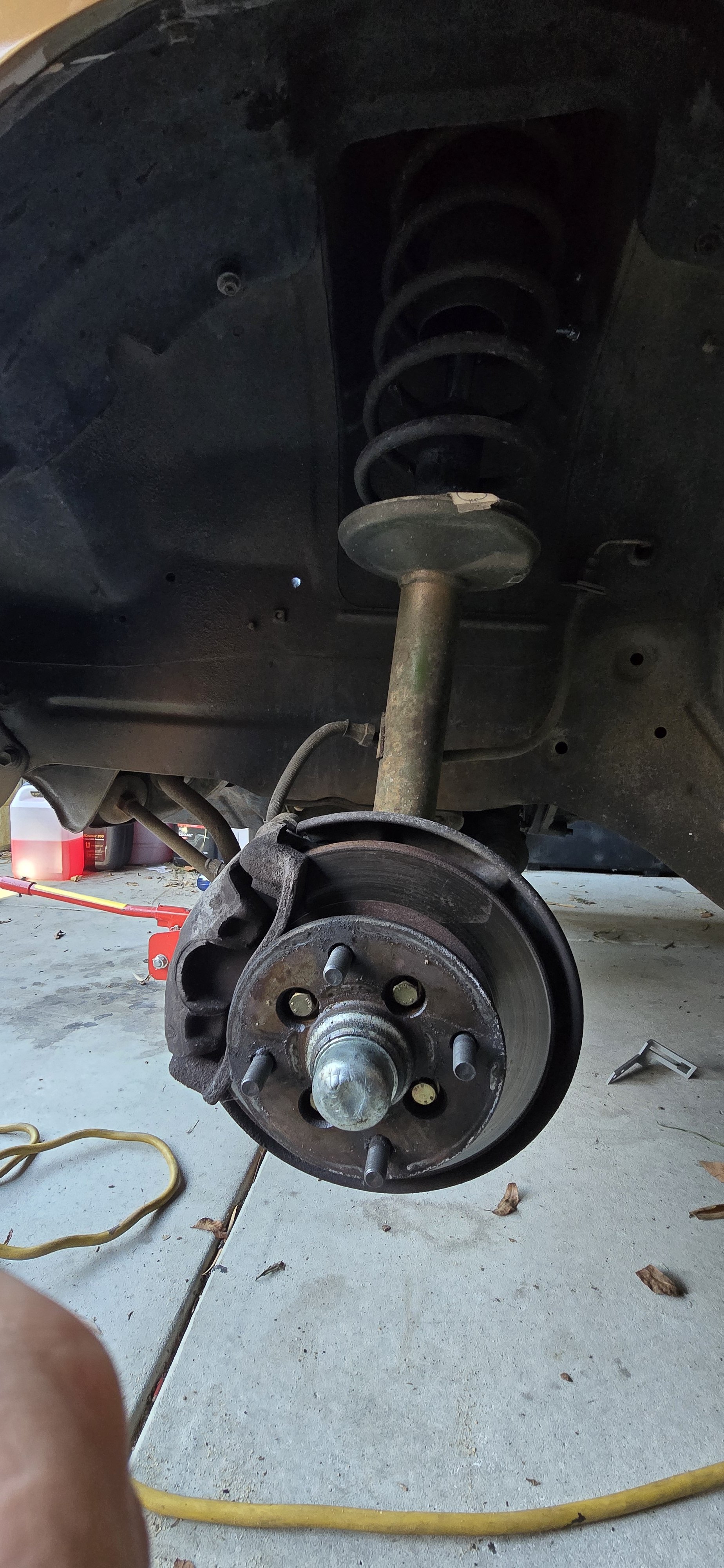

Strut clearance pics of AE71
and KE70
KE70 spring on AE71 Strut

It might also be worthwhile mentioning that the struts are not interchangable, unless you also change the lower part that connects to the ball joint and tie rod end. I don't know what it's called :)
Here's a pic of the brake pads as well.
AE71 panel van struts are the same as those found on the AE86. The AE71 sedan, wagon are different. And for those wondering about the KE70 panel vans, they're NOT the same as AE86 struts, just the AE71 panel vans.
Struts are all interchangeable as long as you get the brake bits and the steering arms (word you're looking for :lol: ) with it. If installing AE86/AE71 panel van struts into your 'normal' E7's, you'll need to also change strut top hats to correct castor.
