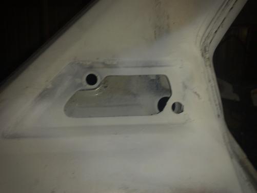

love ke70 Posted May 7, 2009 Report Posted May 7, 2009 cut it all out, then coat bare metal with a protective agent to stop it misbehaving in future. whether it be something like de-ox-it which adds a zinc-y kind of stuff and stops shit rusting, or something like penetrol thats a air tight seal, you choose, plenty of people with opinions to tell you what to use... consider galvanising entire car once complete if you want, its not all that expensive...but i reckon itd still f@$kin rust. damn corollas. plates should be around the same thickness as what you cut out. and as i said, as close as possible to the correct shape. if you can weld, go for gold man :P i couldnt weld and mine came up alright in the end. check out these galleries if you ever need inspiration. don't mind the final colour :$ haha you will note the old man in the photos, always ready to lend a hand http://s29.photobucket.com/albums/c292/arowland2/rust/ http://s29.photobucket.com/albums/c292/aro...rogress%20pics/ http://s29.photobucket.com/albums/c292/aro...rust%20repairs/ Quote

SLO-030 Posted May 8, 2009 Report Posted May 8, 2009 id say use something in the region of 1mm to 1.6mm as the rust repair section :P Quote
Ella Posted May 8, 2009 Author Report Posted May 8, 2009 Where does one buy steel this thin? the only steel we have at work is a minimum of 4mm thick, not much good for this i think. Quote

love ke70 Posted May 8, 2009 Report Posted May 8, 2009 thats right, its just a 70 at the end of the day. have fun with it :P i never bought any metal for mine, old computer cases, just any shit i could find did the job. from 1-2.5 mm depending on where it was. Quote

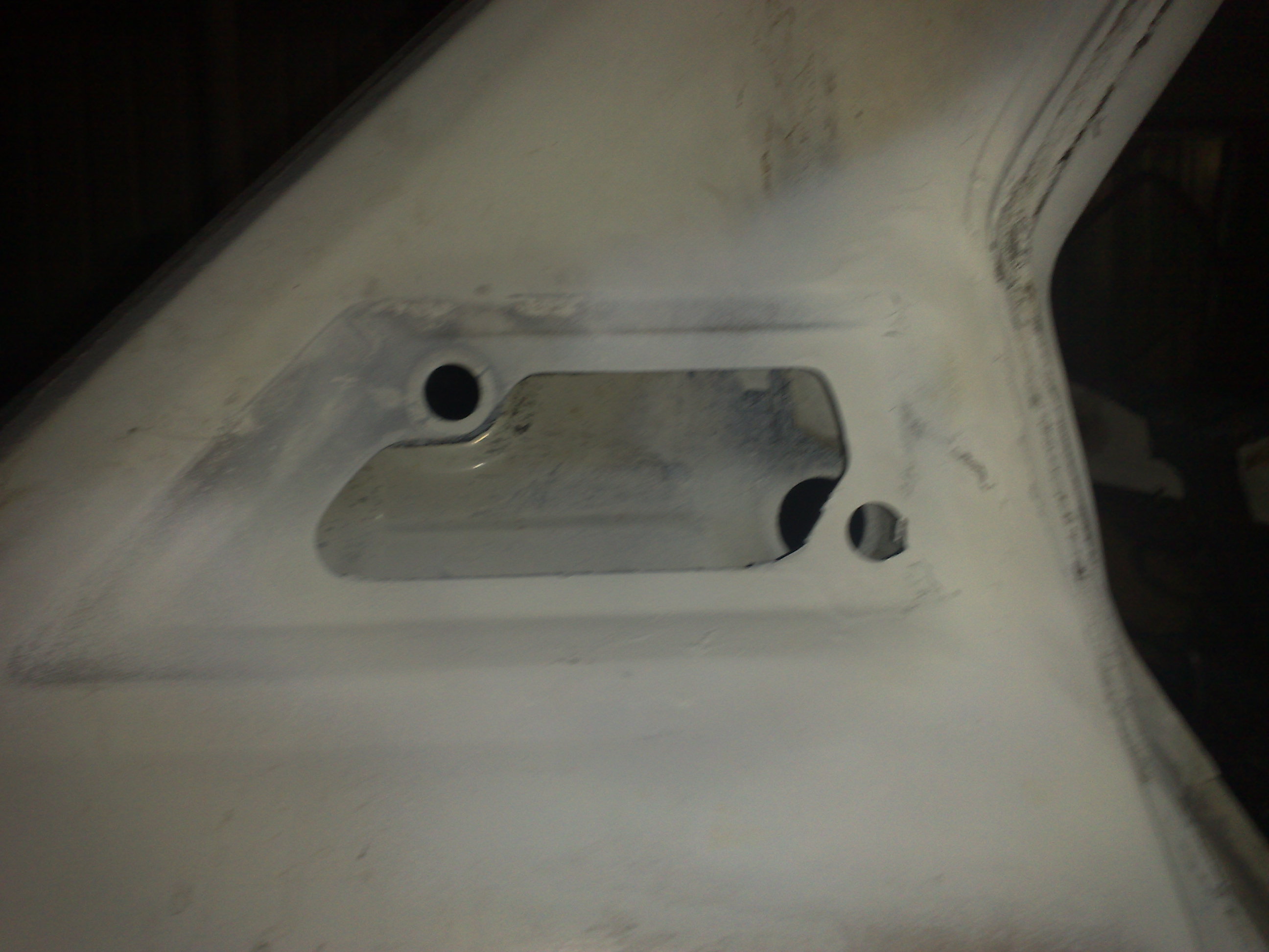

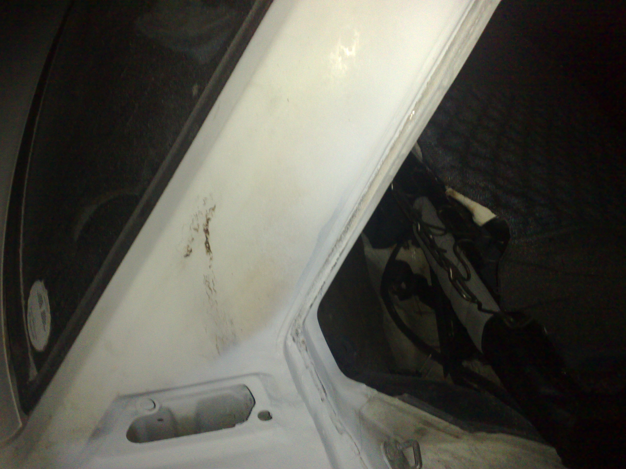

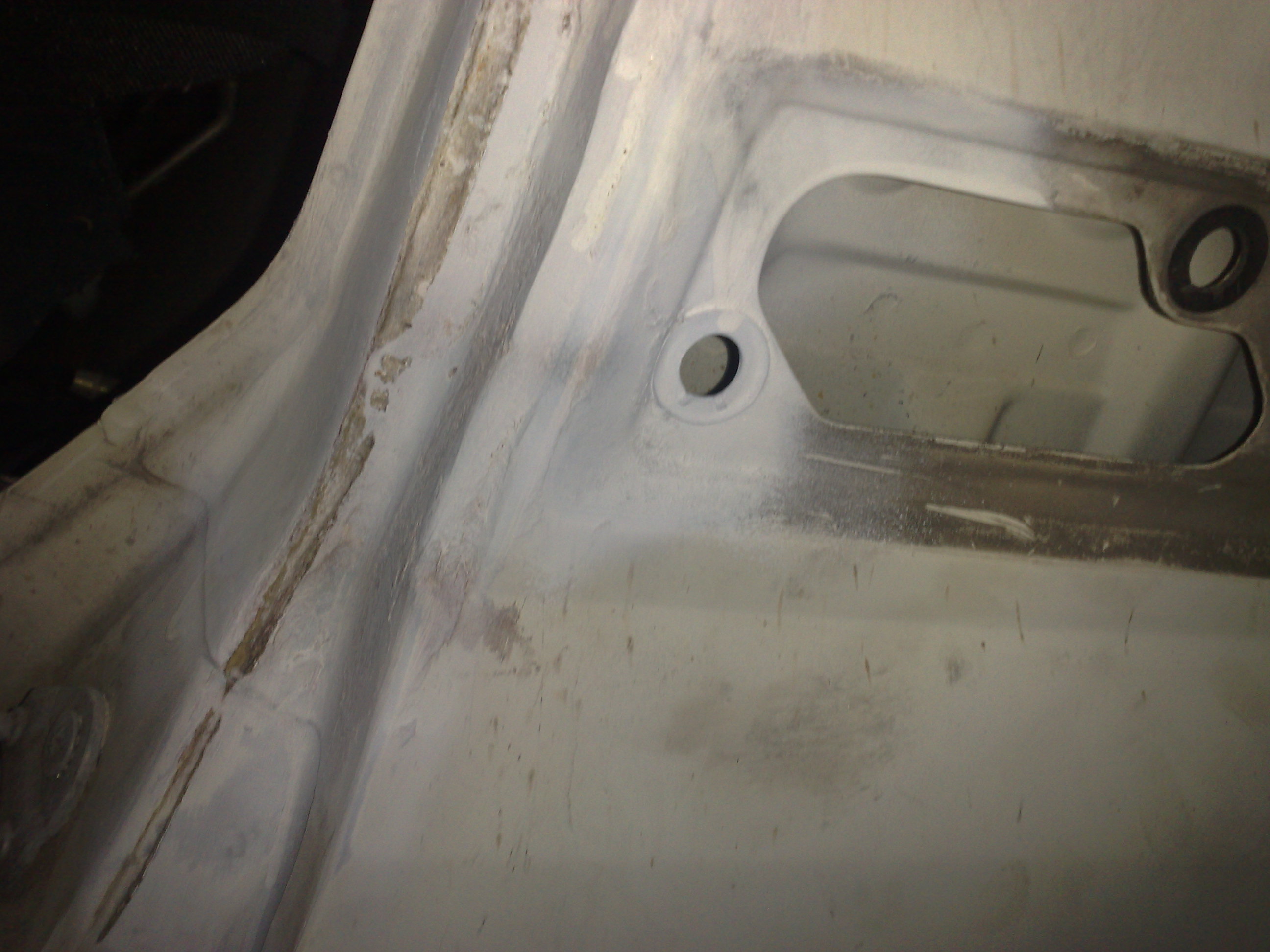

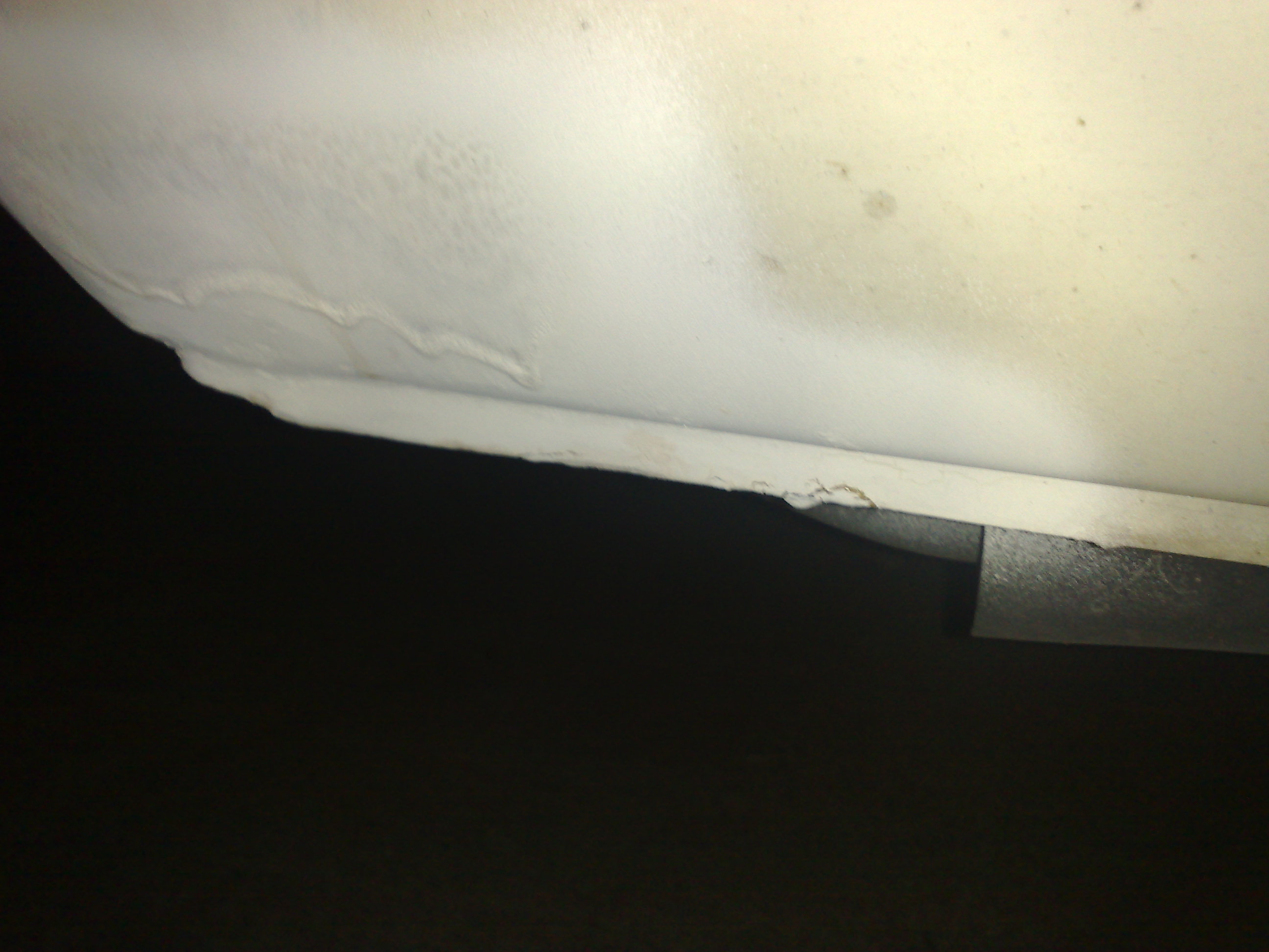

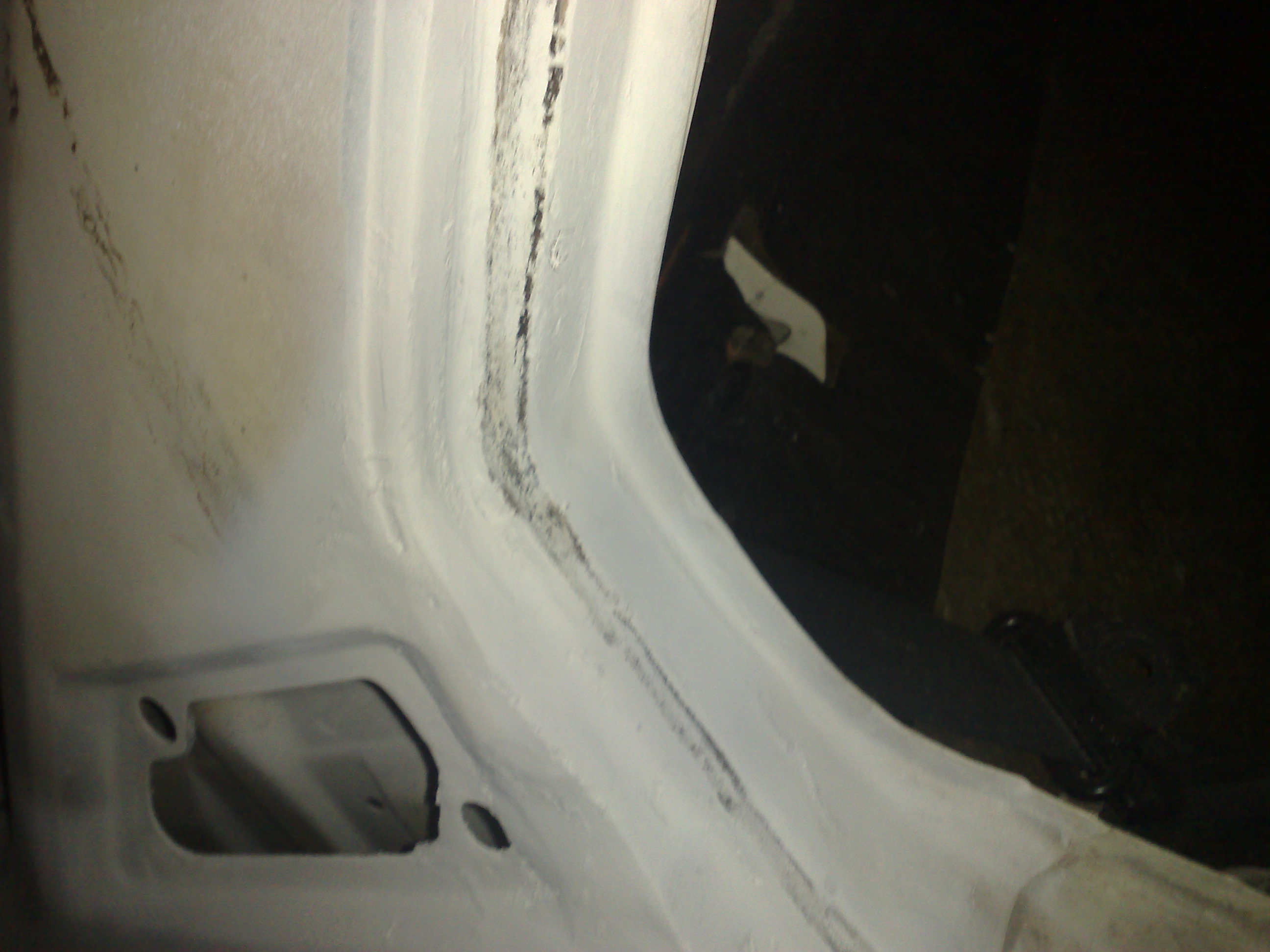

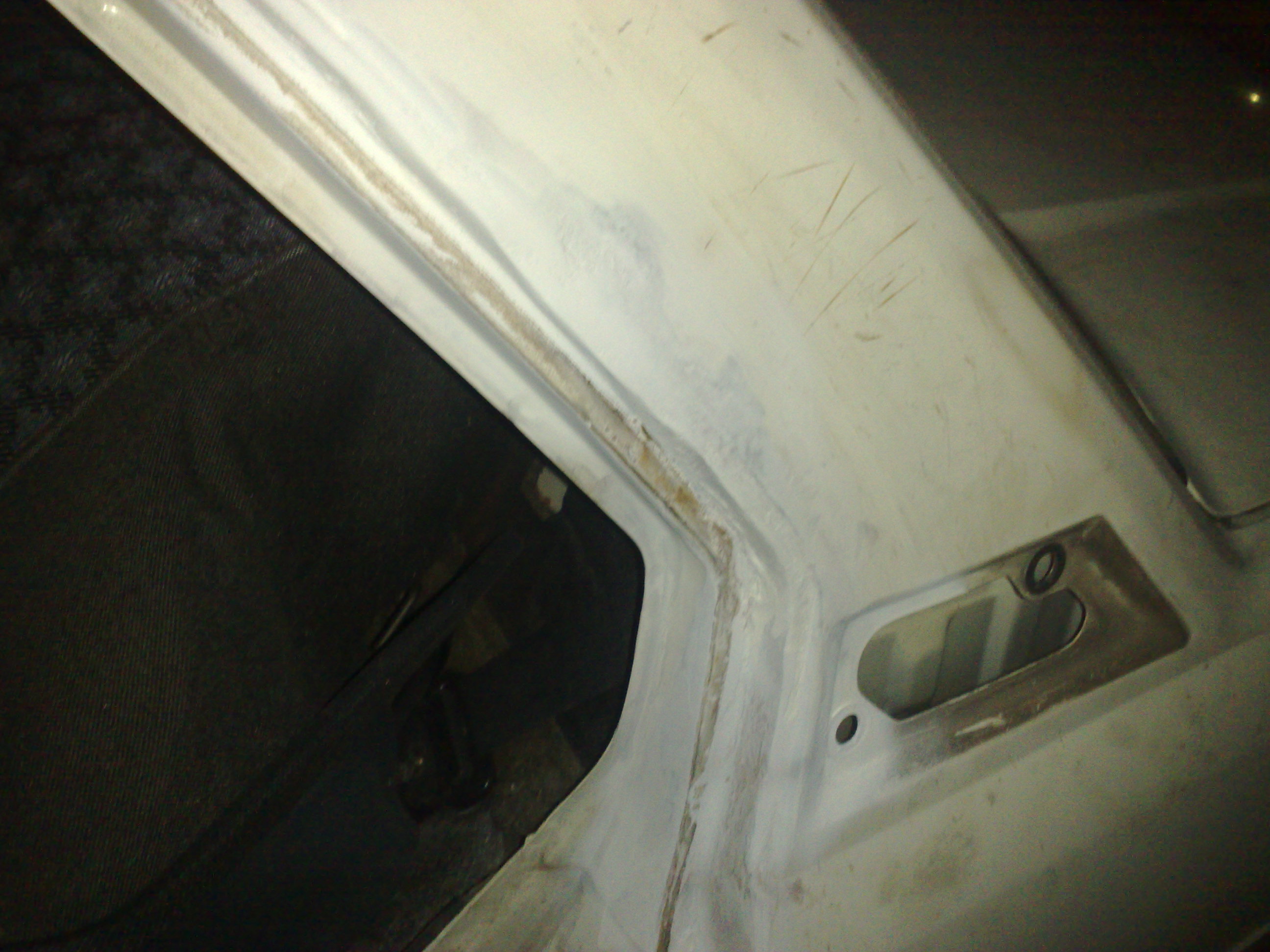

Ella Posted June 28, 2009 Author Report Posted June 28, 2009 heres all the pics of the rust repairs Terry (Mungi mods) did for me, just needs a a litte bogging to smooth it all then time for paint and rego i think Quote
mungi mods Posted July 3, 2009 Report Posted July 3, 2009 looks good now hurry up and register it!!!!!!!!!!!!!!! Quote
