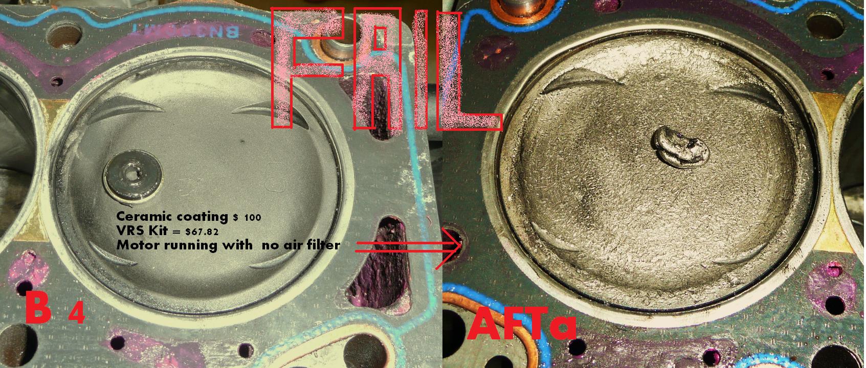

Jason Posted April 25, 2009 Author Report Posted April 25, 2009 TEDDY POSTING HERE ;) Results are as follows. lol. :) Quote
KE30_KE35_KE55 Posted April 25, 2009 Report Posted April 25, 2009 TEDDY POSTING HERE ;) Results are as follows. lol. :) I'm amazed that got past the valves, are the valves OK? Quote
Jason Posted April 25, 2009 Author Report Posted April 25, 2009 she needs a new head on closer inspection. ted Quote

towe001 Posted April 25, 2009 Report Posted April 25, 2009 Holly crap, i guess it wasn't carbon build-up thats for sure Unless it also comes in a gold colouring Quote
Jason Posted April 25, 2009 Author Report Posted April 25, 2009 (edited) Valves are fine valve seats on the other hand.... the exhaust one look scuffed. Will take valves out and have a closer look tomorrow. Hopeing a pollish clean up will show i don't need a new head, I carnt afford one at the moment. If any one was wondering what it was, it is a rubber seated washer for the valve covers, managed to get sucked up in there when i was testing with the manifold wide open :) Weird thing is I never saw it when i was poking around through the spark plug hole. Edited April 25, 2009 by Jason Quote
