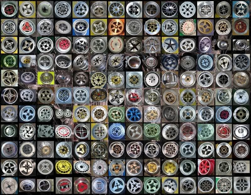

LukeAE71 Posted August 25, 2009 Author Report Posted August 25, 2009 (edited) A little update Had a decent offer come in for my Sigma Turbo wheels so seriously thinking of getting rid of them. I am thinking of just running 14 inch steelies painted black with a chrome trim ring for a little while. It will look even more sleeper I reckon but it might let the overall look down. They will do though while I find my ultimate wheel choice whatever that will be. I took the car to Yorke Peninsula on the weekend and it performed flawlessly :bash: Edited August 25, 2009 by LukeAE71
trav_555 Posted August 25, 2009 Report Posted August 25, 2009 Choose and choose wisely, It MUST be one of these: And in 14" with good offset, +/-0 is optimum Travis EDIT: Darn its small... hang on ill find a bigger one RE-EDIT: there you go :bash:

LukeAE71 Posted August 25, 2009 Author Report Posted August 25, 2009 Orange one?? I raped that one a few weeks back :P If there is another one I best be getting myself down there :( Thanks for the wheels pic Trav only a few to choose from :sob:
