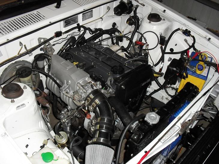

Almost there now..
Wiring 50% done, will be finished tomorow night, cheers Nick
Headers fitted
Fuel rail efi line done
Intake system fitted
Only a slight exhaust mod to go then if all goes well hit the road jack!!
Well got this wired up over the weekend, few issues here and there, but got there in the end.
Took it for a spin earlier, not tuned at all at the moment, idle at 2 grand, maybe vacum leaks, maybe something else, not sure, will look into it this week, have massive CBF at the moment.
Exhaust is all done, it smells like a go car at the moment, have the wrong size injectors in it at the moment, pretty sure they are maxing out their duty cycle, sending the standard ones off to melbourne tomorow to get cleaned and revamped, the fit em up and see how we go
Also need to put a banjo bolt on the end of the clutch slave line, it the braided line at the moment is hitting on the headers, so with that on it should be all good, have a speed flow fitting here to be fitted, ill get around to it this week.
Oh, and f@$k this thing is loud, sounds like a gokart on steroids! got headers with 2 inch piping, hotdog and straight through twin tip muffler..

Idle problem was that when i got my acc cable modified, i got it done 5mm too short, solvered now though!!!

All problems pretty much sorted now, new injectors in, all flowed and cleaned, idle problems sorted, all sensors plugged in and doing their thing.
End result, I'm pretty happy with this, not as powerfull as other cars ive owned, but this one is actually pretty fun/funky to drive.
