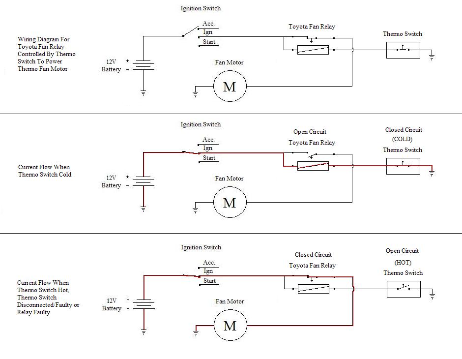

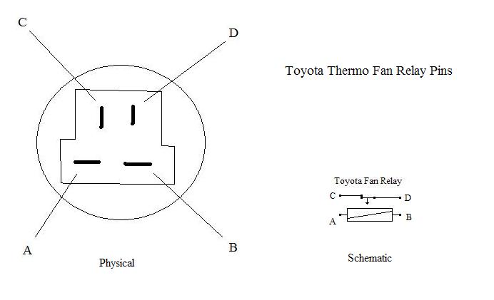

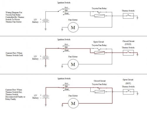

Medicine_Man Posted April 3, 2009 Report Posted April 3, 2009 Here are some diagrams I did ages ago explaining how the Toyota cooling fan relays work.. Quote
