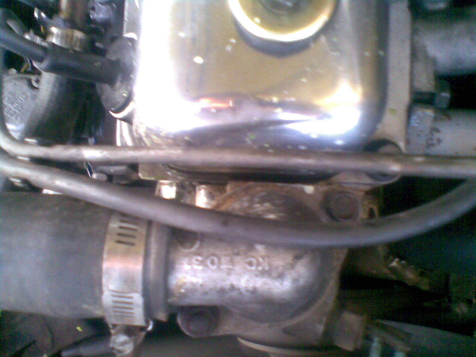

JiP Posted February 27, 2009 Author Report Posted February 27, 2009 I did. Not the best pic but when I checked this morning there was coolant sprayed all over the place. This after noon I tracked it to the top radiator hose where it meets the engine. I tightened it this afternoon and will see tomorrow if it still leaks. Quote
towe001 Posted February 27, 2009 Report Posted February 27, 2009 You aren't really having a good run with that motor are you JiP ? If you get sick of it, toss it my way. And as payment, you can mow my backyard for me. How old's the hose ? Cause they can deteriorate on the inside to such a point where they'll leak and/or split or burst Quote
JiP Posted February 27, 2009 Author Report Posted February 27, 2009 About 3 years old I think. WoW, really?? You'd let me do that??:dance: Quote
towe001 Posted February 27, 2009 Report Posted February 27, 2009 Yeeeep me thinks its a fair trade :dance: I'll take your problematic motor and you can have my problematic back yard to mow each and every week :y: But anywhat, i'd start thinking of new top and bottom hoses if the leak comes back again once too often. Not really all that good on the hose if you have to keep tightening the clamp up. I can't really see it being the clamp itself coming loose but it might even be worth a shot in swapping it over with the one on the radiator and seeing what happens.. Quote

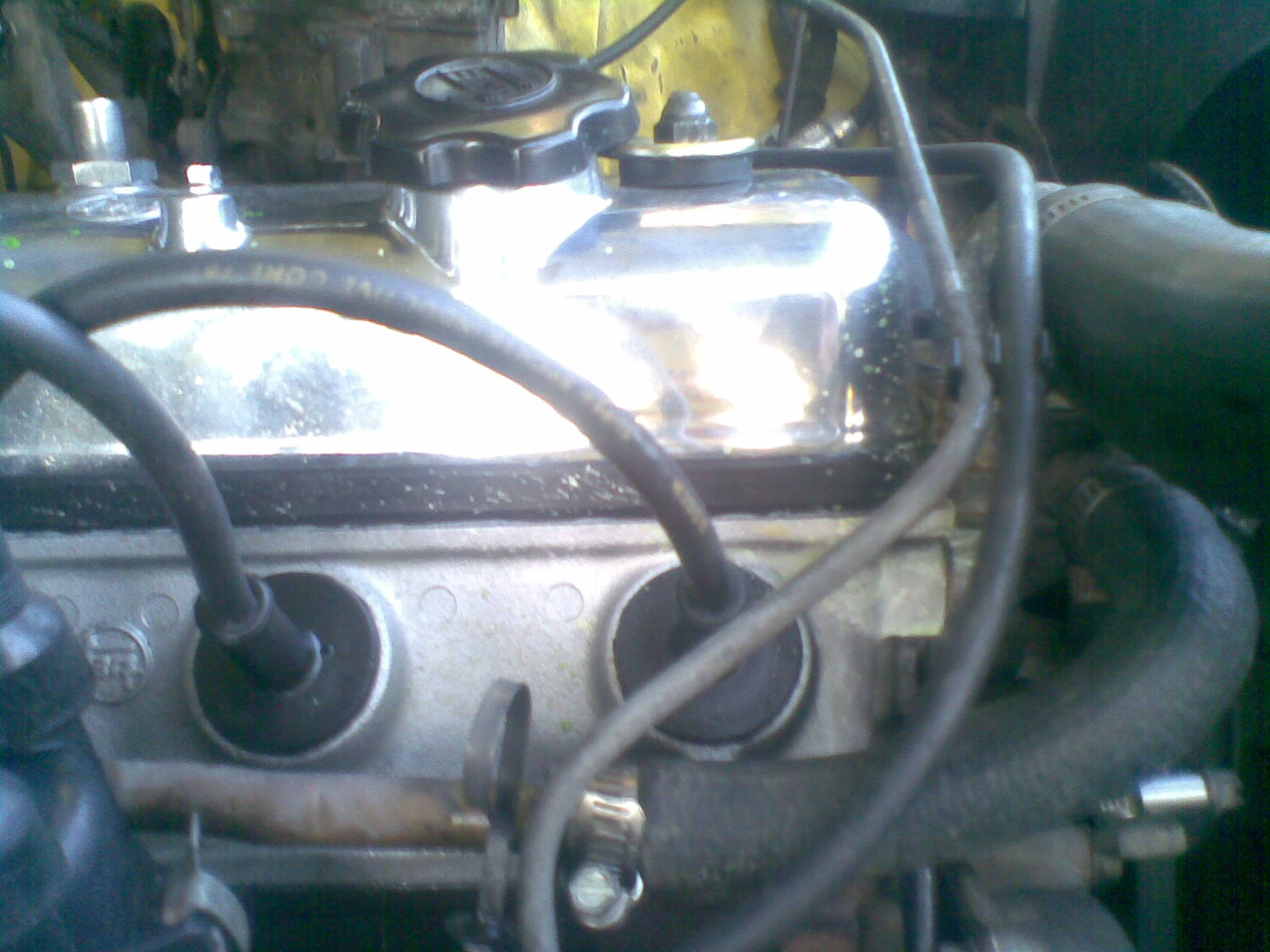

Trev Posted March 1, 2009 Report Posted March 1, 2009 (edited) Jon came over today so I could look at it. THE OIL LEAK IS NOW FIXED, IT WAS NUMBER 2 & 3 SPARK PLUG TUBE. Edited March 1, 2009 by Trev Quote

JiP Posted March 1, 2009 Author Report Posted March 1, 2009 It came from China. I have 2 spare kits, well only one now as i had to use one to fix Lolla this morning. I checked the car this morning as i got to work and there is a small bit of oil dribbling from spark plug no.2. I think this arvo i'll buy new tubes and rings. And also i'm parked on a nice clean stretch of road today so i'll see later if i continue to drip. Quote
