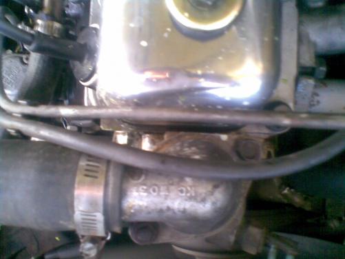

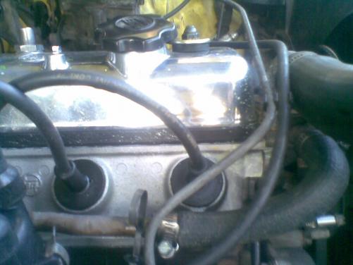

JiP Posted February 25, 2009 Author Report Posted February 25, 2009 Okay, good and bad news. Yesterday I had enough and I glues the rocker cover seal to the head. That seems to have stopped that leak. But the motor is still wet. The wetness is around the joint between the head and block, the dizzy, oil filter housing and gearbox to block joint. Now we glued and made a gasket for the oil filter housing to block joint. Stuck a new o ring on the dizzy and stuck a new head gasket in. We didn't touch the fuel pump as the leak isn't from around that plus I had that repaired a while ago. Am I missing anything?? Quote

Trev Posted February 25, 2009 Report Posted February 25, 2009 towe001 said: The bag to fit the motor in ?We sell Polyethylene bags at work that'd be big enough to fit the whole motor and gearbox in if you get really disparate lol And that, sir, could very well be the problem then When I took the head to work i put the straight edge on it and even tho i couldnt get a good corner to corner reading due to carbon on the valve recess it still looked slightly off straight, When I put the head on i put wurth silicon special around external area of the lifters/pushrods (general practice with triumph motors and so on) so that the oil side has some 'better' sealing, Unfortunatly after 3 hours or so of fixing a leak Jon just wanted to go home so thats as far as we got. Quote

JiP Posted February 25, 2009 Author Report Posted February 25, 2009 (edited) Oil pressure switch has been done too. I was looking at the head to block joint tonight and could see a space where I can't see the glue, it looks like a hole. Not sure if it means anything. Edited February 25, 2009 by JiP Quote
