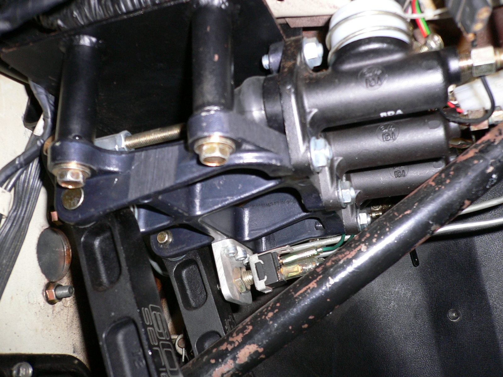

Ke10-Hoon Posted May 23, 2009 Author Report Posted May 23, 2009 Thanks for everyone’s input, you have all put me back on track to finish this car off. However, after reading all the posts I have decided to leave the looks to last. Yeah I know the rims look shitty and a nice paint job will get heads turning but like 'Guest' said its a great feeling when you beat a shinny car, although they are travelling in comfort & safety (something that this corolla lacks). I would never go for a quick spray job. It would be a complete tare down, sand/media blastered and a top nock paint job to last for ever. (when I win the lotto that is). I want this car to fly. Let’s go for 11sec down the 1/4 mile or better. The car has recently developed an exhaust leak between the turbo and exhaust manifold. I can't get to the bolts to tighten then up, so I guess I will need to get a new steam pipe high-rise manifold (6boost maybe?) and new turbo. I was thinking a T2860RS (disco potato) or the GT2871R. Not cheap. Here is a close up photo of the master cylinders. A photo of the booster is on a previous post. How good do those seats look!! I have CRX seats in mine. Quote

untubbed_20 Posted November 4, 2012 Report Posted November 4, 2012 Be nice to know if you used 75 or 74 (74's are shorter )series master cylinders..long shot, think this car is long been sold.. cheers darren Quote
