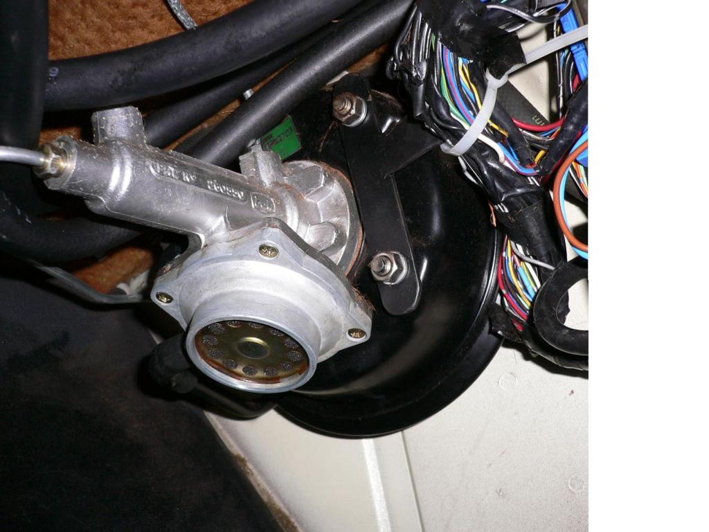

Ke10-Hoon Posted February 17, 2009 Author Report Posted February 17, 2009 oh mean thanks how much did that whole pedal box cost? and whered you get it from i needa run something like this on mine thanks heeps and can you run boosterson them do you no? Alot. $1600 installed. The unit alone cost around the $900 mark. I had the shits with my original setup so forked out the cash and got it done right and for all. You can get them from any good brake shop like B&R, rare spares etc. Yeah you can run it boosted but it needs to be remote. The Ke10 don't have a booster standard. Here a pic of my remote Booster mounted under the dash on the passenger side. i agree! i got a hilux diff in my 30. i was noticing alot of people are saying they have shortened there diffs what hilux is that out of new or old? ive got mine out of a really early hilux 2wd and i didnt have to shorten it at all :wink: I'm not sure it could have to do with the body sizes between the ke30 and ke20 ect but just thought id ask the question.johnnyt Its out of a 1999 Hilux I think. I got the recipet around here somewhere with the year on it. Putting a Hilux diff in a Ke30 without shorting it... never heard of that. You would still need to stuff around with the mounts. Not to mention the very important pinion angle. What year diff was that out of? Quote
