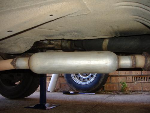

Tume Posted April 11, 2009 Author Report Posted April 11, 2009 Ok for the last couple of weeks/month the brakes have been feeling like they are getting worn and need to be replaced. Since it is the holidays and last night they majorly felt as if they werent working to standard today I got the gear to replace fronts and when jacking them up....found something I should have noticed when I bought the car. The fact that there is a hotdog in the middle of the car aswell as at the exhaust tip. Have already booked the car in to get a stock pea shooter welded on since I have no need to have to be able to hear the car's every thought and complaint, and I don't have the welding facilities myself to be able to do it. I'm hoping that it will still be quiet enough as I'm not going to go to the effort to get the middle dog removed. Also, when I removed the calipers and got to the pad's I noticed, they still have roughly 20-40mm of meat still left on them, and the rotor's are fine. As in not glazed over, when checked the surface is at a continuous point (no waves) so I have no idea why the brakes have been screwing up now. I'm already half way through replacing everything though so I'm going to put the new gear on anyway and just go from there. Also on the lists for this holidays is to get the automotive completely out of it as it likes to rev a bit when the clutch is let in while changing gears (yes, i am removing my foot from the accelerator) and there might be a vacuum leak or maybe timing a tad out as she doesn't like idling without choke at the moment. After that's all sorted it will be time to get rid of the rust! Dad went out and bought me a grinder today in preparation so I think he's going to be wanting to show me how to do it all his way. Just hope its the right way :dance: . Quote
Tume Posted April 11, 2009 Author Report Posted April 11, 2009 Ok...moral of story is always double check your work. Went out to finish the brakes and looked at the pads removing the last one..Found out why the brakes werent working properly. While 3 pads were working fine and all, 1 pad had decided it would disintegrate itself before everyone else. Quote
