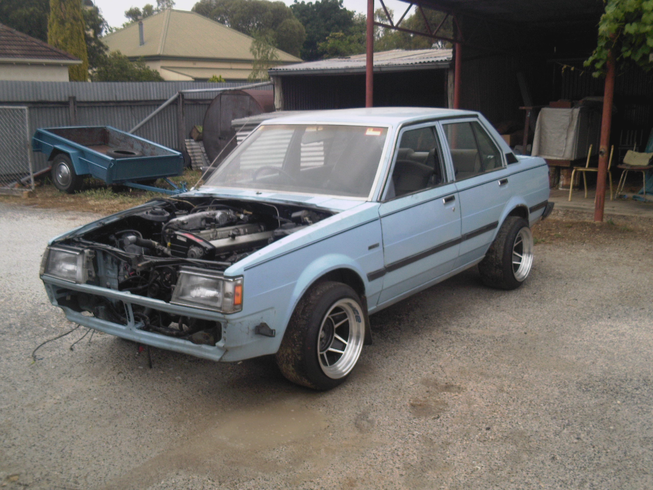

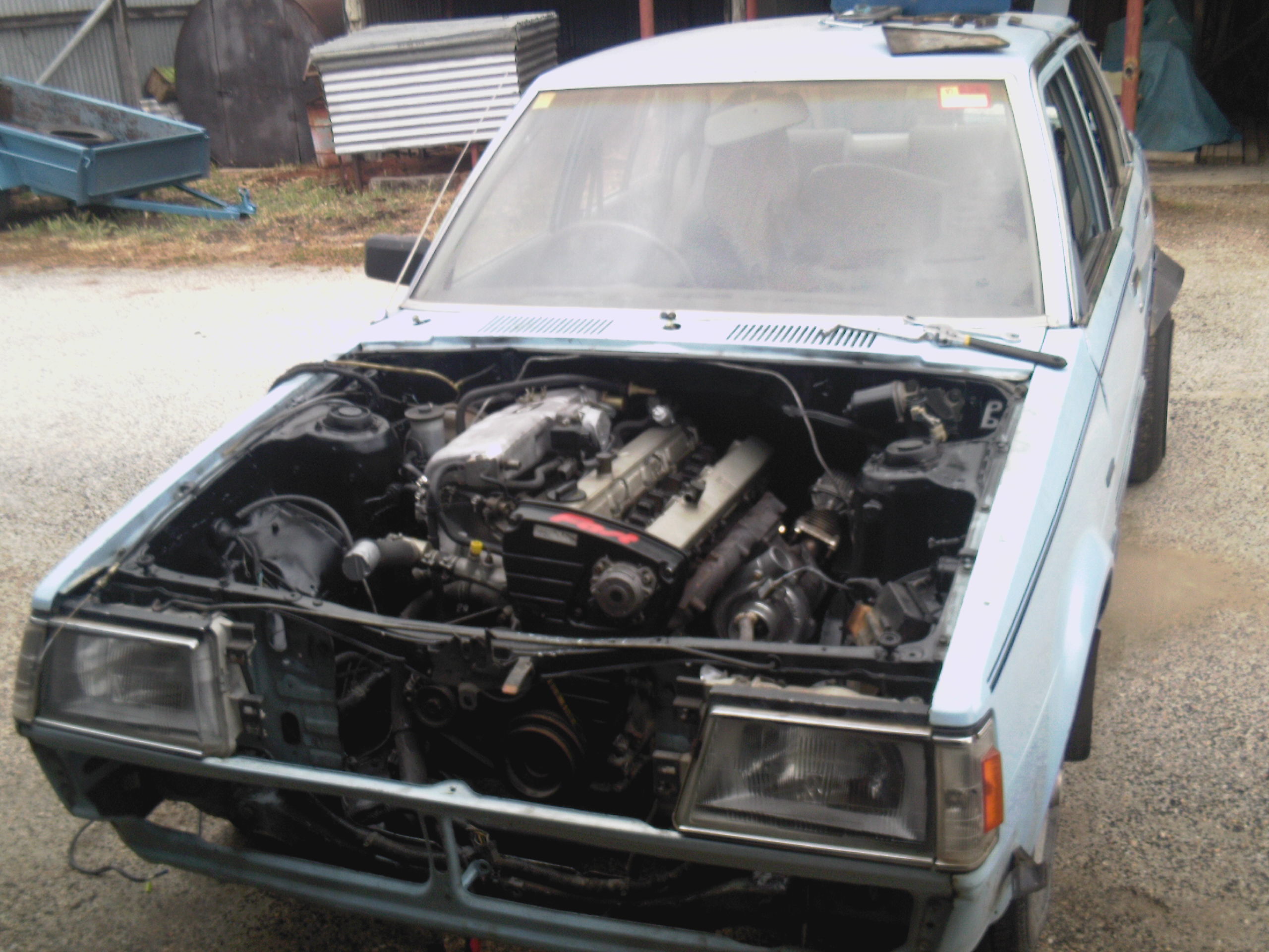

boosted_ke30 Posted January 11, 2009 Report Posted January 11, 2009 Hi all ive just completed installing an rb20 midmounted in a KE 70 n just wondering what people would suggest for a good suspension set up n what actually fits. ive used the standard ke70 crossmember and steering rack so i need some suggestions to what actually fits up too it Quote

bLinded_ Posted January 11, 2009 Report Posted January 11, 2009 Dear sweet Jesus. :( Front wise, maybe go with AE86 struts and look down the FC brake upgrade? Even XT130 struts with the Hi-lux/Peugeot 4spot upgrade. Both those struts will give a wide variety of inserts that can be used, and also can easily be converted to coilovers. Going with the S13 route, one thing is that you will gain a hell of a lot of track at the front, so I doubt you'll be able to fit those rims in the picture under the guards. Rear wise. As AE70 said, what diff are you running? Quote

boosted_ke30 Posted January 11, 2009 Author Report Posted January 11, 2009 yeah its a real tight squeeze i cut a lot of the firewall out and the motor sits back roughly 250mm under tha dash. Quote

Roo Posted January 11, 2009 Report Posted January 11, 2009 yea i would go a corona strut, pug/hilux brakes brake setup, i have them in mine and stop really nicely s13 gear you get good brakes but cornering is shit house, as the ballpoint angles are all wrong, you also end up with way to much track Quote
