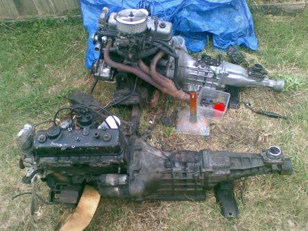

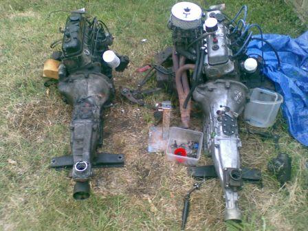

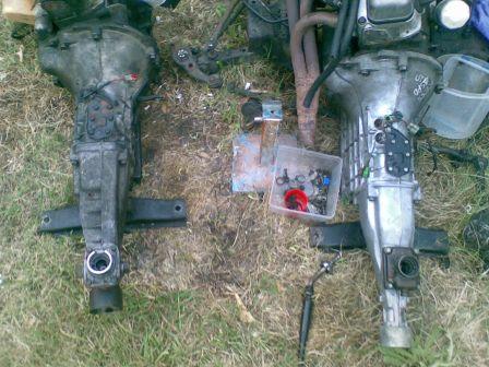

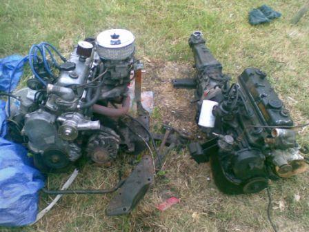

shauns ke30 Posted January 3, 2009 Report Share Posted January 3, 2009 (edited) hey guy's i have two 5 speed boxes for a k motor at home and i want know whats better....one is a ke55 5 speed and the other box i got told its a celica 5 speed!! how do i tell whats better???? whats the difference????? i know one is definately a ke55 5 speed but i don't if the other one is a celica 5 speed if you have any info please let me know thanks heaps cheers shaun.. :yes: Ok here are some pic's Thay are both 5 speeds the dirty looking box is on a 3k and the clean looking box is on a 5k look at where the shifter sits on the gear box's!!! the gear box on the left i had to cut a hole in the floor to fit the shifter and the box on the right fit's in the original 4 speed shifter hole i no thay are 5 speeds can some one tell me what thay are off??? (e.g ke55,ke30 and ke70) cheers shaun Edited February 2, 2009 by shauns ke30 Please try and keep to the english language. Reading that hurt my head. Quote Link to comment Share on other sites More sharing options...

shauns ke30 Posted February 2, 2009 Author Report Share Posted February 2, 2009 New pic's Quote Link to comment Share on other sites More sharing options...
BReNt Posted February 2, 2009 Report Share Posted February 2, 2009 They're both k50s. The one with the shifter further back is out of a ke70. Quote Link to comment Share on other sites More sharing options...
