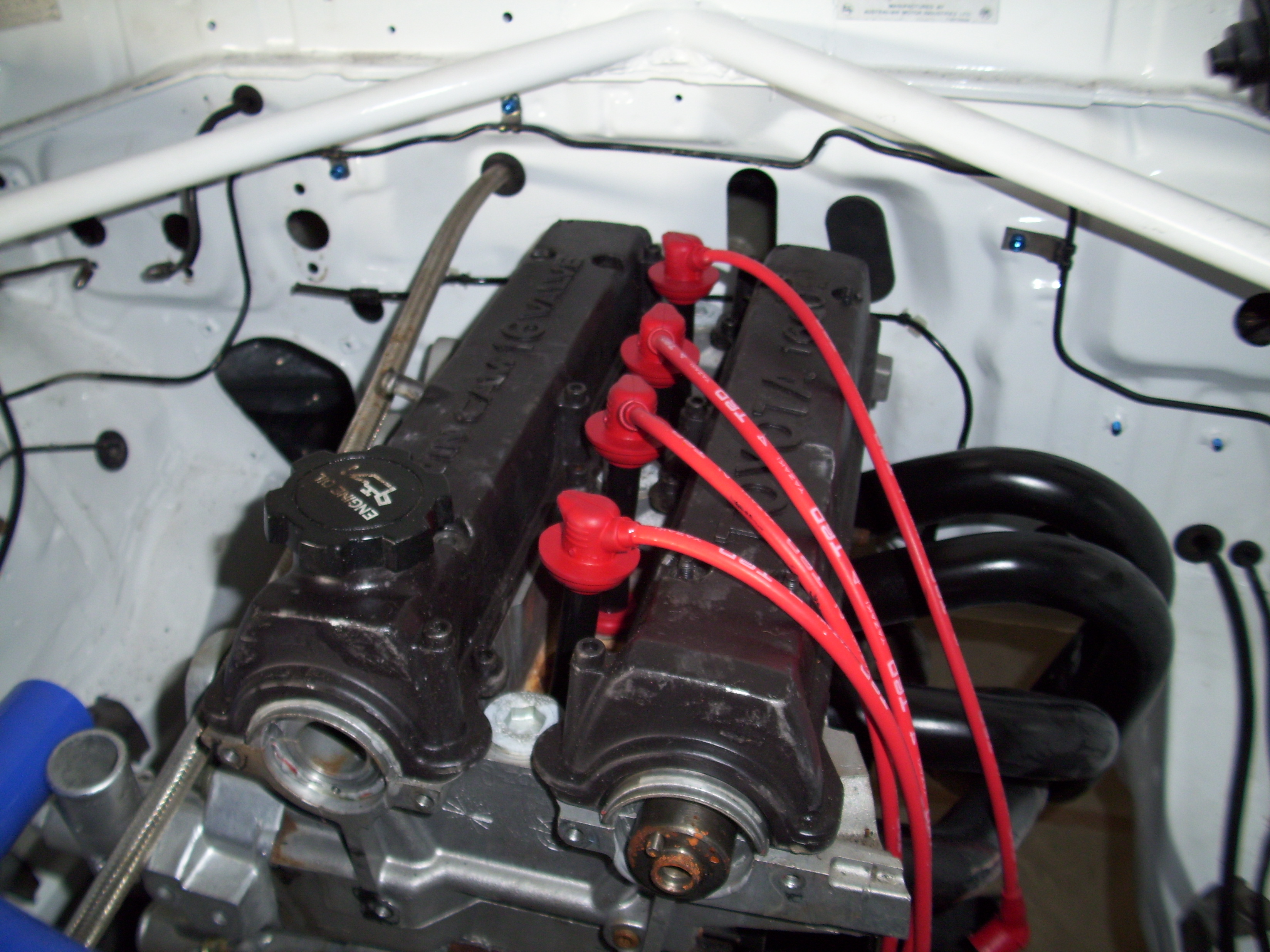

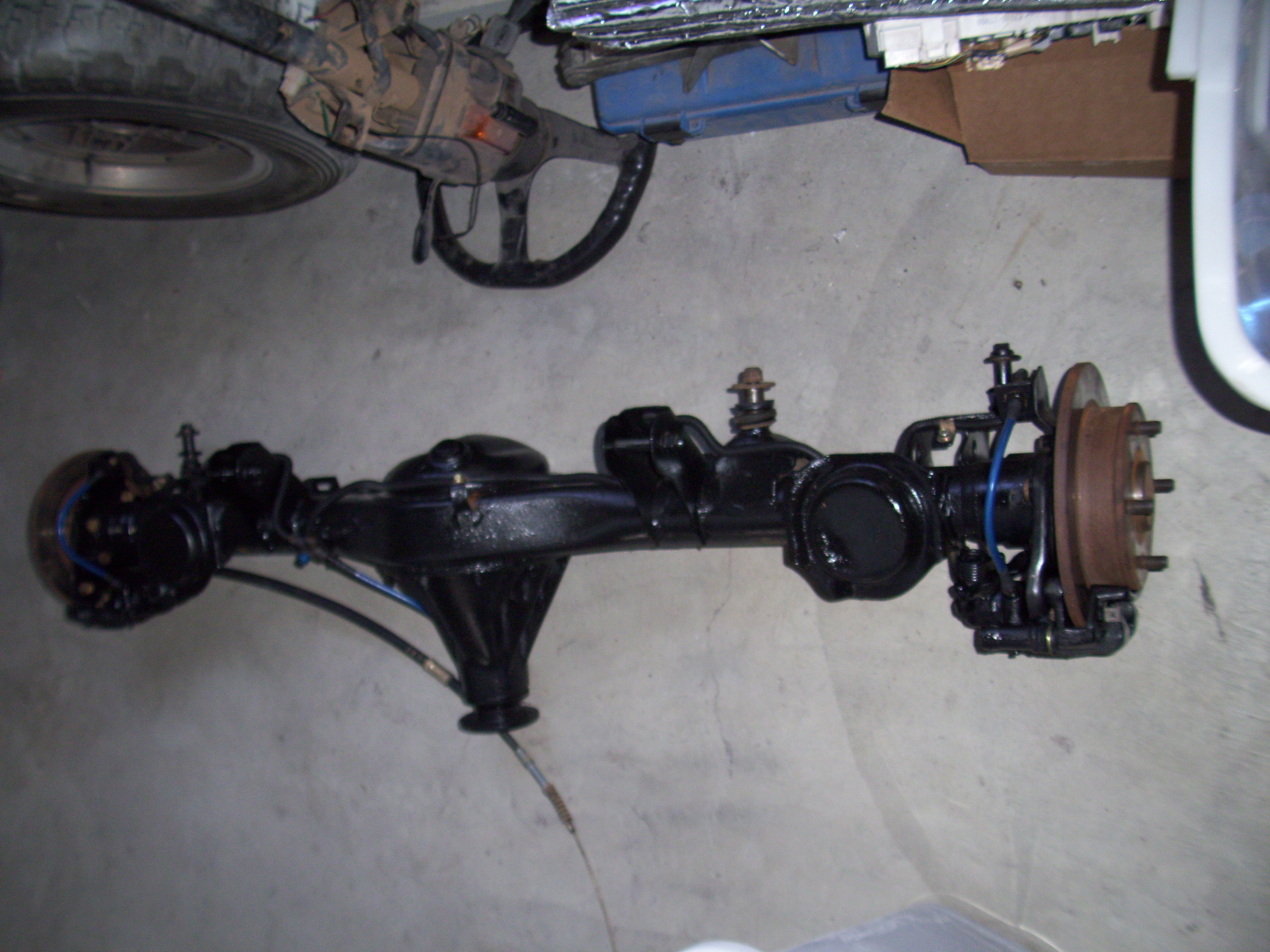

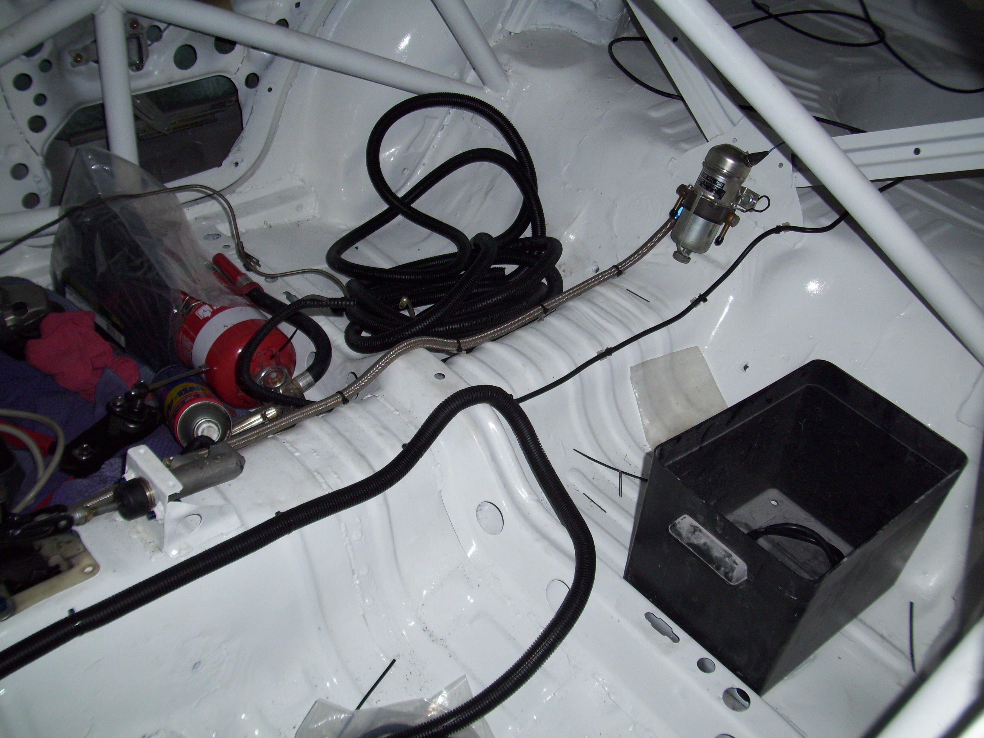

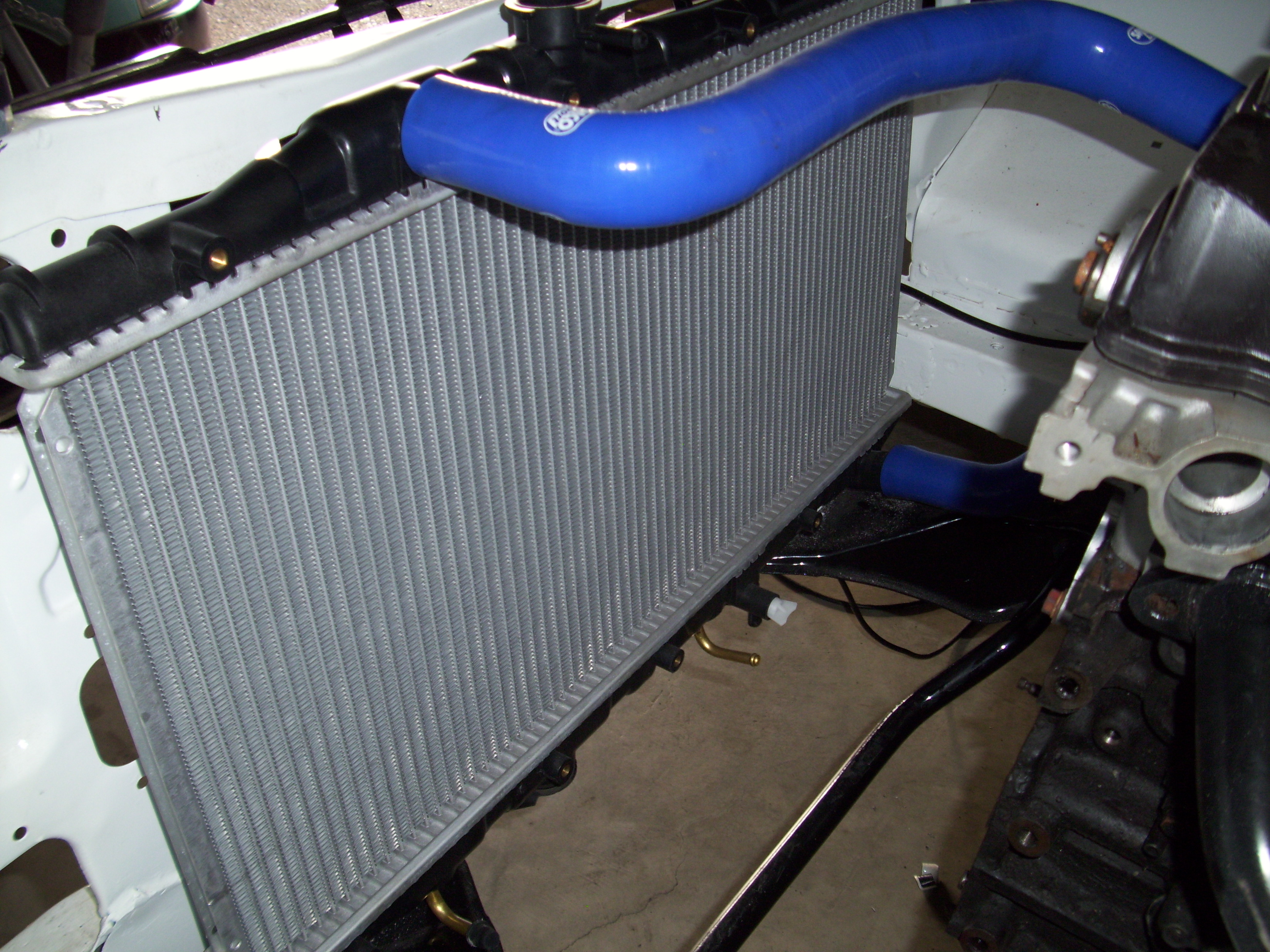

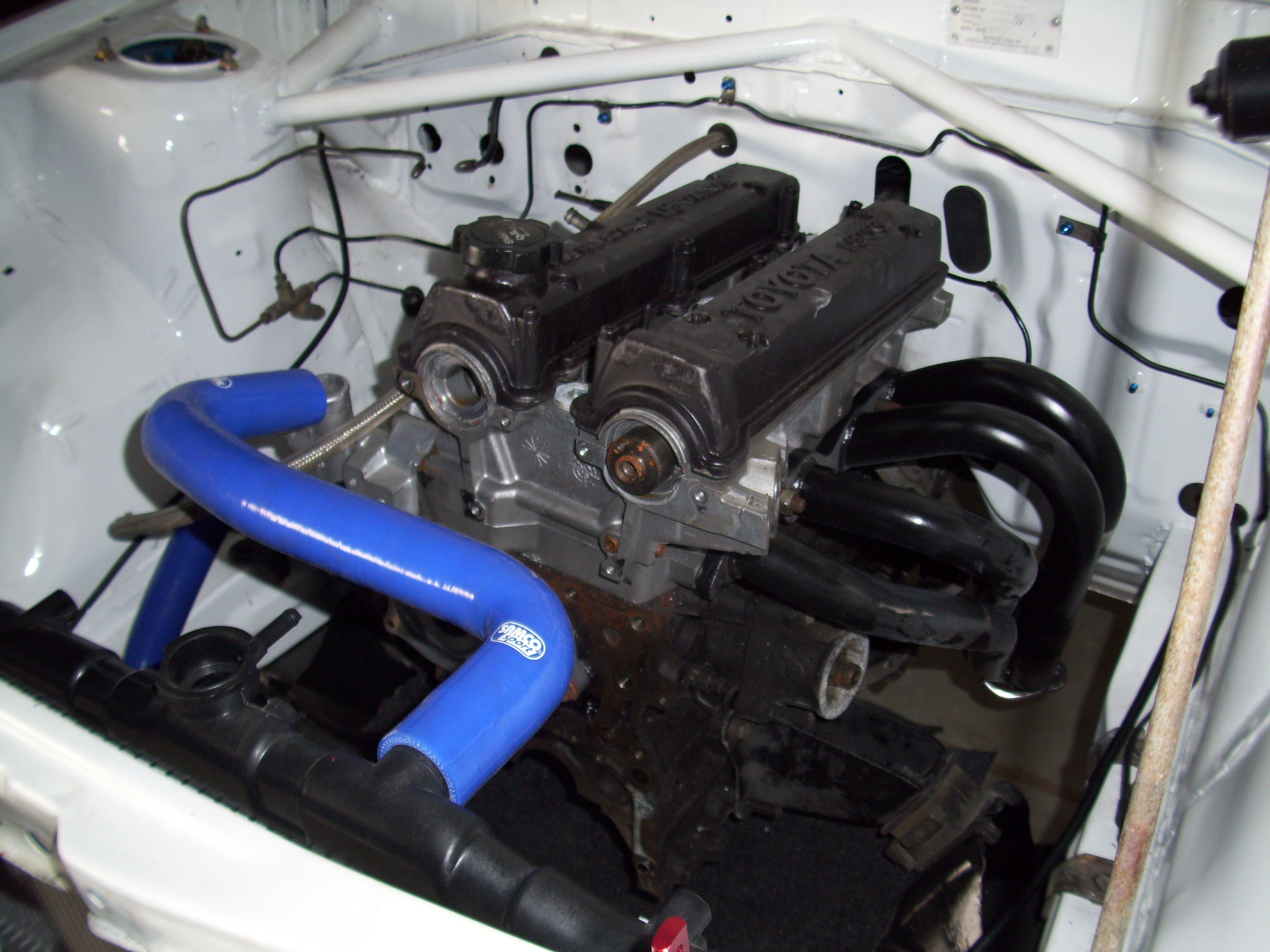

TRD ke70 Posted April 11, 2010 Author Report Posted April 11, 2010 Thanks, it's coming together slower than expected, but it all takes time. Should be sweet when she's finished. So this weekend saw the diff all painted and reassembled, just waiting for Tony to finish the trailing arms. have started to run the wiring, but had to stop and mock up the engine and gearbox to make sure I got all the wiring right, hate having to pull shit apart to correct stuff. So this gave us the chance to pull some of the goodies out and trial fit them. Quote
TRD ke70 Posted April 11, 2010 Author Report Posted April 11, 2010 (edited) Nope!! It's a Camry :bash: SV21 I think. Edited April 11, 2010 by TRD ke70 Quote
Mitch-12 Posted April 11, 2010 Report Posted April 11, 2010 sweet i have a holden v8 radiator in mine from a vk i think Quote

beerhead Posted April 11, 2010 Report Posted April 11, 2010 Looking awesome, what kind of pipes you running on this beast 4-2 or 4-1's? Loving the integrated tri brace too :bash: rolla__madd: I'm pretty sure the trick is dry ice and a hammer and chisel, it'll make the tar brittle and it'll snap into bits rather than smearing. Quote
TRD ke70 Posted April 11, 2010 Author Report Posted April 11, 2010 Thanks Beerhead, that's the old cage from the old car, tri brace was always in there, but because the cage is MANZ and NOT CAMS approved we can run it, if we had a CAMS cage we couldn't, (Stupid f@$ken cams) Sam, beerhead is right about the dry ice, it's the easiest way to remove sound deadening from the inside of the car, for the underneath we use wire bushes on drills and grinders, then paint thinners to remove the last of it, big job!! Seam welding is where you do weld MOST of the seams, not fully, but just stitch welding, so every 25-30mm you have a weld. You don't need to weld every seam, just the important ones, these would be the ones that will add strength to the body shell. Have a look through some of the earlier photos and you'll see where we have welded, to get an idea. Quote
