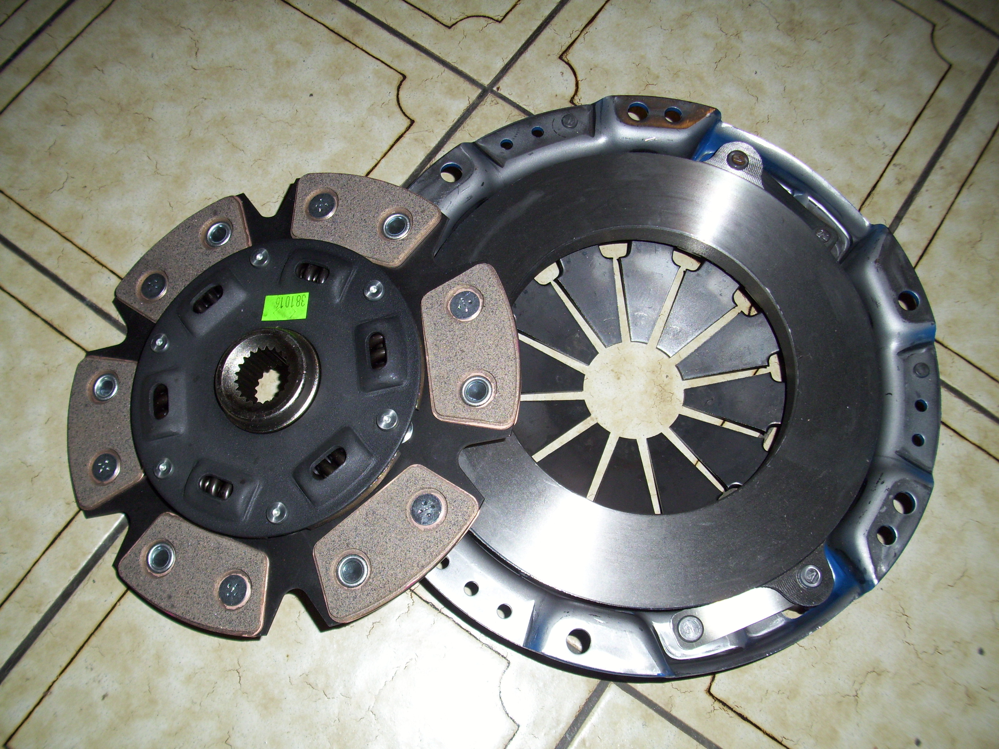

TRD ke70 Posted March 19, 2010 Author Report Posted March 19, 2010 thanks, we're hoping she'll be a weapon. Thinks have been a little slow happening on it as we a fitting a roll cage to a Mitzy rally car for a friend of ours, hoping to have that finished this weekend so thinks should really start to move a long. More parts have arrived. Mmmm, nice new clutch, good for 250hp. Quote
camerondownunder88 Posted March 19, 2010 Report Posted March 19, 2010 Why do you have springs in the centre of yours?? :) Cam Quote
trd Posted March 19, 2010 Report Posted March 19, 2010 Hi Cam. it takes the shock out of the drive train Quote

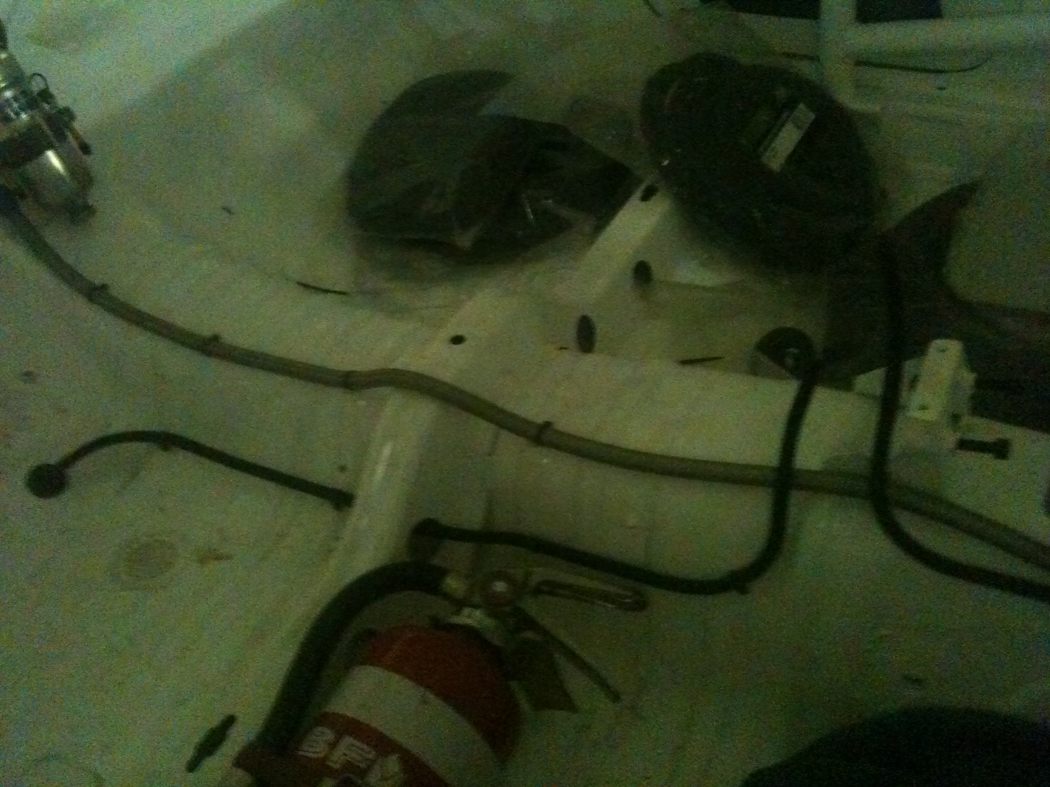

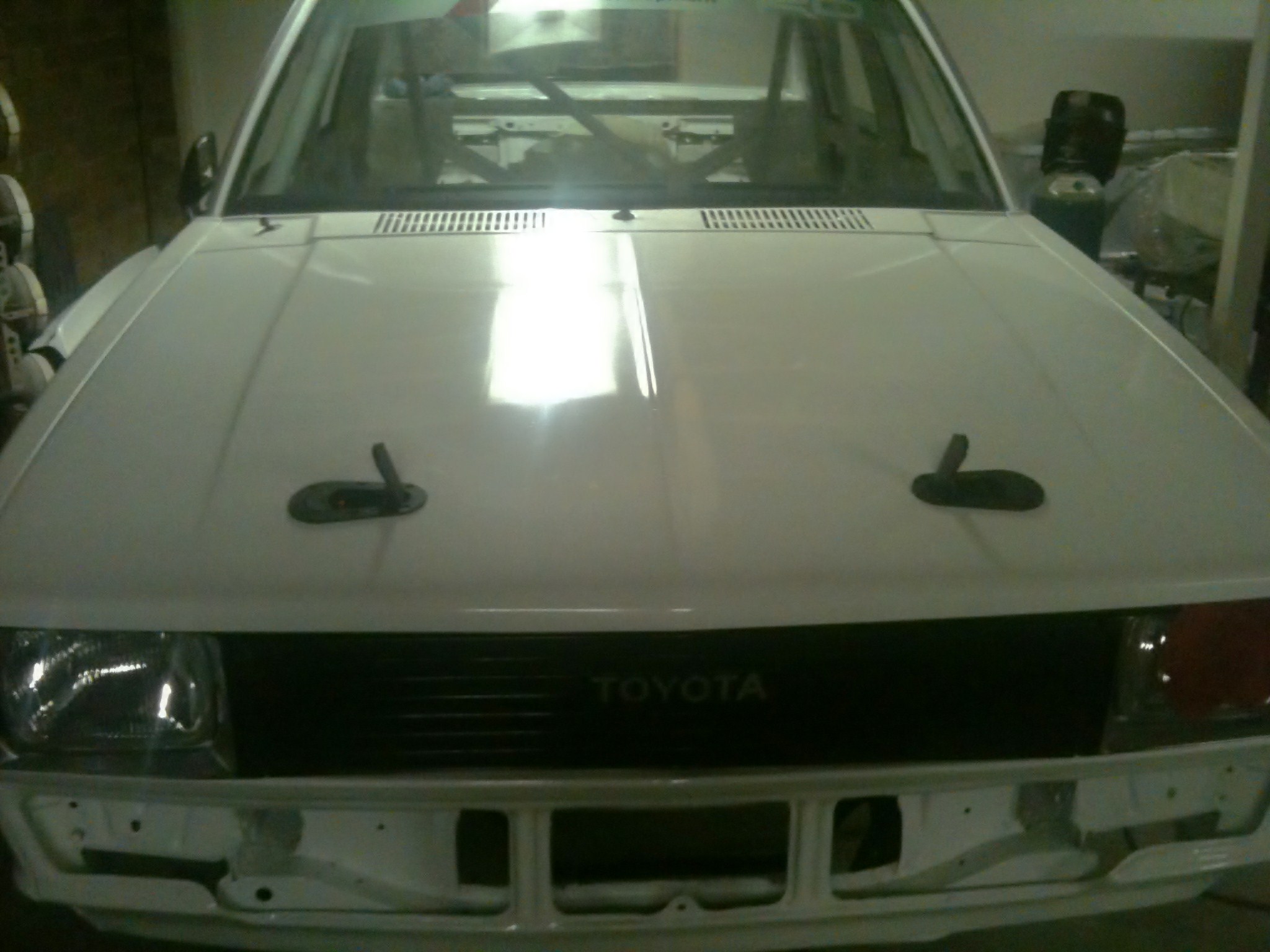

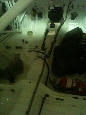

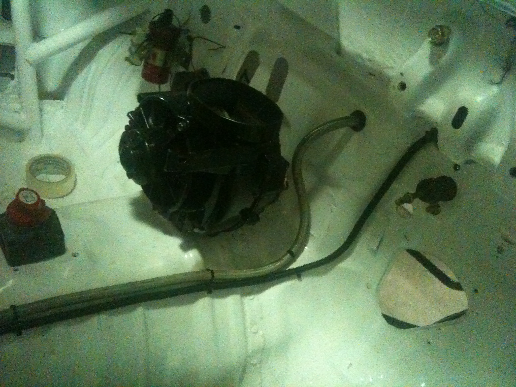

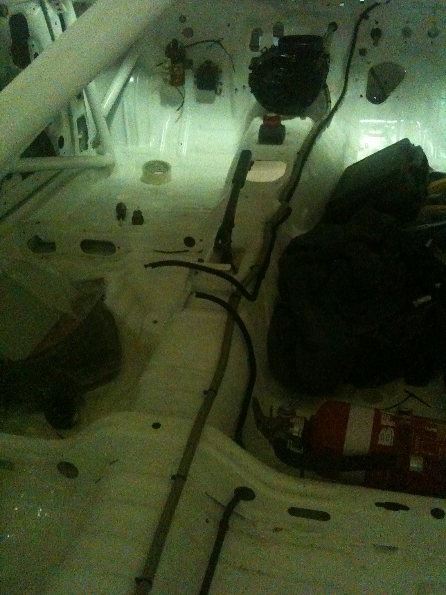

TRD ke70 Posted April 3, 2010 Author Report Posted April 3, 2010 Well this weekend was back to work on the new rally car. Tony got the bonnets pins fitted after f@$king a set of Sparco ones, the Sparco pins were made smaller than the nuts they supplied with the pins, as soon as you tightened them up they stripped the threads on the pins, shit f@$ken crap!!! Ended up using our Jap ones, which were perfect. Started running the fuel and brake lines inside the car, and under the bonnet too. Starting to look a little more like a car now!! Quote
