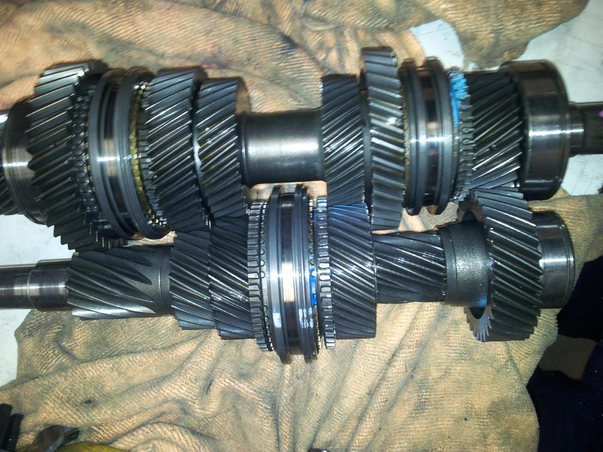

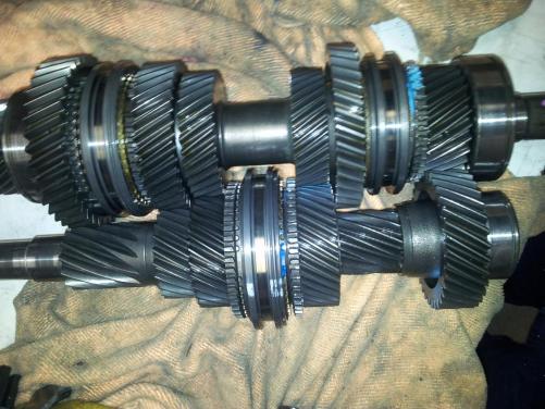

TRD ke70 Posted October 9, 2012 Author Report Posted October 9, 2012 Six speed box is now in bits. Quote
love ke70 Posted October 10, 2012 Report Posted October 10, 2012 why? new gear set? you could not have possibly killed it already... Quote
TRD ke70 Posted October 10, 2012 Author Report Posted October 10, 2012 Yeah, we're replacing 1st and second gear, too short for the rally car. Only problem is Alburns have a 18 month wait, so we're looking around for someone else. Quote
kickn5k Posted October 10, 2012 Report Posted October 10, 2012 Yeah, we're replacing 1st and second gear, too short for the rally car. Only problem is Alburns have a 18 month wait, so we're looking around for someone else. Modena engineering in Vic should be able to make something for you. Quote
snot35 Posted October 11, 2012 Report Posted October 11, 2012 Pfitzner in Adelaide does gear cutting too. Quote
TRD ke70 Posted October 11, 2012 Author Report Posted October 11, 2012 We found Par in Sydney, think that's what their called. Quite cheap too and have done J160 gears before as well. But thanks for the suggestions guys.. Quote
