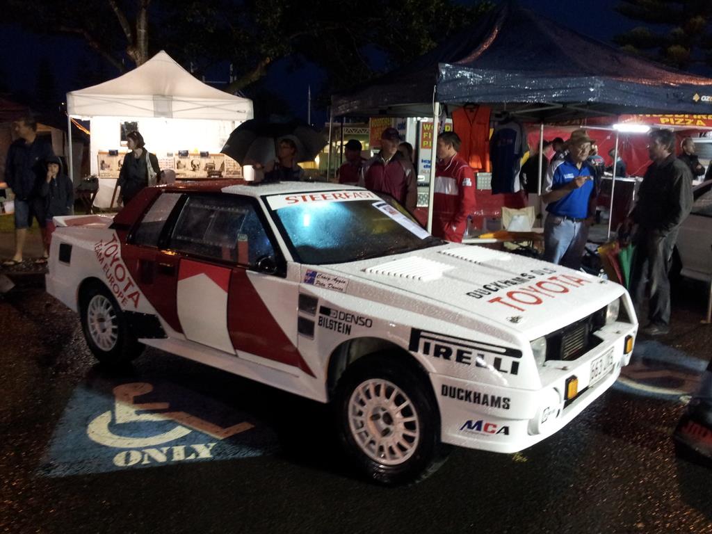

TRD ke70 Posted June 18, 2012 Author Report Posted June 18, 2012 Didn't really expect to see this on the entry list for this weekends rally sprint. Quote
