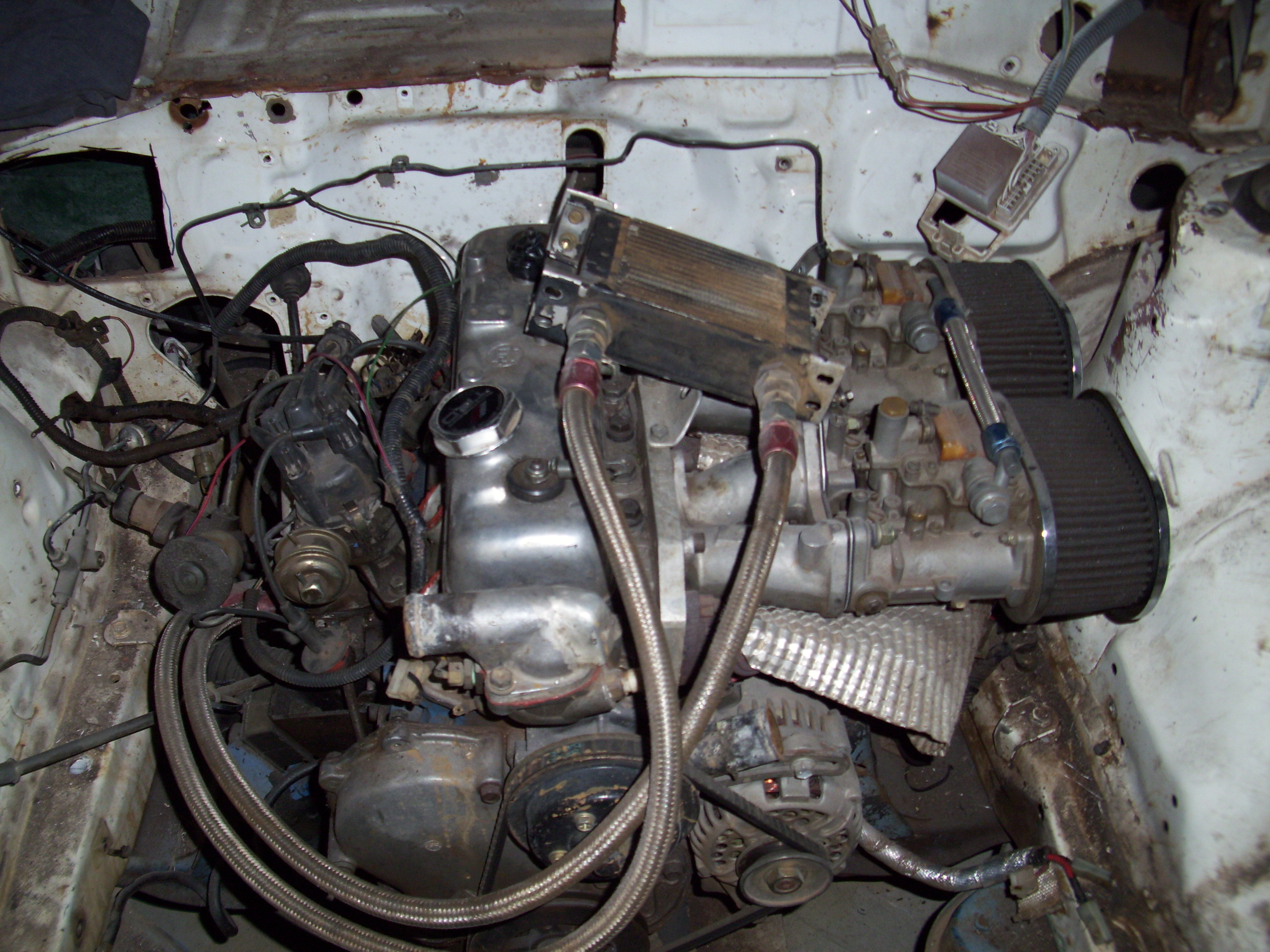

TRD ke70 Posted January 25, 2010 Author Report Posted January 25, 2010 (edited) The old TRD K uprite got started for the last time today, It will now be removed and stored. We've decided that we won't pull it apart as we may put it back in if we go classic racing. F**K it still sounded so strong. For both Tony and I, it's bitter sweet, that engine and car won a lot, both in outright placings and class wins. It gave us the QRC (queensland rally championship) 1600cc in 2005, a few third placings, but the most memorable for us was Urbanville 2007 when it got 2nd outright in an event that clearly suited more powerful cars, and had even had a stage win. We had no idea that we had got 2nd until the event was over. Here the link to the write up: Urbanville 2007 . For us it was amazing considering this was a 8 valve push rod engine of less than 1600cc. It will be missed. Anyhow, we will now see if the 4AGE can deliver the goods. Hopefully i'll put some more pic's up tomorrow. Edited January 25, 2010 by TRD ke70 Quote

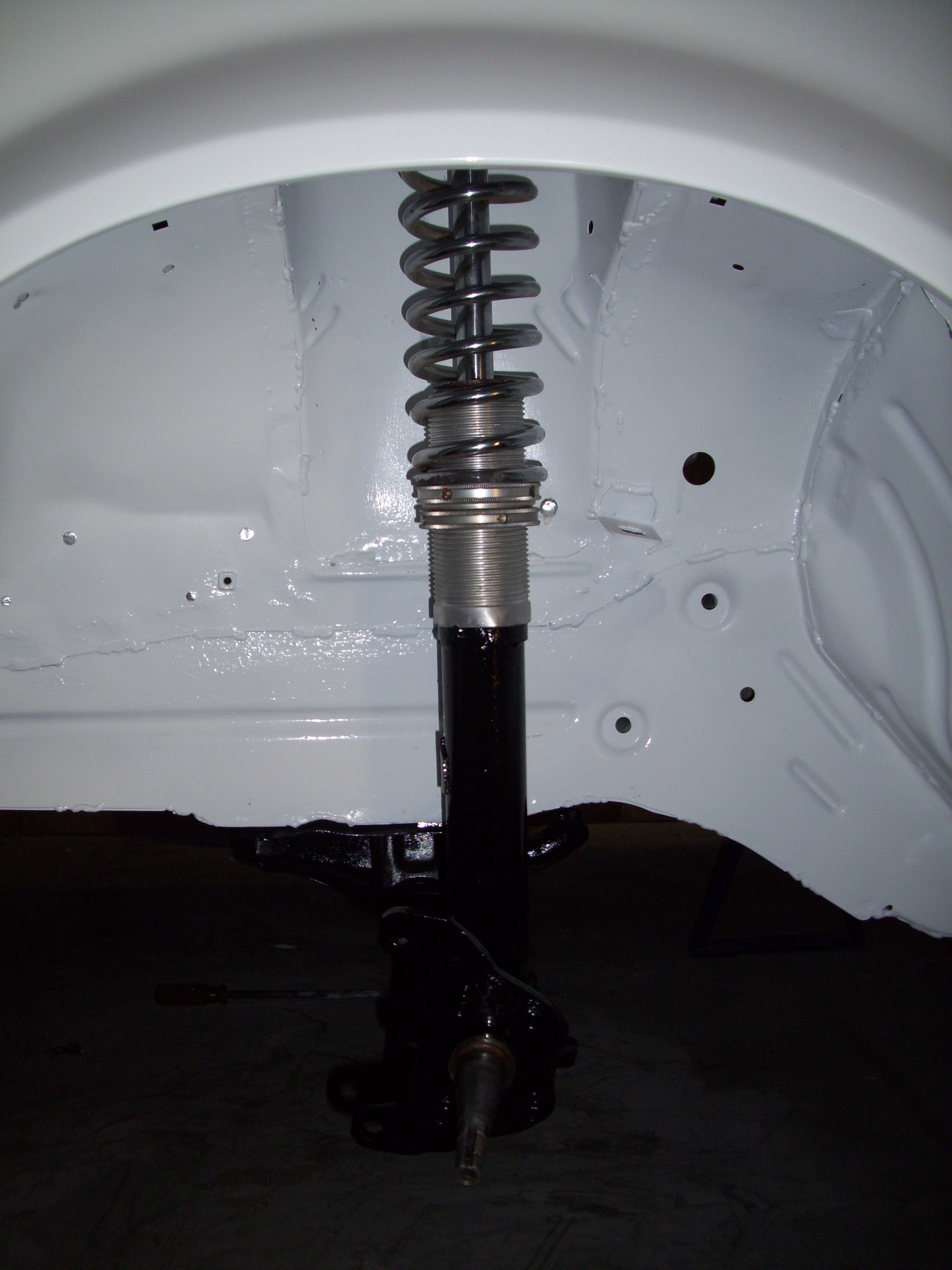

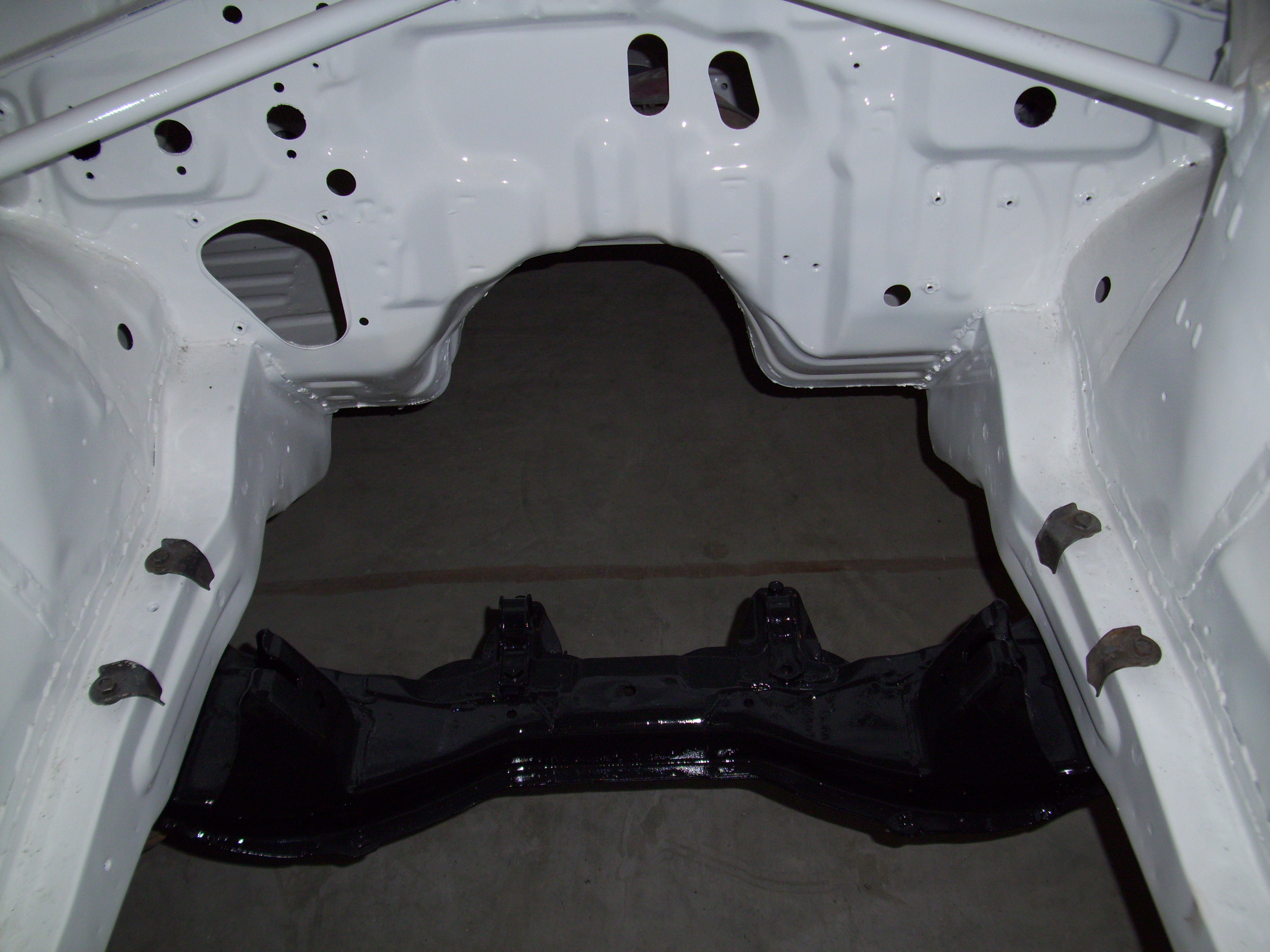

TRD ke70 Posted January 26, 2010 Author Report Posted January 26, 2010 Here's a few pic's from today, progress isn't exactly fast at the moment, as we have to dismantle everything as we go to make sure there's no damage to any parts. The last body panels finally got painted to day, so that's it for the panel work, thank god. Struts stripped cleaned and painted. New x member. The old Uprite ready to be removed. Quote

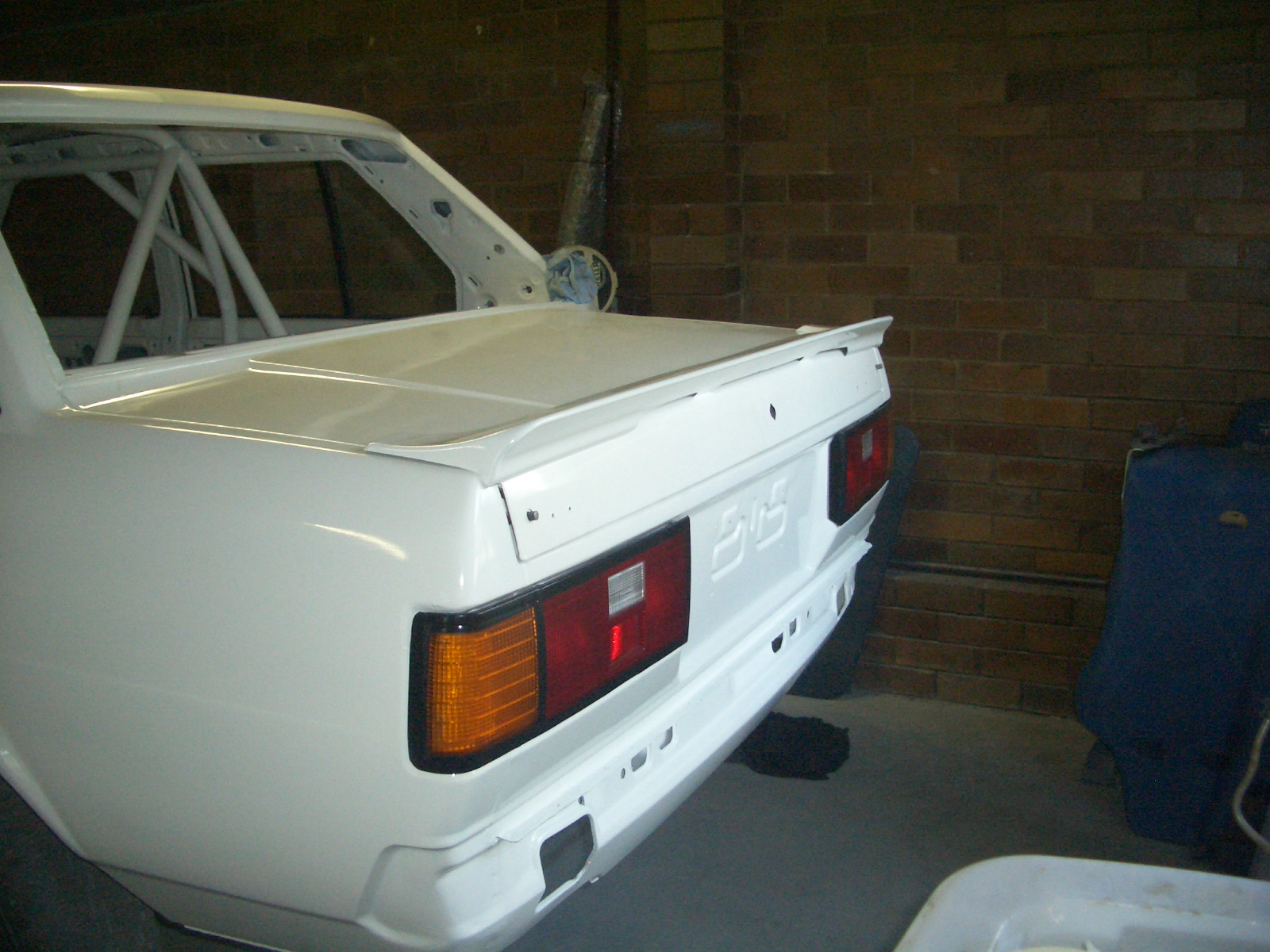

TRD ke70 Posted February 12, 2010 Author Report Posted February 12, 2010 No, not at this stage!! And what do you mean by ugly mug? :) The S2000 hasn't been touched since the WRC and i don't think he has any plans for events this year. On the corolla front, if we get close to finishing the car, we had plans to test it at Hirstglen before doing a rally. The idea is, it's a short track so if there's any problems we find them quickly. But at this stage i think it'll be the end of the year now, tony has decided to re-wire to whole car because he thinks there's to much weight in the wiring loom. New genuine spirit rear wing arrived this week too, so that will get painted this weekend and fitted. Stripping the old rally car as well so we can get on to the rest of the suspension. Quote

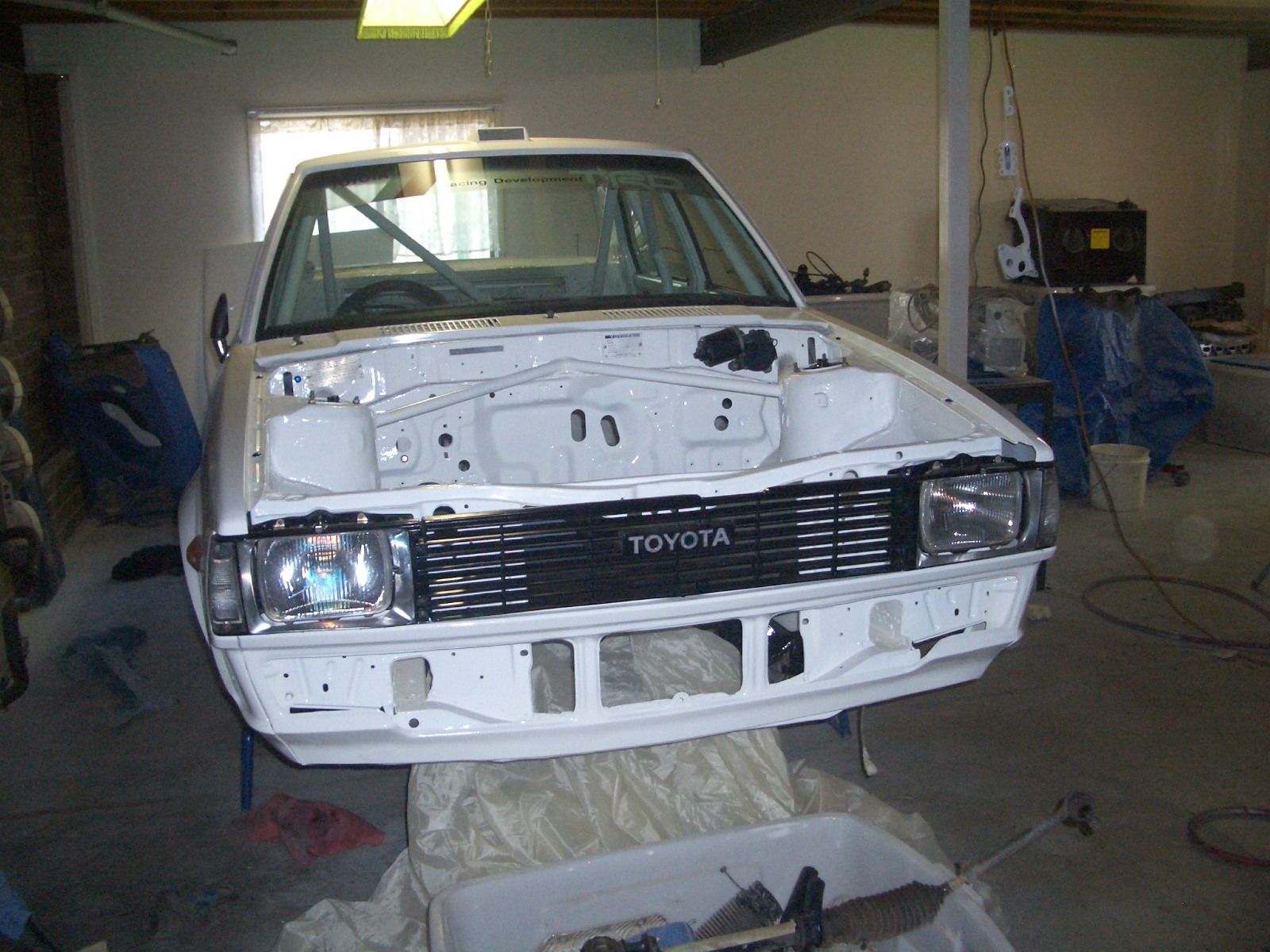

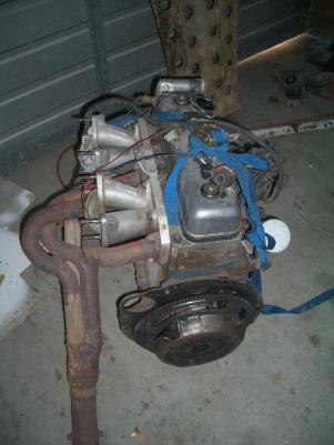

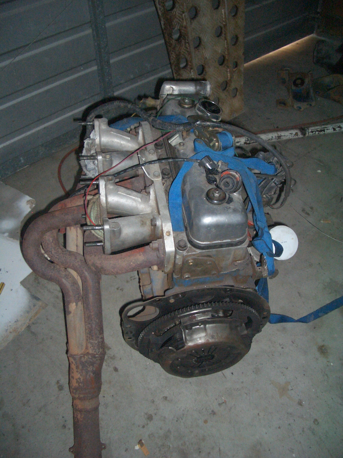

TRD ke70 Posted February 13, 2010 Author Report Posted February 13, 2010 Today we removed the old engine, gearbox and a host of other things from the old shell. Hope to take the shell to Sims metal on Monday,= more room in the garage!!! :) Painted the new spoiler,and fitted that to the car, also fitted all the grill and headlights after cleaning them up. Tony has been working on the front suspension, just cleaning, welding and painting. The new spoiler. Grill all cleaned and fitted. The old engine ready to be clean and laid to rest Quote
Taz_Rx Posted February 15, 2010 Report Posted February 15, 2010 That looks like one very light flywheel!!! Whats happening to this old motor? Quote
