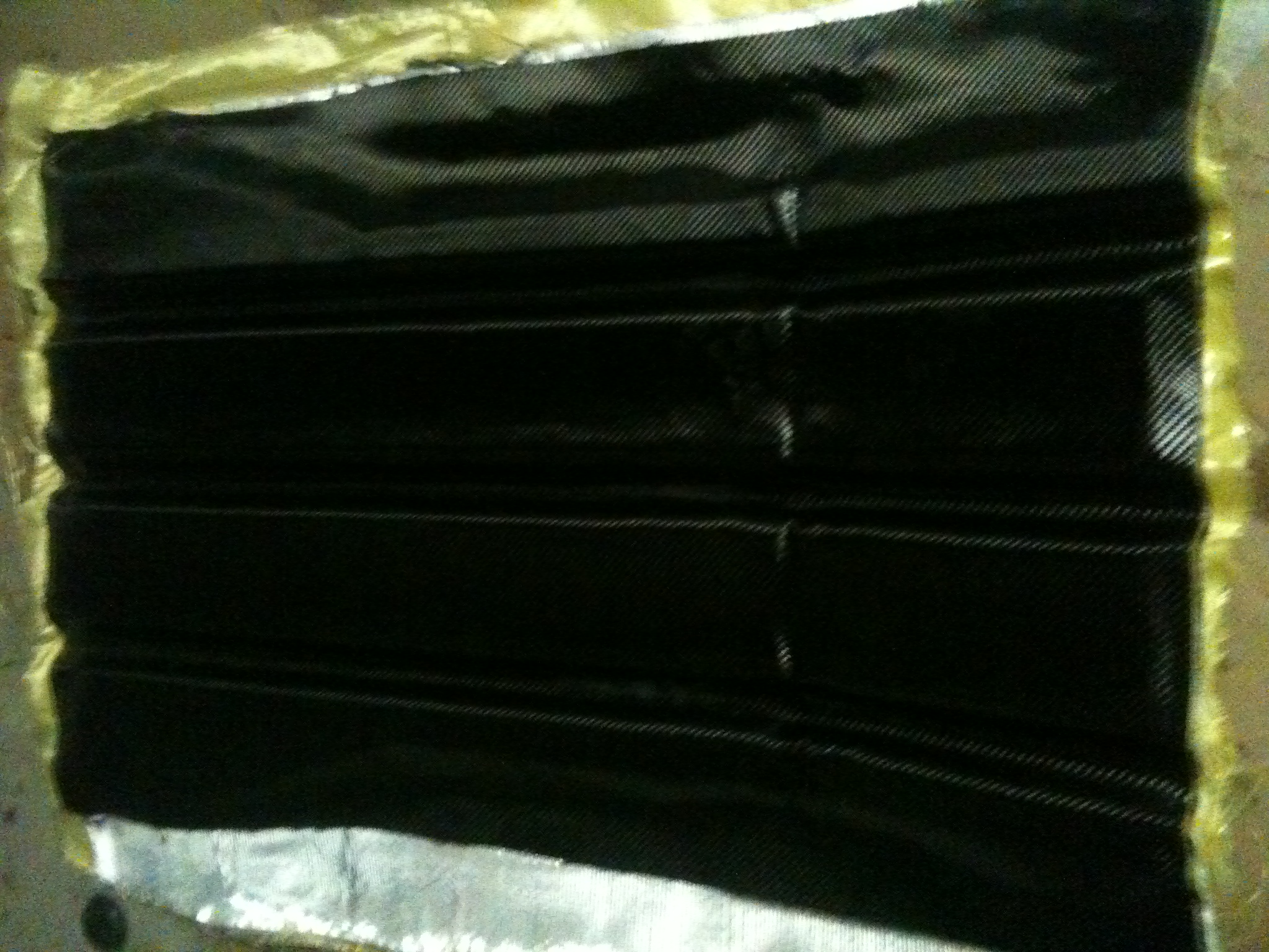

trd Posted December 19, 2011 Report Posted December 19, 2011 Just a update. Been working on getting some more weight out of the car. Mainly the bonnet. Heres the new frame i just pulled out of the mould tonight. Also had the bearings turn up and the new Toyota crank. Quote

towe001 Posted December 19, 2011 Report Posted December 19, 2011 Was the bonnet frame vacuum formed ? How many layers of the chopped 'glass did you use ? I'd be thinking you wouldn't have used that many cause the garage door can be seen through the 'glass. Wicked cool but. Quote
trd Posted December 19, 2011 Report Posted December 19, 2011 Not that hard to do, but if your a first timer at it start with something small. Youtube has some good video's on how its done. The frame is only 1 layer and no gelcoat, the bonnet skin is going to be 2 layers with the frame put on last or between the 2. Not sure yet. Should be very light Quote
carbonboy Posted December 20, 2011 Report Posted December 20, 2011 Nice work :y: , I should've done something similar to this with my bonnet! Instead I just incorporated unidirectionals into the skin layup for the extra stiffness. Quote
