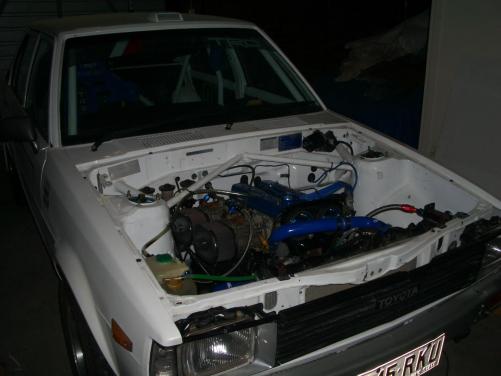

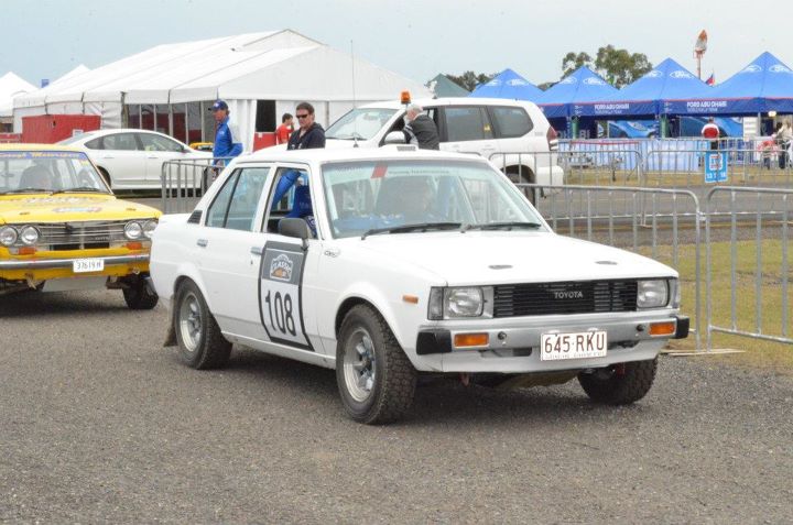

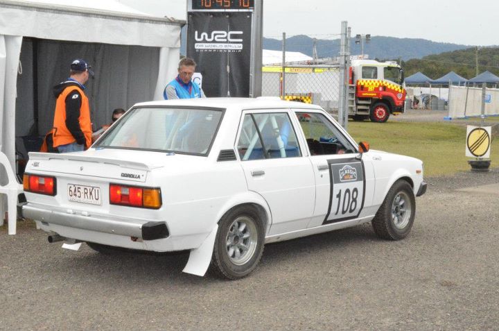

TRD ke70 Posted November 7, 2011 Author Report Posted November 7, 2011 New engine was started in the weekend and sounds good, so hopefully we can get it onto the Dyno this weekend to run it in. The Corolla at the WRC 2011 Quote

snot35 Posted November 8, 2011 Report Posted November 8, 2011 I like! What size tyres are you running on it? Quote

TRD ke70 Posted November 10, 2011 Author Report Posted November 10, 2011 I know they look big those tyres, they are only 195's on a 13 x 6 rim. Nice Vid jimi. I'm hoping to get some in car in a couple of weeks if all goes well. Quote

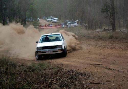

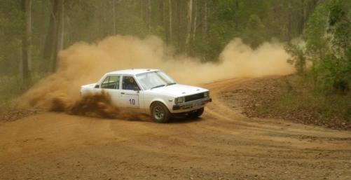

TRD ke70 Posted November 28, 2011 Author Report Posted November 28, 2011 Well not a very good weekend for us again. We seam to had a small problem with the bottom end, we did however manage to complete 4 stages before the engine cried enough. The car feels fast, Tony tells me, and he was running 5th outright before the engine problems. Here's a little bit of video, thanks to Annette Ross, and a photo, again thanks to Annette. http://www.youtube.com/watch?v=rMXGra2YO0s Quote
Evan G Posted November 28, 2011 Report Posted November 28, 2011 (edited) did the bottom end make the "tunk tunk tunk tunk" noise or the "tink tink tink tink TUNKTUNKTUNKPOPZZZZZZZZZZZZZZZZCLUNKCLUNKCLUNK" edit - jesus that engine sounds MEAN! Edited November 28, 2011 by Evan G Quote
SLO-030 Posted November 28, 2011 Report Posted November 28, 2011 Engine sounds wicked! Any idea whats up with the bottom end. Sounds like she's possessed. Quote
TRD ke70 Posted November 28, 2011 Author Report Posted November 28, 2011 Not really sure yet, need to mic it up and see whats what. Starting to think that the shaft was re-ground wrong, generally we don't use re-ground shafts in rally cars as they have been known to cause problems. Quote
