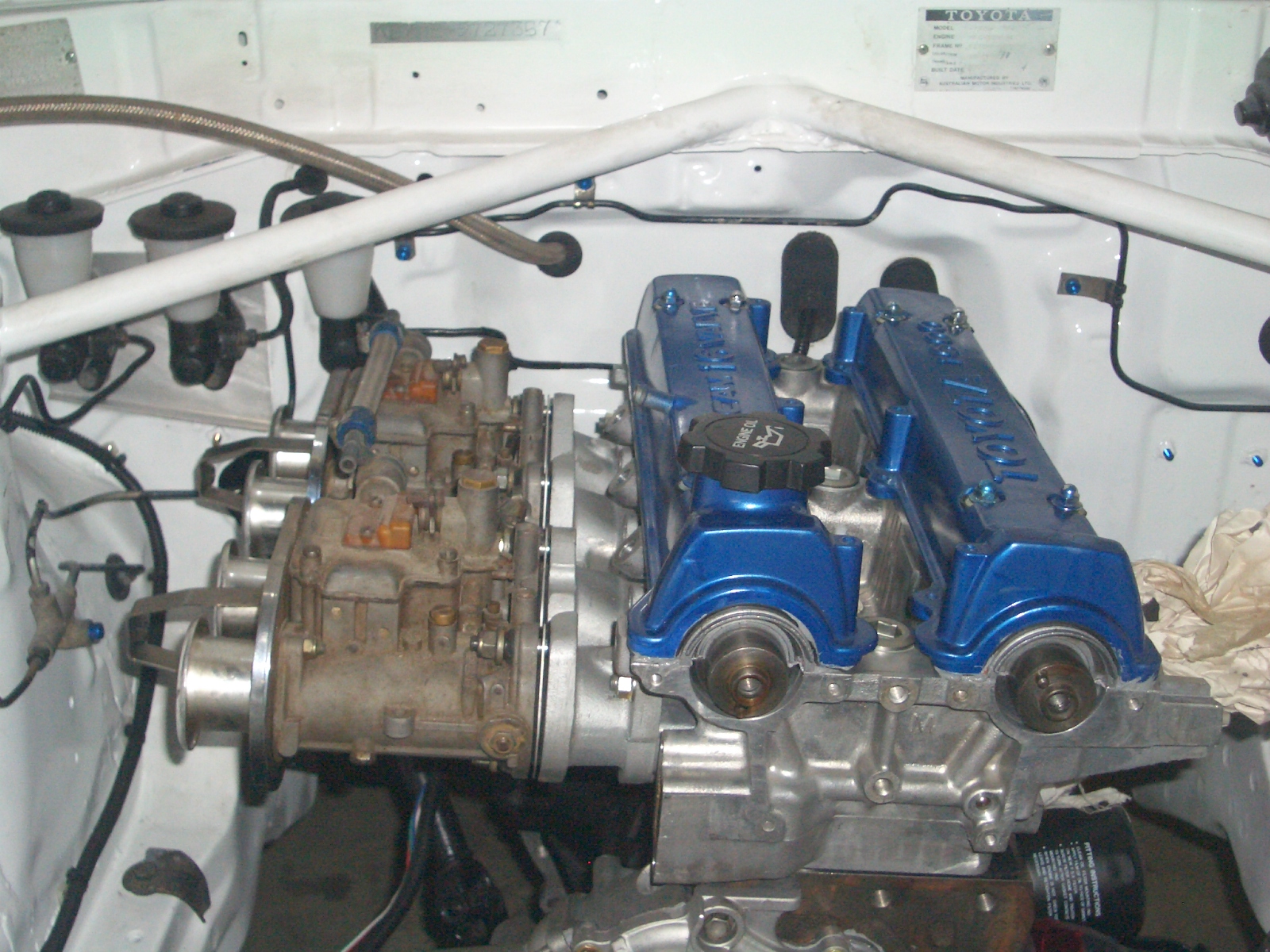

TRD ke70 Posted September 26, 2010 Author Report Posted September 26, 2010 (edited) Good week for getting stuff done. Head came back from the machinist, so it's now fitted. So Tony has started with bolting the manifolds up while I spend today fabricating the box for the fuel tank bowl and fuel pump to sit into. If all goes well, we should start to see the engine been slowly stitched together over the next couple of weeks. Edited September 26, 2010 by TRD ke70 Quote
jimi91 Posted September 26, 2010 Report Posted September 26, 2010 Good week for getting stuff done. Head came back from the machinist, so it's now fitted. So Tony has started with bolting the manifolds up while I spend today fabricating the bowl for the fuel tank bowl and fuel to sit into. If all goes well, we should start to see the engine been slowly stitched together over the next couple of weeks. thats looks sweet mate with the webbers and will sound great lol :lolcry: that will be good if ya get it started soon keep it up mate see ya jimi Quote
TRD ke70 Posted September 26, 2010 Author Report Posted September 26, 2010 Thanks Jimi. The engine guy flow tested the head, and he did say that she will be a howler. :rolls: Apparently it was howling on the flow bench. :yes: Quote
jimi91 Posted September 26, 2010 Report Posted September 26, 2010 hahhaa thats ok mate ooooo sounds good i can't wait i just want to fly or drive up to u just to see it in flesh and listen to it lol maybe even do an event up there if ive got ours going lol :lolcry: see ya jimi Quote
