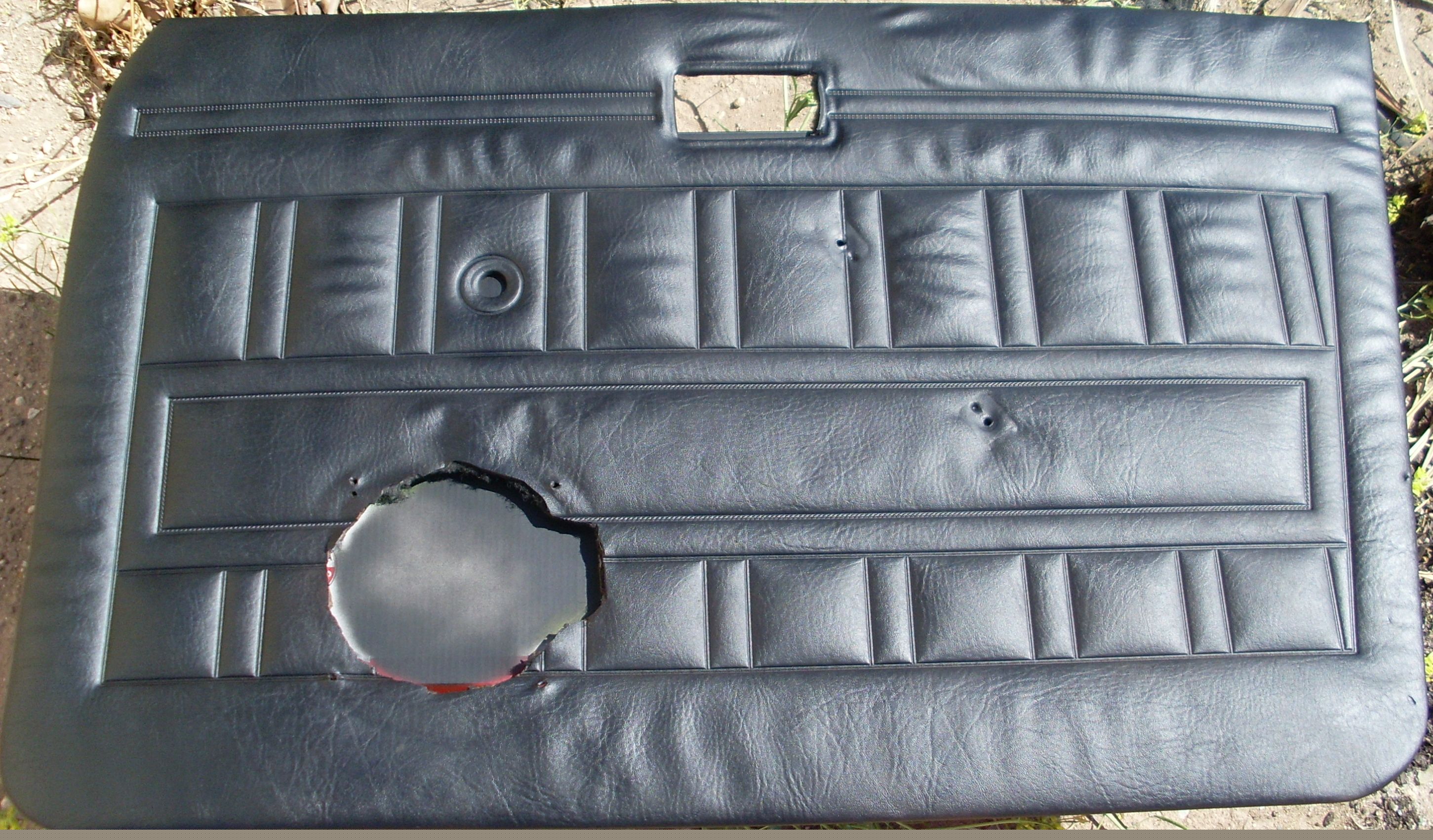

lildvl83 Posted March 31, 2009 Author Report Posted March 31, 2009 finally got the rolla back today YAAAAYYY!!!! omg it drives sooo much better. i managed to get a good door trim from toyoland aswell, so pulled off an old one and sprayed it black as a tester before doing all of them. still got to get a good trim for the drivers door, u pull it has like 2 or 3 ke30s atm none with door trims, and toyoland only had the one good one :-( heres a piccy of the practice door trim Quote
