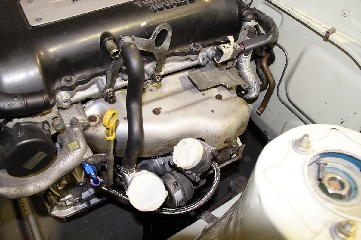

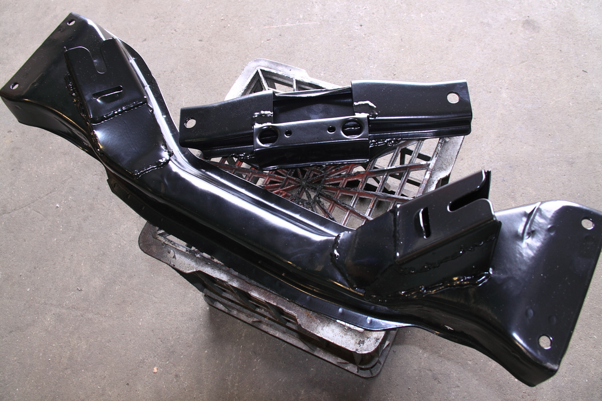

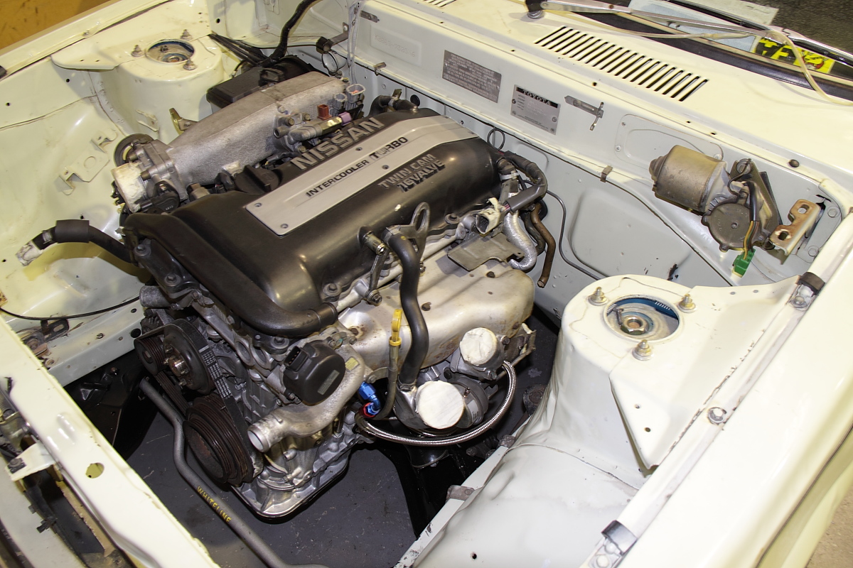

chestikoph1 Posted March 19, 2010 Author Report Posted March 19, 2010 Well another week passes and some more work done. I got the crossmember and gearbox mount back from the powder coaters today. Covers up my ugly welding well. Put the engine back in the car for the third time now!! Hopefully for the last time, although i have feeling it may need to come out one more time, i may need to massage the tunnel slightly towards the back of the box. Also started to connect the heater hoses, what a pain in the ass it has turned out to be. The outlets on the SR are 3/4 inch, and the outlet on the heater are only 1/2 inch and are right behind the head, bloody awkward. So i cut the outlets off and reversed them so they point down, and i will have to get a couple of reducers. Gave the engine bay a bit of a clean before i put it in. :) Quote

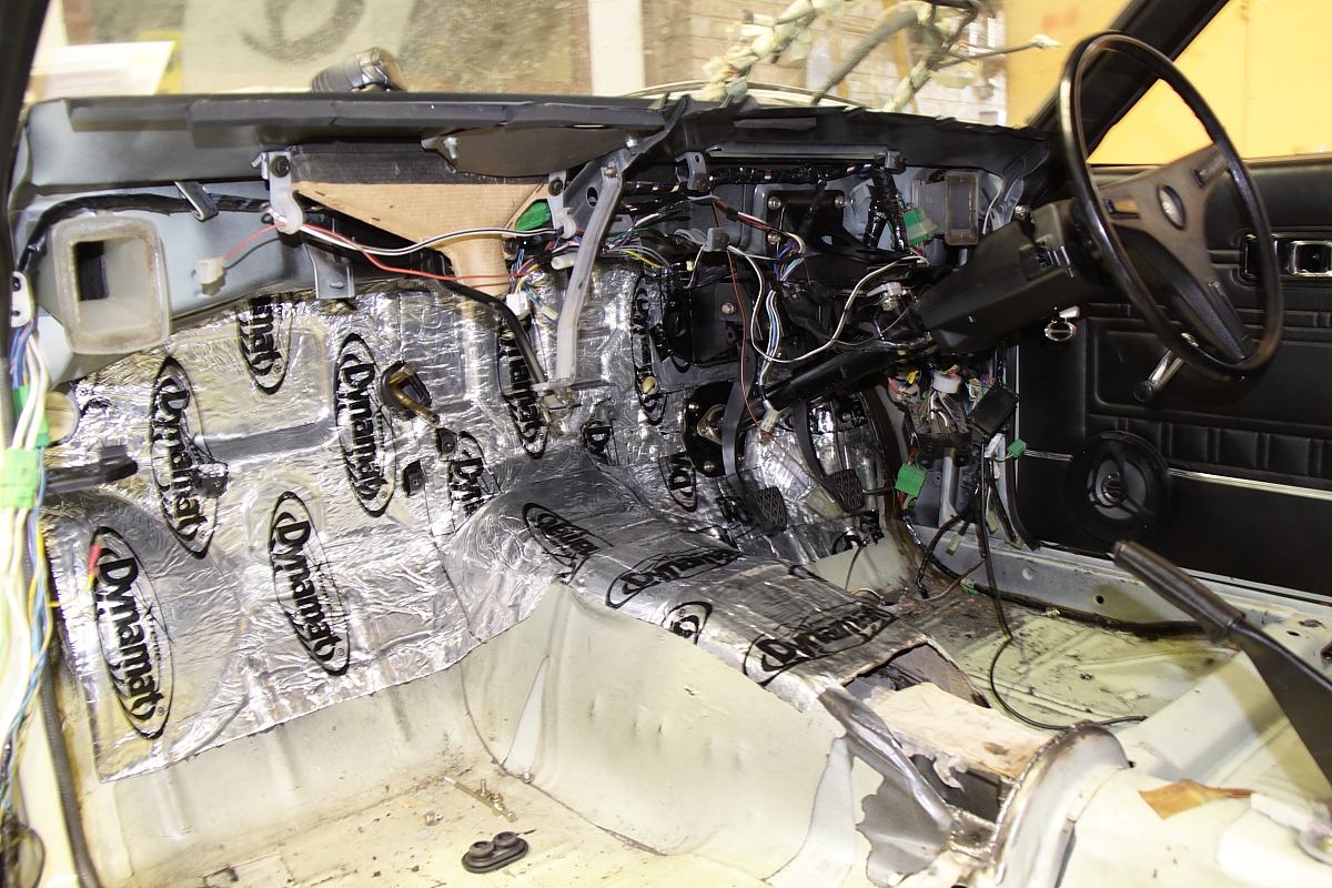

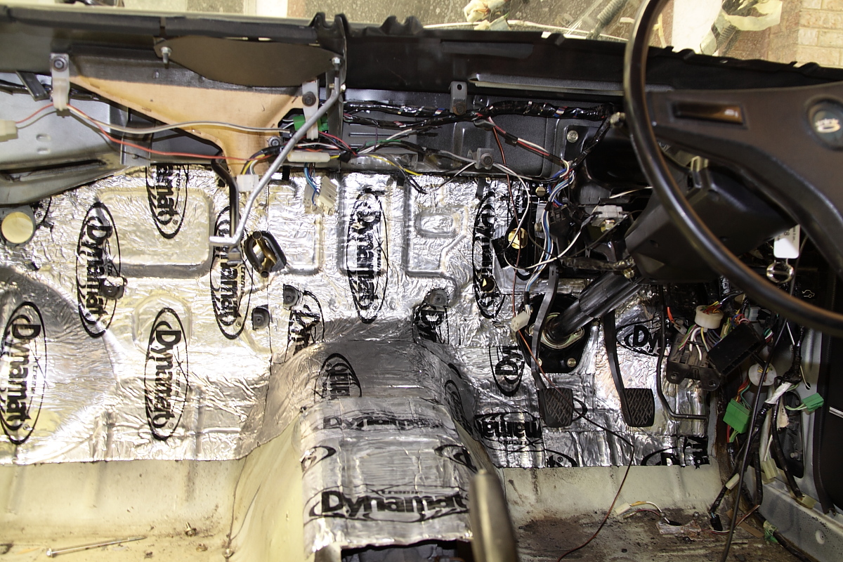

chestikoph1 Posted April 10, 2010 Author Report Posted April 10, 2010 Have made a start on the inside of the car, ripped out the old sound deadening off the inside of the firewall and stuck on some dynamat. I want the cabin to be nice and quiet. This stuff is great, easy to apply and it moulds well into all the undulations. 1 Quote

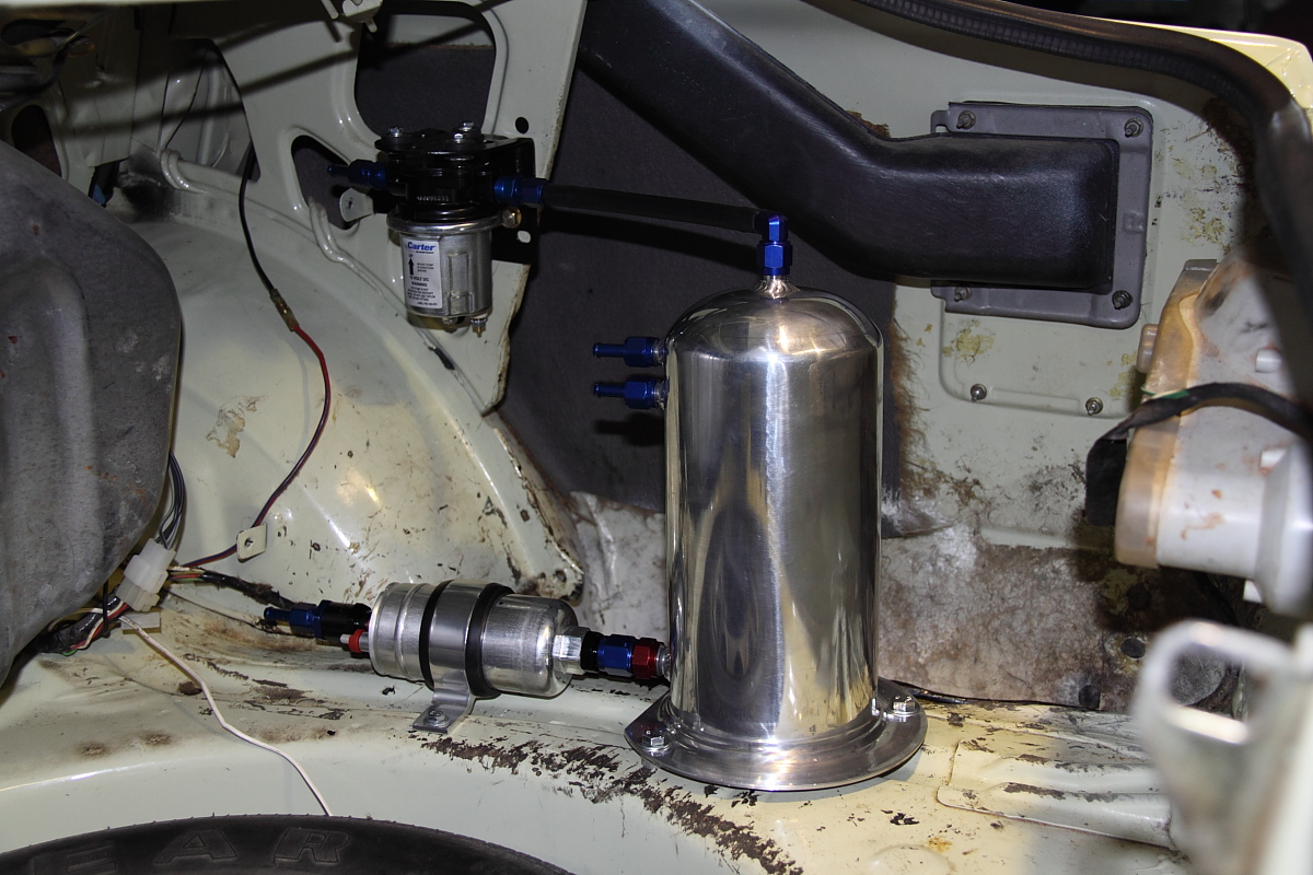

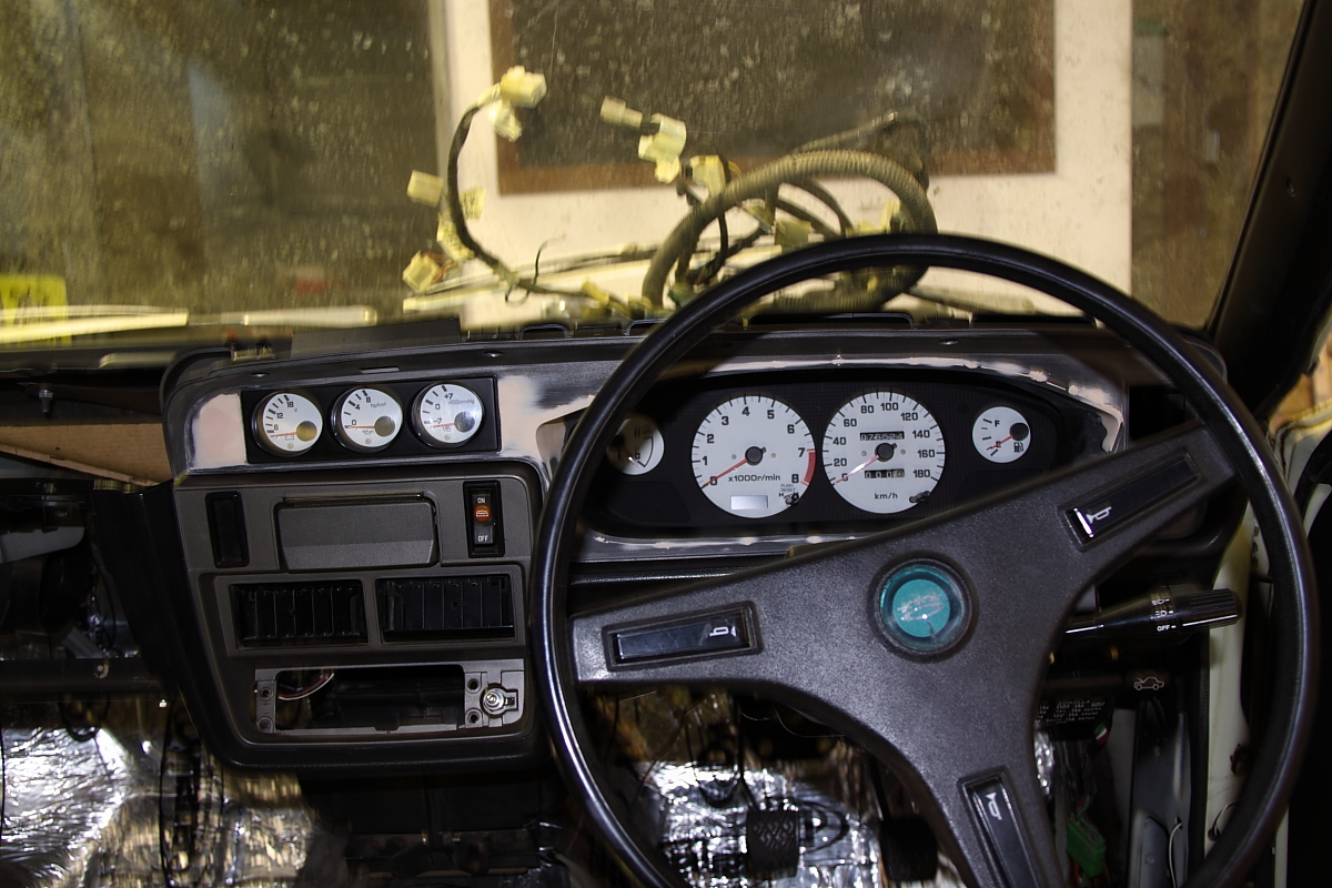

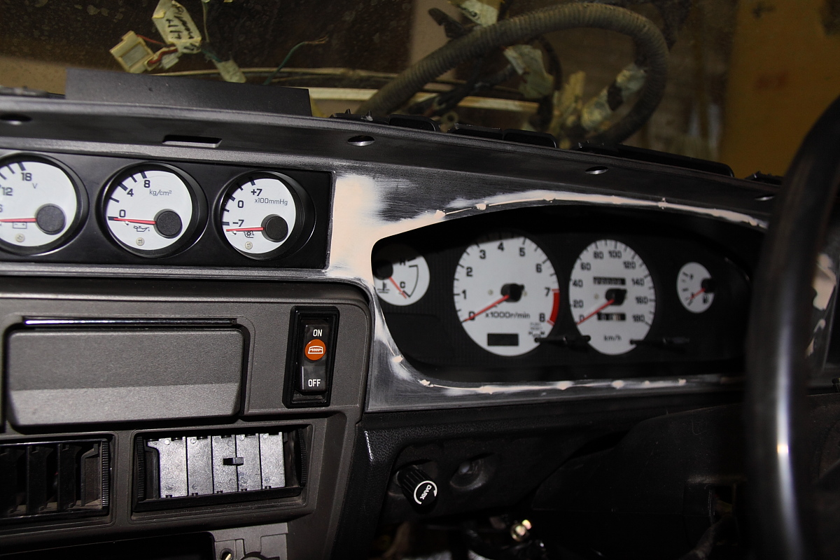

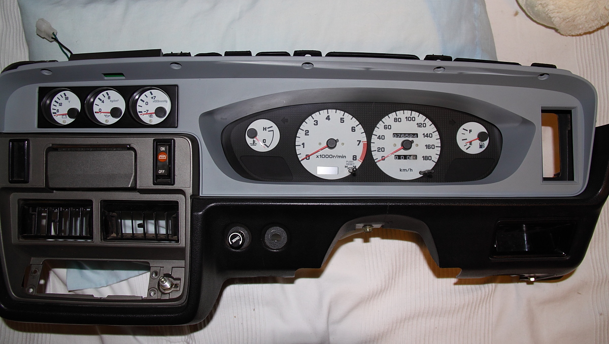

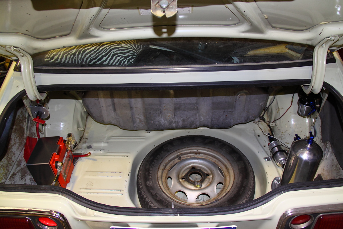

chestikoph1 Posted April 17, 2010 Author Report Posted April 17, 2010 (edited) More progress lately, got the surge tank nearly finished. Just waiting on some efi fuel clamps to finish it off. Also the dash is coming along nicely. Going to get rid of the ash tray and put in another couple gauges, boost gauge ( one that reads more than 7psi :jamie: ) and air/fuel ratio gauge. I don't get why more people don't run air/fuel ratio gauges, often your first warning that your starting to run lean especially when running higher boost and factory tune. Noisy exhaust, loud stereo and your not going to hear pinging. Edited April 17, 2010 by chestikoph1 Quote

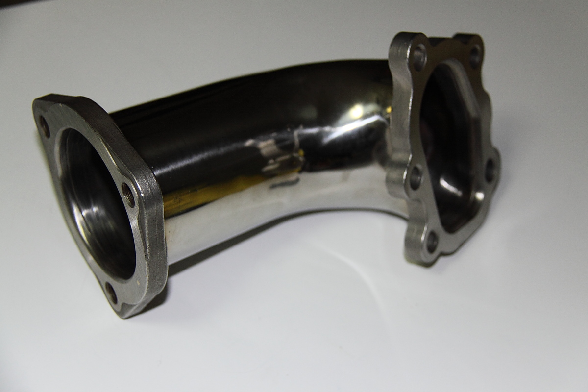

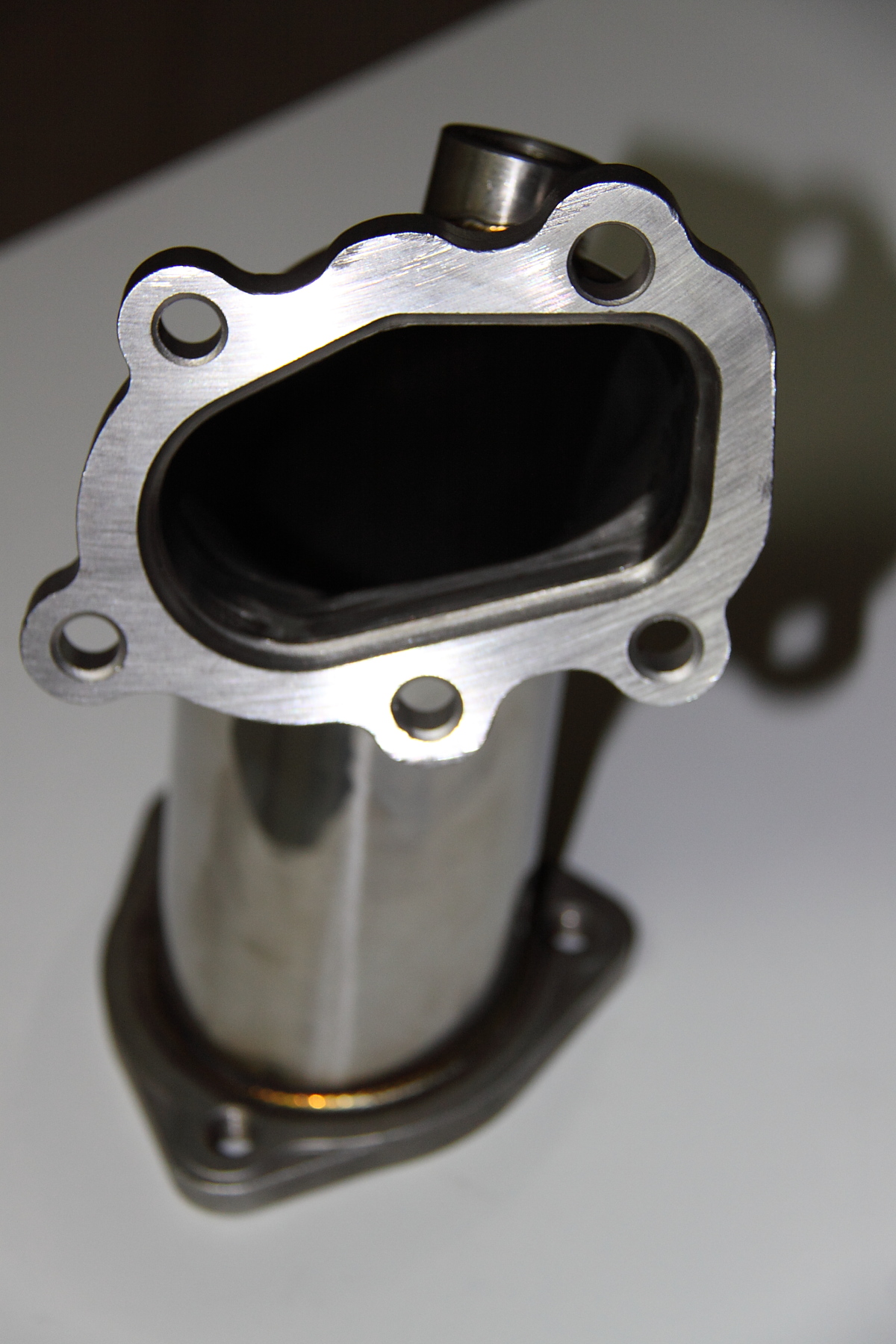

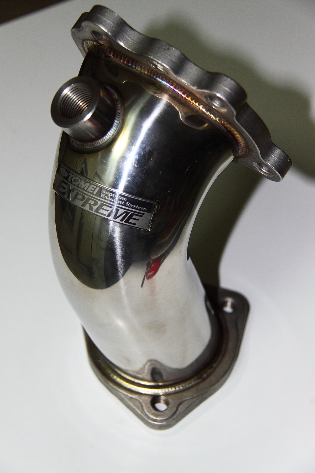

chestikoph1 Posted April 21, 2010 Author Report Posted April 21, 2010 Got this from japan in the mail the other day. 3" Tomei stainless dump pipe Neatest bit of welding i have ever seen, must have been done by a machine. Quote
ke70dave Posted April 22, 2010 Report Posted April 22, 2010 man i love the dash! thats a great job. great build you have here, ive not seen it before. sr20 in a ke55 is gonna be a bit mental i think. Quote
JDM55 Posted April 26, 2010 Report Posted April 26, 2010 nice dump pipe there, question:: how much clearance to the idler arm do you get with this one over stock? Quote
chestikoph1 Posted April 26, 2010 Author Report Posted April 26, 2010 nice dump pipe there, question:: how much clearance to the idler arm do you get with this one over stock? Thanks Mate, it wasn't cheap but definantly looks like an improvement over the stock one. It's almost identical to the factory one in size, the flange sits just to the side of the bottom of the idler arm about 10-15mm gap. The only thing is the angle of the bottom flange isn't the best, wont know until i bolt up the secondary to see if the secondary pipe hits. Take some better pics on the car when i get a chance if you want? Quote
JDM55 Posted April 27, 2010 Report Posted April 27, 2010 Yeah mate be good, my factory dumper sitts very close to the idler arm thingo just woundered if these ones were much different, nice build tho wish i was at that stage!! everything takes so dam long to do haha , Quote

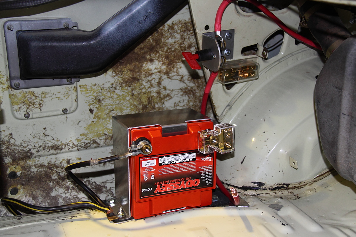

chestikoph1 Posted May 1, 2010 Author Report Posted May 1, 2010 One small step closer to start up. Starter motor and alternator wired up Quote
chestikoph1 Posted May 11, 2010 Author Report Posted May 11, 2010 Hi guys, What do you reckon? Should look better when its all painted black. Quote
