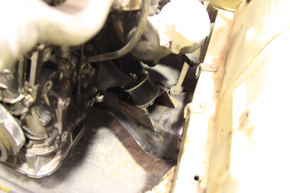

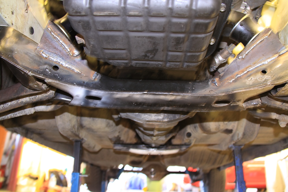

chestikoph1 Posted February 9, 2010 Author Report Posted February 9, 2010 Well, took a day off work and got some jobs done on the car. Cut the steel plates for the engine mounts ( my new favorite tool, plasma cutter, i like!!) and welded them in. Also did the gearbox mount, but need to redo it. The back end of the box is sitting too low and its making the engine tilt back too much towards the firewall. :) At least the engine not just sitting there on a piece of wood and i can remake the gearbox mount later. I have a couple more bits of plates to weld in under the tabs with holes in them. Quote

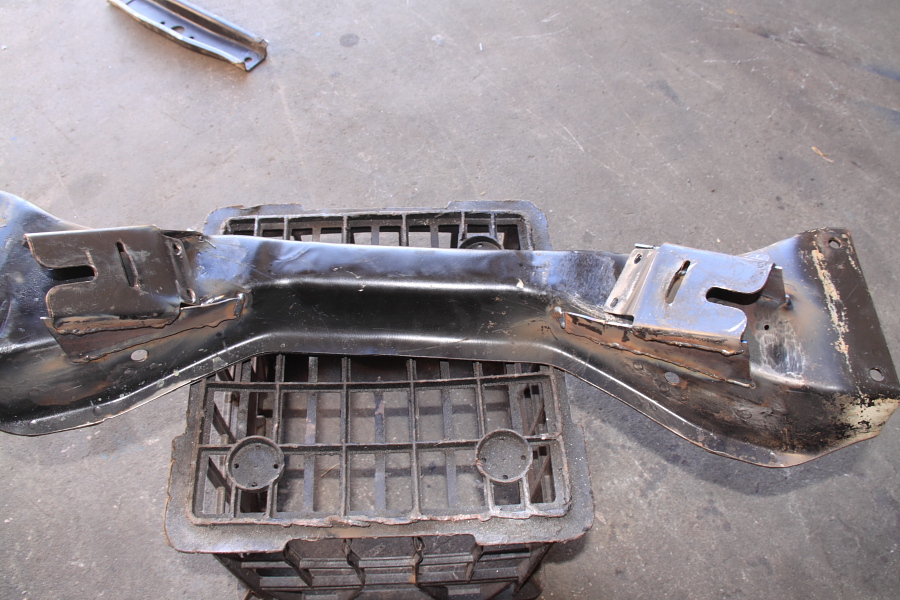

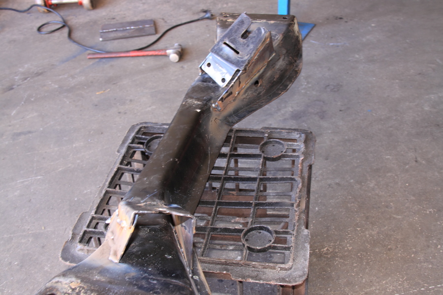

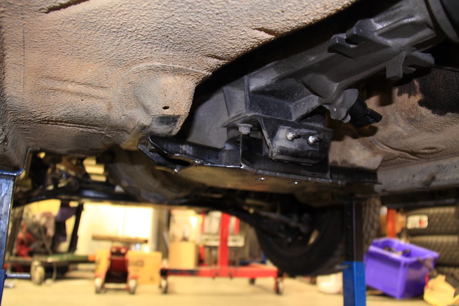

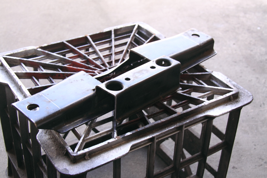

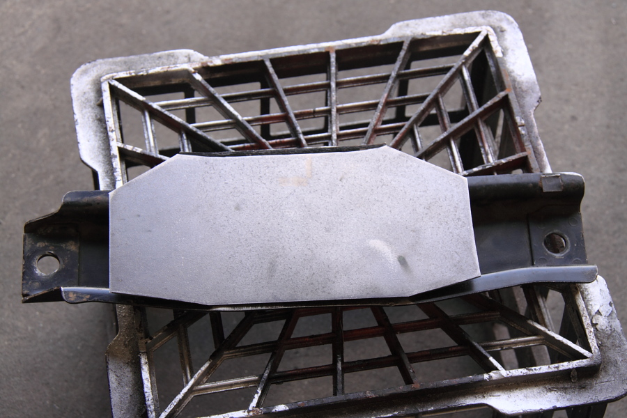

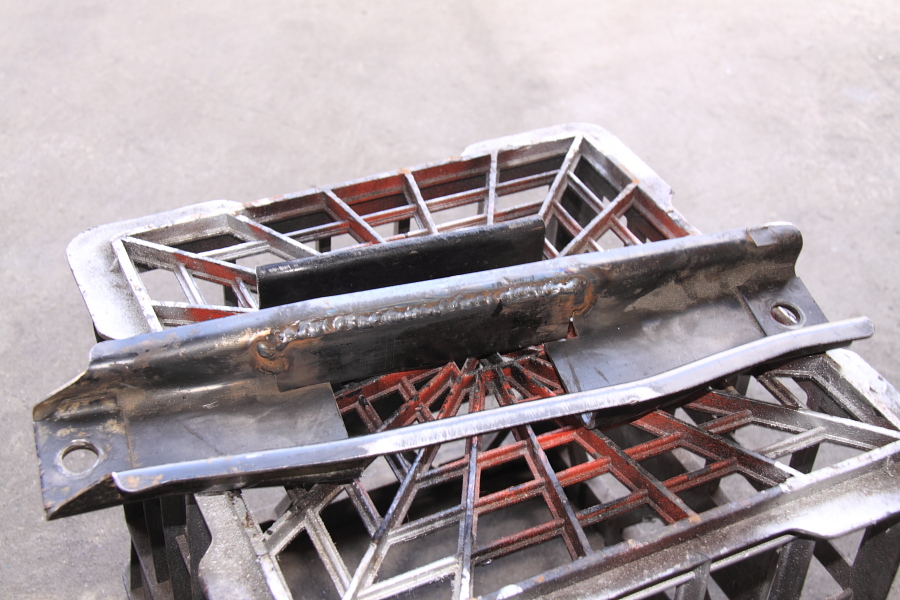

chestikoph1 Posted February 12, 2010 Author Report Posted February 12, 2010 Productive day today. Redid the gearbox mount, turned out really well, motor and gear box sitting in the car spot on. Mated the s14 mount to the ke55 mount, bolts up to the rear set of holes under the car. Welded a plate underneath to add strength. Finished product looks pretty standard, and super strong. Quote

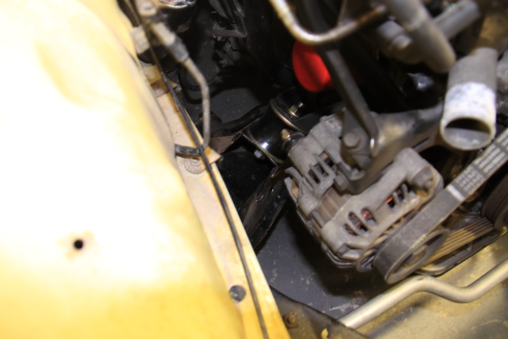

chestikoph1 Posted February 12, 2010 Author Report Posted February 12, 2010 Here's a few pictures of the crossmember and mounts in the car. Quote

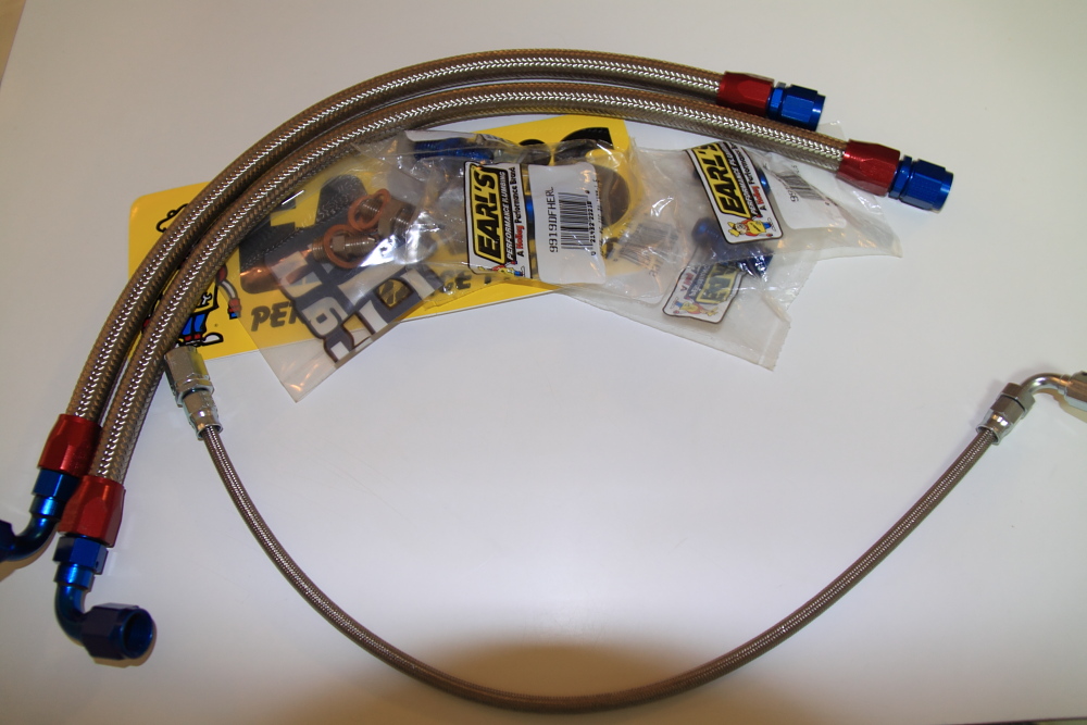

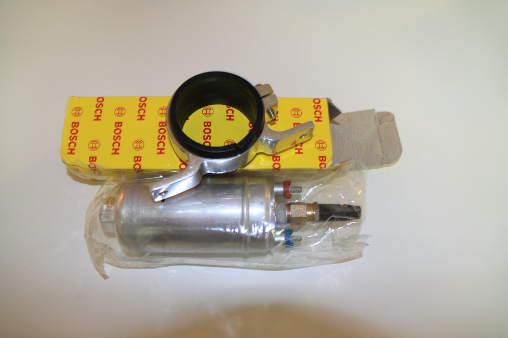

chestikoph1 Posted February 19, 2010 Author Report Posted February 19, 2010 "Slowly but surely" Got most of the hydraulic clutch conversion done today, i will post some pics up later in the week if any one wants to see how it was done. Not too hard, just time consuming. Also received some presents in the mail. Earls braided oil and water lines for the turbo Bosch high pressure pump and Bracket Hopefully i can take some time off mid week to get more done, at this pace it's gonna take months!! Quote

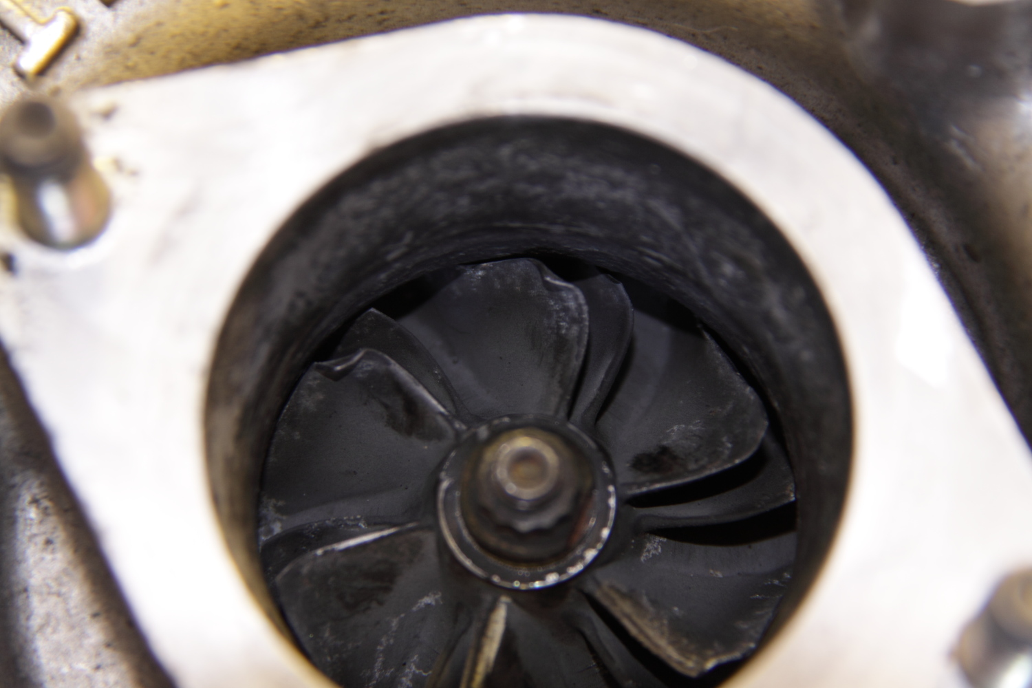

chestikoph1 Posted March 5, 2010 Author Report Posted March 5, 2010 Ahhhh so pissed off!!! Was starting to put on the braided turbo line kit onto the car today, pulled the inlet pipe off the compressor housing on the turbo and saw this. When i bought the front cut, i asked the guy "did you check the turbo for shaft play? He assured me yes it was all sweet. He obviously was full of shit, unless it sucked up a bit of crap when he started it for me, before i put it on the trailer. (highly unlikely) Any way, one turbo rebuild i didn't budget for coming up. Quote

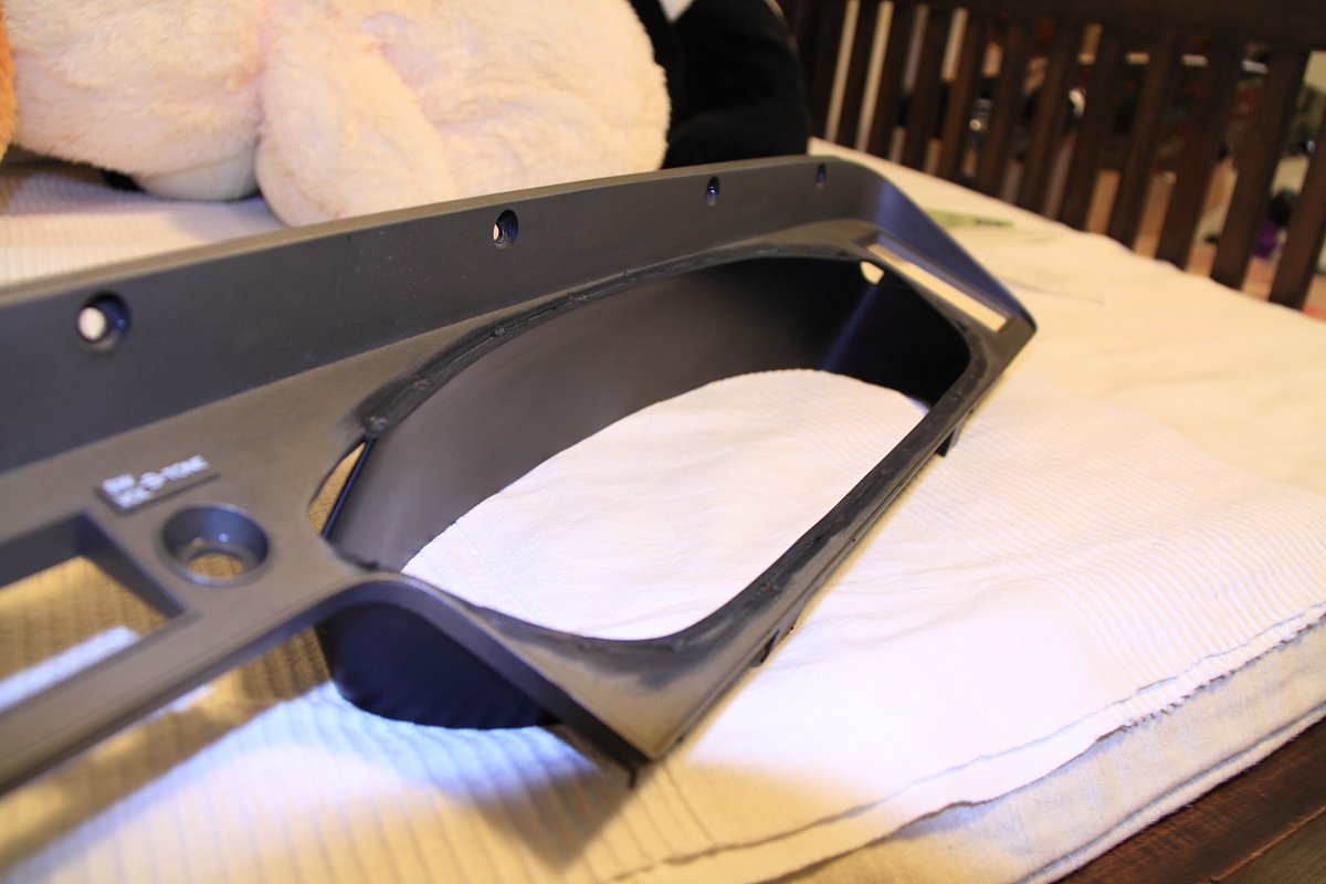

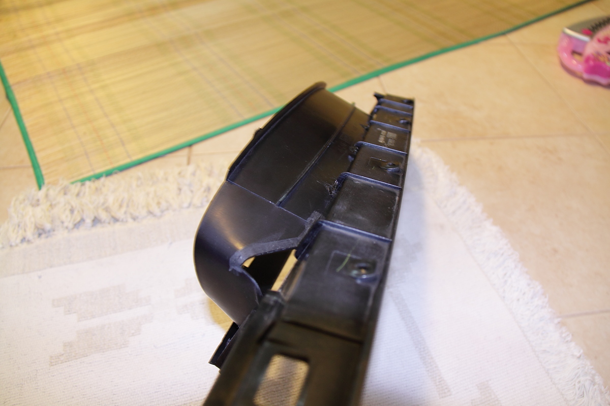

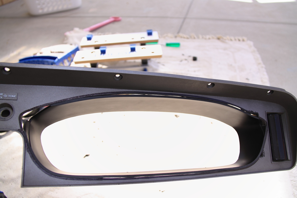

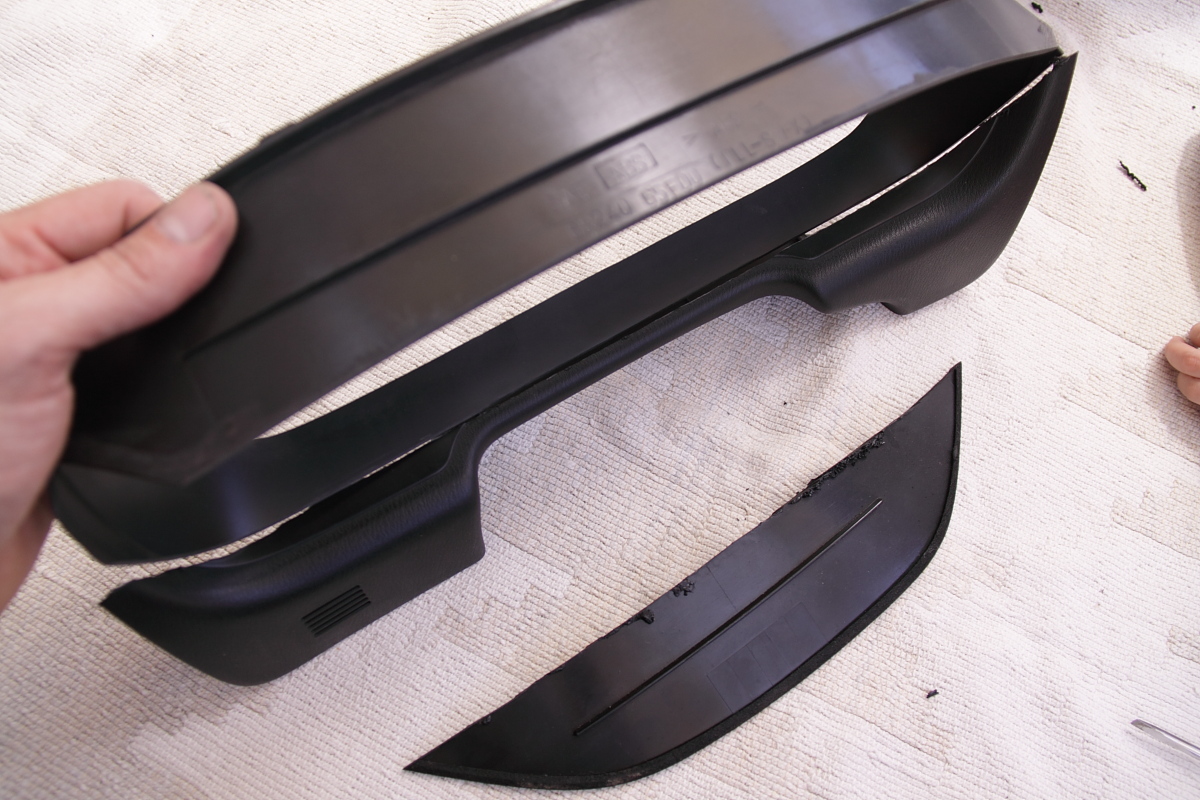

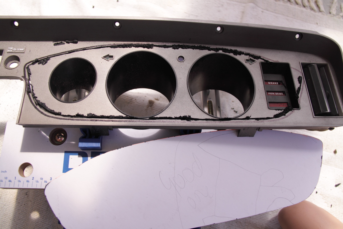

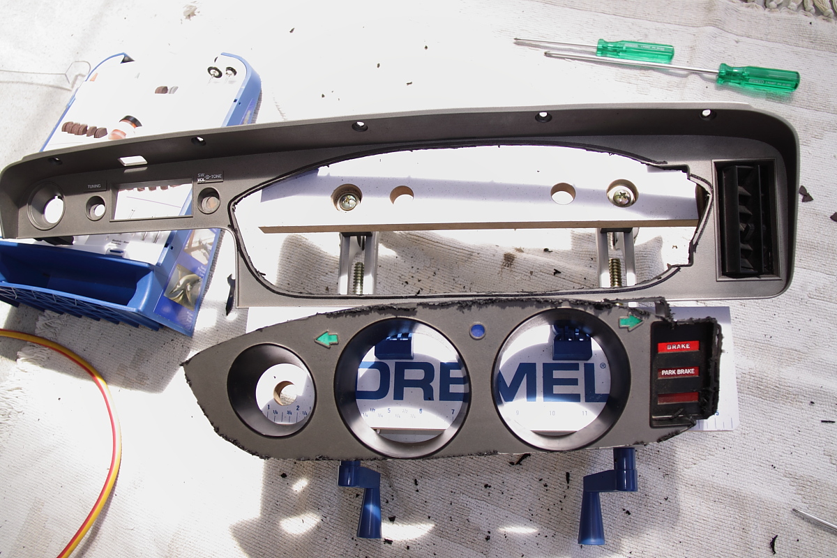

chestikoph1 Posted March 6, 2010 Author Report Posted March 6, 2010 On a brighter note, the dash conversion is coming along well, heres some pics. Cut off the ends of the 200sx dash shroud. Mark it out on the ke55 facia with a template. Cut it out it out using a dremel or air hacksaw, cut within the lines to leave some room to tidy it up. It should fit in there spot on. Weld it in place front. And back. More to come Quote

Taz_Rx Posted March 9, 2010 Report Posted March 9, 2010 Stock T25 and T28 turbo's aren't really worth re-building - You're looking at around $800+ to do it. For $200-$300 more you can get yourself a ball bearing GT series turbo like a GT28R, disco potato etc. Quote

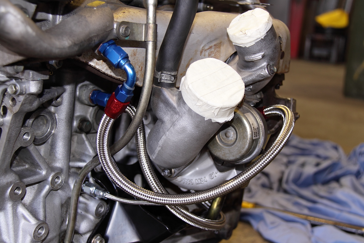

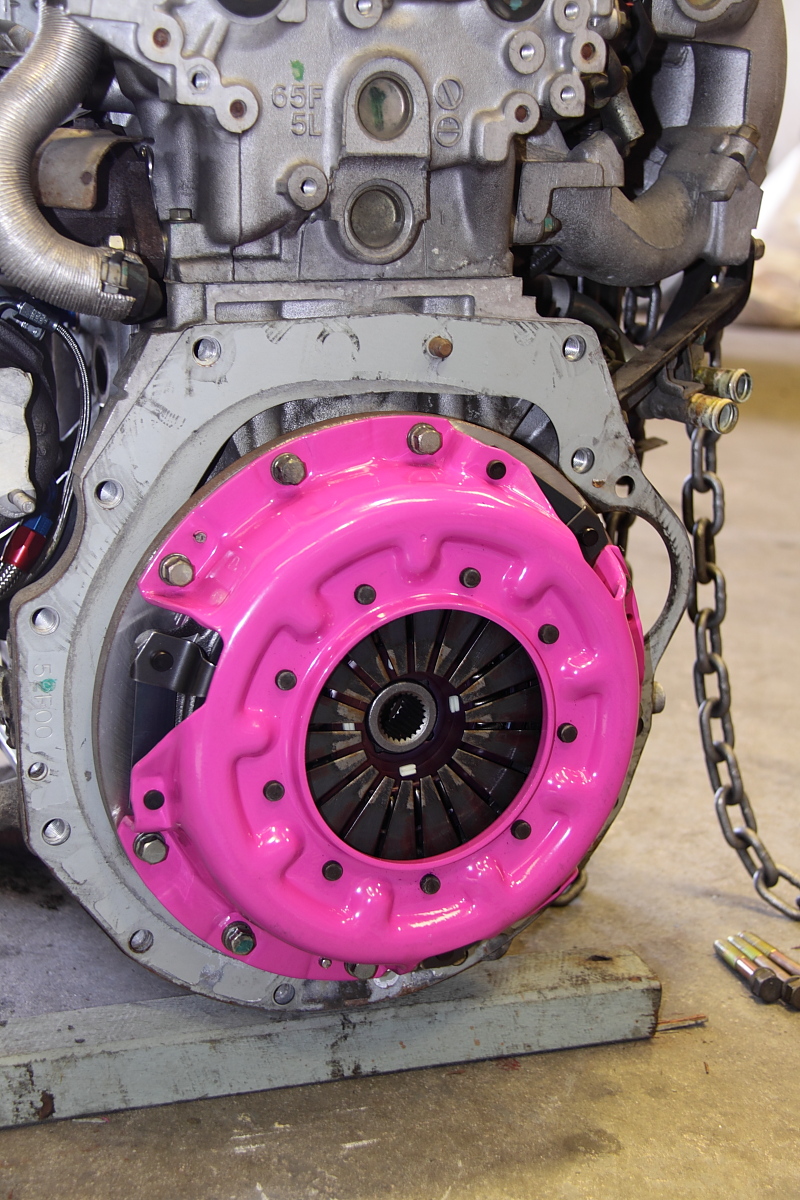

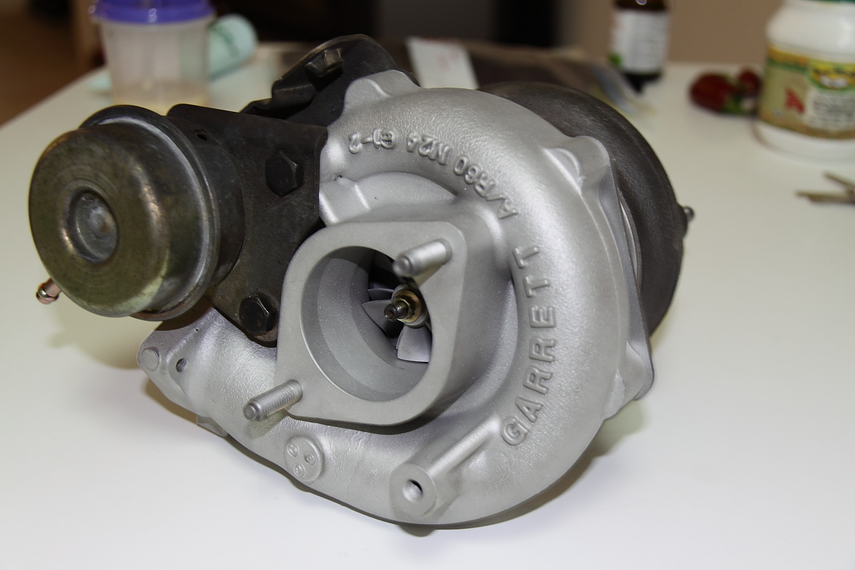

chestikoph1 Posted March 12, 2010 Author Report Posted March 12, 2010 Yeah, i thought about just going for a gt2871r or similar, but to get the most out of it i would need bigger injectors, ideally a z32 airflow meter, and a retune of the computer. So its not just a matter of a few hundred dollars, whack on a big turbo and bump up the boost. The t28 that i have is out of a second generation s14 so its a ball bearing model (gt2560r) same as the s15, meant to be one of the most responsive turbos Garret do in that size, and for now i am only after about 300hp. I ended up paying $690 to get it rebuilt, and i am going to go back to the guy that sold me the front cut, to try and recoup some cash. Anyway, one fresh turbo And attached to the engine with braided lines Also put on my new clutch, Exedy Heavy Duty Cushion Button Quote

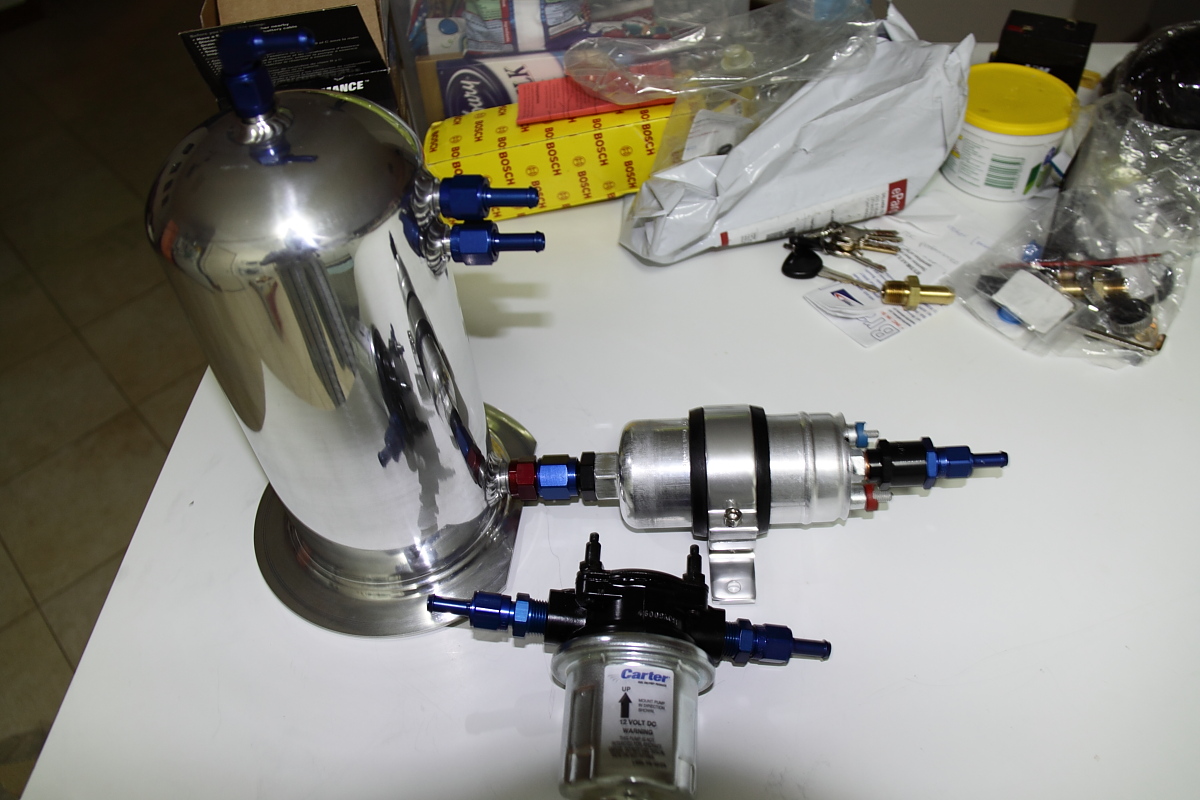

chestikoph1 Posted March 13, 2010 Author Report Posted March 13, 2010 Got all the bits needed for my fuel system, gotta love speedflow fittings. Also ordered a new Tomei stainless dump pipe from Japan, heaps cheaper than here. Can't wait to get this thing going already. Quote
Taz_Rx Posted March 15, 2010 Report Posted March 15, 2010 Pfft. PROPER speedflow fitting don't have hose barbs on them!! >| Quote
chestikoph1 Posted March 15, 2010 Author Report Posted March 15, 2010 yeah i know i know >| At least their shiny and blue, and have Speedflow stamped on them. The screw on ones would have cost a fortune for the fuel system. And i couldnt be bothered getting fittings welded on to the bundy tube off of the tank and under the car. Quote
