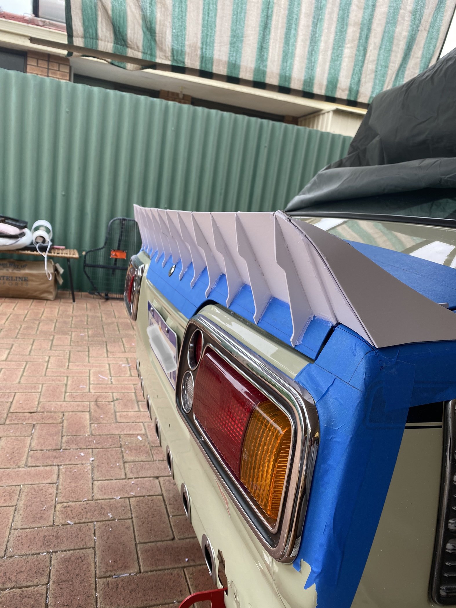

Trialing one of the methods I was thinking of using on a boot spoiler first.
Easier  to explain the process with some photos.

I definitely enjoy the build challenge more than driving the car sometimes, the satisfaction of doing it yourself is rewarding.
As for the tape it serves a couple of functions besides protecting the paintwork, it’s a little hard to see but there are reference lines marked on there. I use these as a guide to glue on the cross sections of the spoiler. Their cut from pvc sheet.
It should also help in removing everything from the boot once I take mould from the finished plug.
Plan a to mould it as one piece with the boot but have the option to make it a bolt on spoiler as well.
