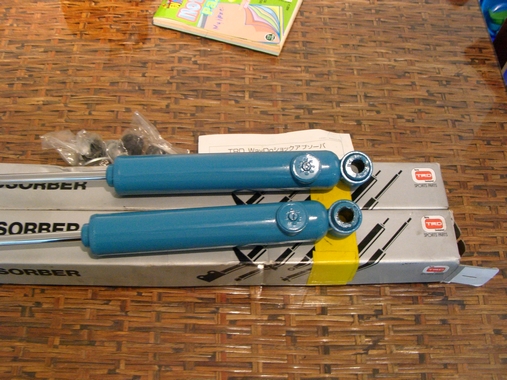

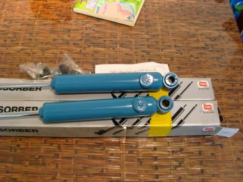

chestikoph1 Posted January 21, 2009 Author Report Posted January 21, 2009 Hi everyone Finally some action happening on this project and something worth posting about. Starting to sort out the rear suspension, I have bought some TRD shortstroke 8 way adjustable shockies and I am getting the rear leafs reset 2inches lower and adding another leaf plus some urathane bushes. Will post up some pics of the car after it's all set up. Quote
Taz_Rx Posted January 22, 2009 Report Posted January 22, 2009 Are they brand new? If so where did you get them from and how much were they? I've got normal length 8 ways with re-set leafs and get pre-load rebound from them. Quote
chestikoph1 Posted January 22, 2009 Author Report Posted January 22, 2009 Yeah they are brand new. I got them from a guy here in Perth, pm me if you want the details, they were about $350 . Not sure if thats a good price for them, but its pretty close to other top end shockie prices. There about 2 inches shorter extended lenght and about 1 inch shorter compressed than ke ones, so hopefully it should be sweet. Quote

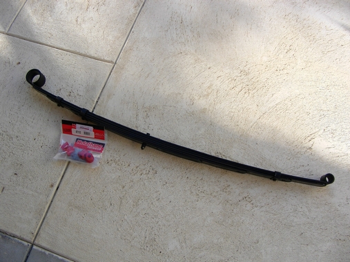

chestikoph1 Posted January 23, 2009 Author Report Posted January 23, 2009 Well just got the leafs back and they look pretty good, they do feel a bit heavier with extra leaf, he has put one in under the main leaf. Every thing fits well back in there, didnt need longer u bolts although i didnt change the leaf cushions for nolathane only the shackle and eye bushes. And the TRD shockies slot right in, they should be plenty of dampening with the extra leaf. Its only a 2 inch drop but i have still rolled the lip of the gaurd up to avoid any annoying scrubs. Took some dodgy pics of how i did that, will post them up soon. Quote

chestikoph1 Posted January 23, 2009 Author Report Posted January 23, 2009 the extra leaf and the reset cost $180 thats with me taking out and fitting the springs,but its a peice of piss job and minimal tools required Quote

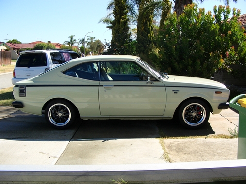

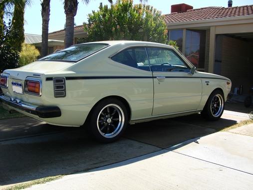

chestikoph1 Posted January 24, 2009 Author Report Posted January 24, 2009 Well i have had a chance to take it for a run, and it handles extremely well, really firm without being bone jarring. The front Bilsteins are not adjustable, but their valved at about 370lb with springs to match. The rear TRD shocks are set on the mid setting 4 of 8 (could go heavier, but fine for daily road duties) The only annoying thing is the sloppy steering " bloody steering boxes" Here is some pics of how it now stands. Quote
KE30_KE35_KE55 Posted January 24, 2009 Report Posted January 24, 2009 Well i have had a chance to take it for a run, and it handles extremely well, really firm without being bone jarring.The front Bilsteins are not adjustable, but their valved at about 370lb with springs to match. The rear TRD shocks are set on the mid setting 4 of 8 (could go heavier, but fine for daily road duties) The only annoying thing is the sloppy steering " bloody steering boxes" Here is some pics of how it now stands. Hey good suspension upgrade :) There is an adjustment on the steering box to take the slop out, might be worth a try. Quote
