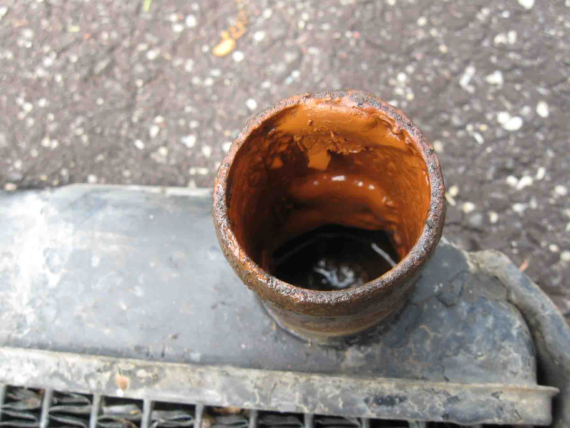

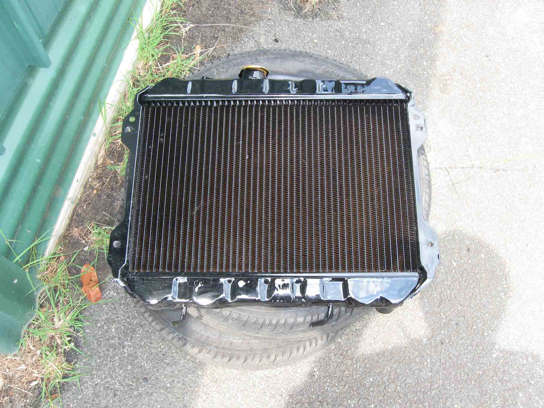

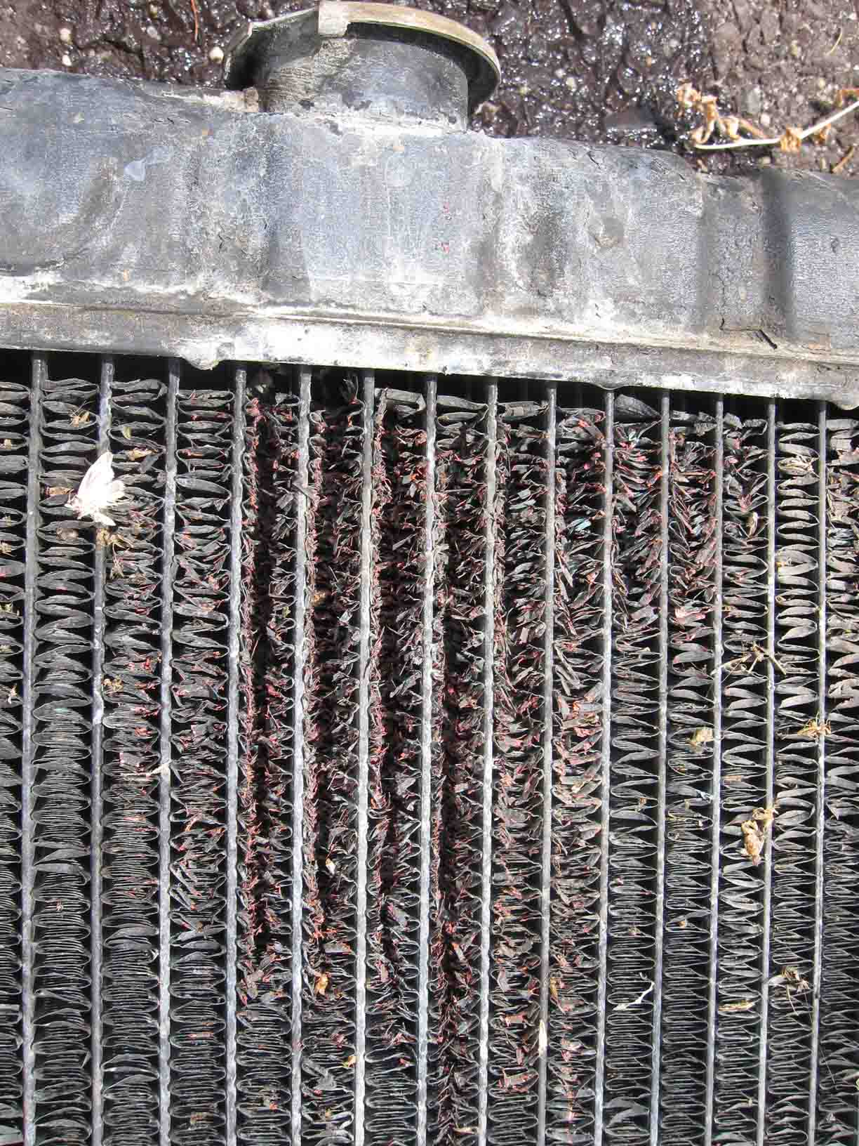

crispyke35 Posted December 8, 2009 Author Report Posted December 8, 2009 Well a bit of an update, you may have read i have been having some cooling issues which have luckily been sorted (so far!!!) . I have put some pics up of how stuffed the old radiator was, It seemed to be fine on the outside but behind the shroud was terrible and it seems the first hot day around here tested it. So put in a brand new one (not reco brand new) also discovered the last one had only been put in 2004 which doesn't seem that old probs a reco. So after that and a new thermostat it runs with the needle on 1/2 way at 100km/h (note this is on 35 deg celcius days). Also some more pics with an extra car in the mix, it's not a rolla but I'm sure you will appreciate it's looks. It belongs to my childhood second set of grandparents (babysitters/extra family) and i grew up cruising around in style. the old one had plenty of build up which also compounded the problem Stuffed radiator, feel apart running a screwdriver down it, I would be going and checking behind the shroud even if your rad looks fine the brand new one about to go in, made all the difference A couple of extra pics Quote

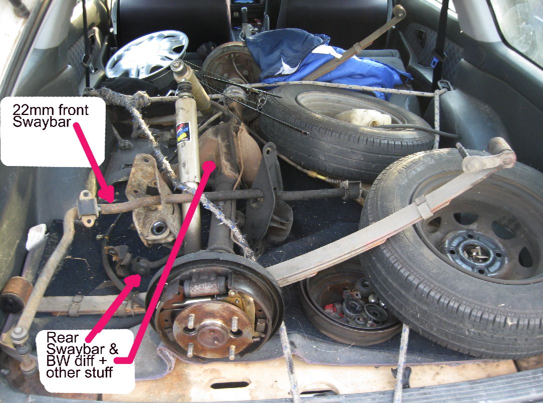

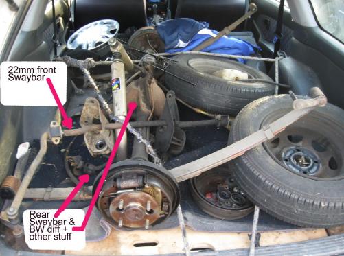

crispyke35 Posted December 11, 2009 Author Report Posted December 11, 2009 (edited) drc_ke20 said: well bloody done mate :hmm: for so being motivated after some tight schedule from uni. Cheers mate, Yeah uni was hectic, but holidays are on and the rolla is back in full swing with the addition of funding that part time job supplies :( Anyway on that note I have another update for the project. Been busy collecting parts for the Rolla as I'm getting more and more determined to have this thing handling good. Cheers "Curly" for the stream of parts so far, So here is what i have been gathering, got a auto borg warner from a late model coupe which means rear swaybar :hmm: and also got the 22mm front swaybar. and as per pic below i have got some spare springs to play with. Also the BW auto ke55 coupe diff should be 4.33:1 right ? so will be faster take off then my manual jap diff ?. So the combo will be a 5 speed k50 to make the highway speeds bearable but the 4.33:1 should be faster take off. I am assuming I'm right here but tell me if I'm wrong or correct in my assumptions so far, need some help because i have a feeling that i got this wrong. (worst that can happen is I get good fuel consumption.lol) The back of the parts carrying mobile ( a magna that dropped 5th & reverse 1/4 of the way on the 400km trip to get the parts, had to drive in 4th on highway :lolcry: ) Finally got some brand new glass put in Cheers Edited December 11, 2009 by crispyke35 Quote

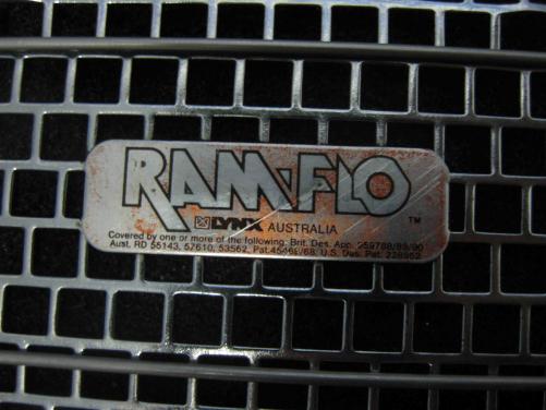

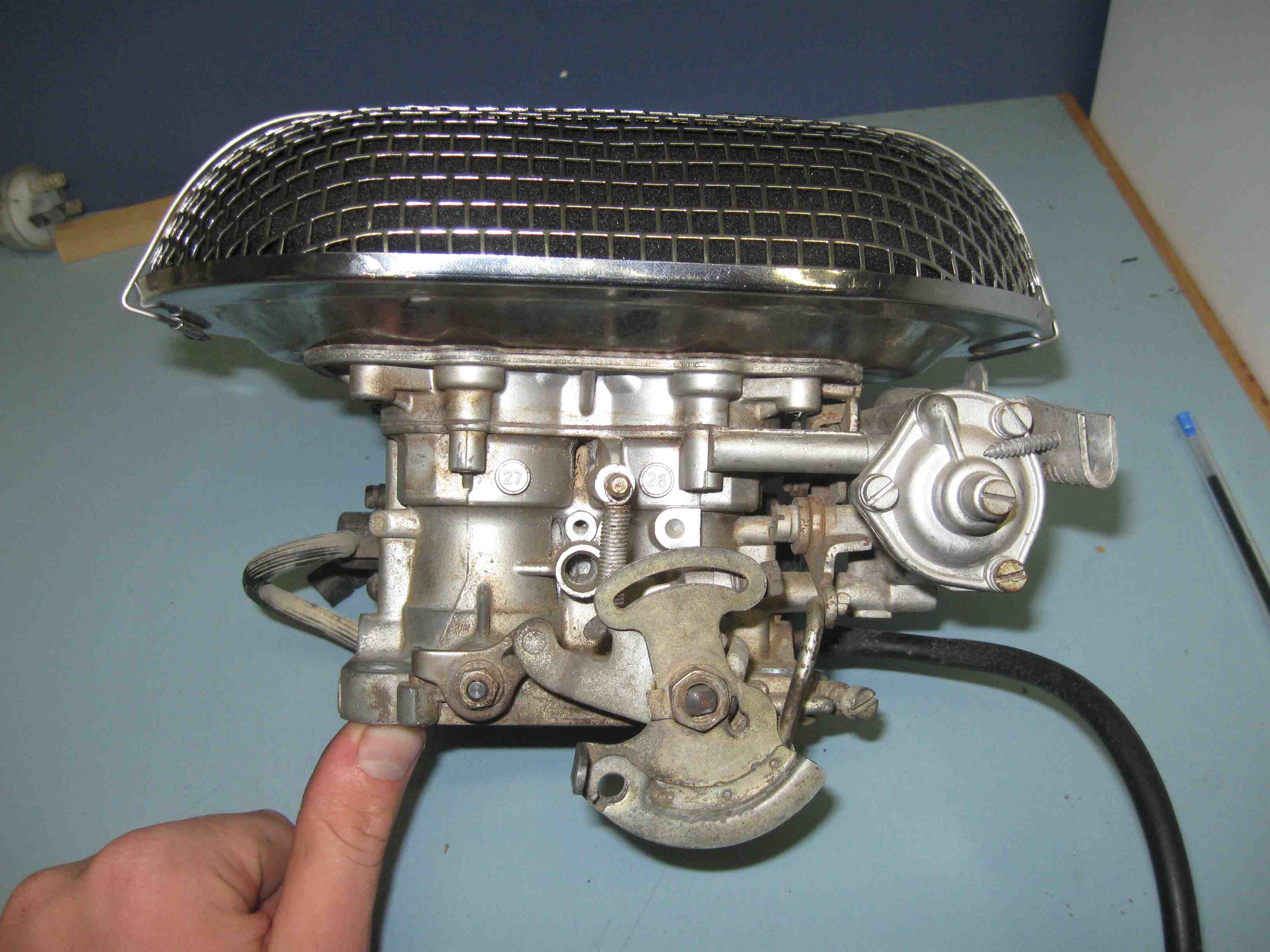

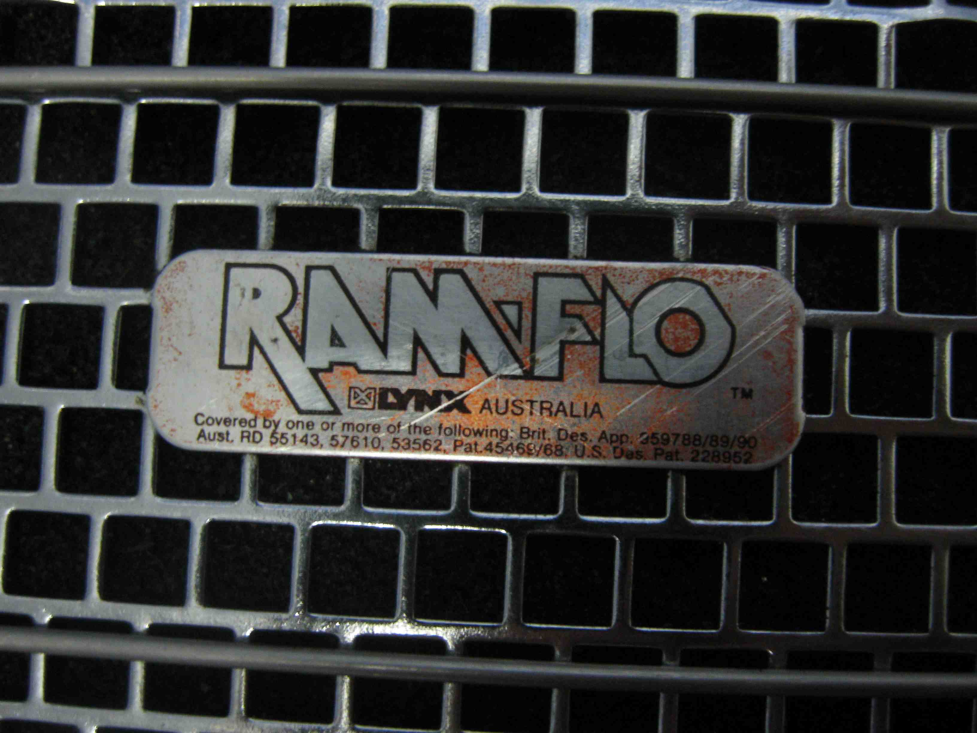

crispyke35 Posted December 29, 2009 Author Report Posted December 29, 2009 Update time, had a massive score yesterday and got a downdraft weber given to me :dance: . Kinda a cool story, about a year ago my dads cousin said that he had a carby lying around in the shed that i could have. sure enough when he came back up for holidays a year later he had a nice gift with him (many thanks). turns out it is a 32/36 DGAV weber carby with lynx ramflo filter and all, was last running on a dato 1200. Looks to be in great nick as I'm sure the picks will show. absolutely stoked. Cheers Jacob Quote

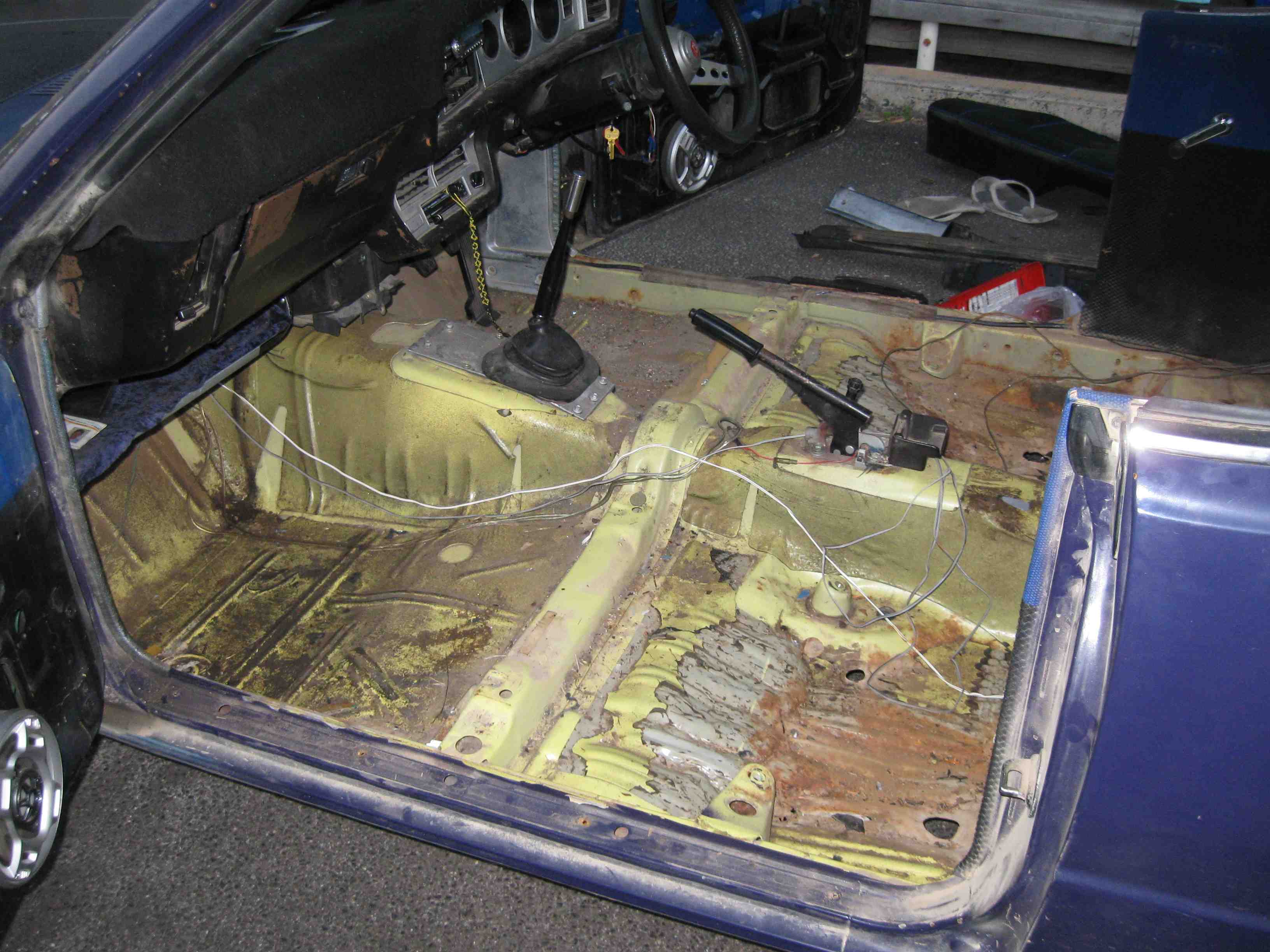

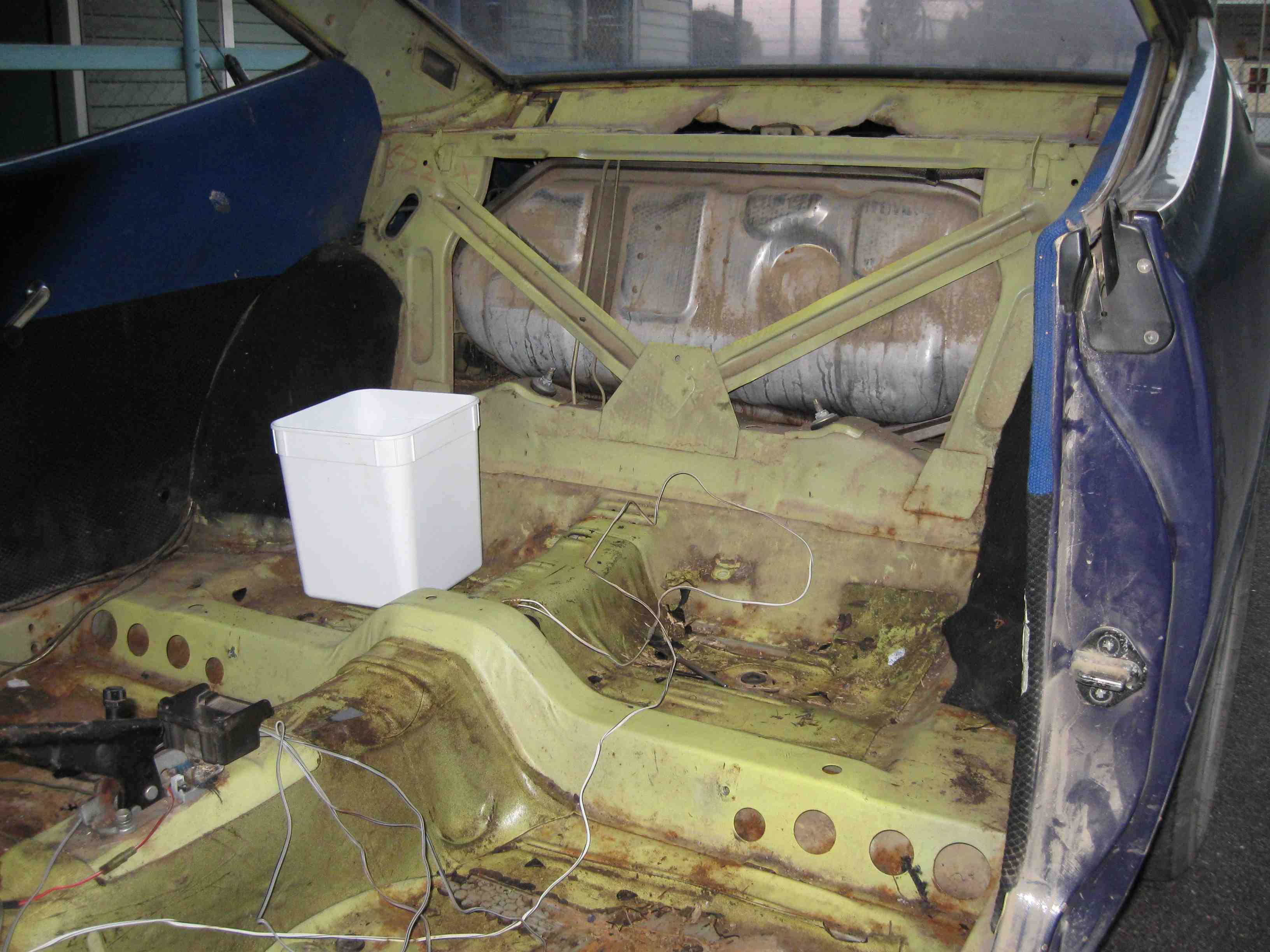

crispyke35 Posted September 1, 2010 Author Report Posted September 1, 2010 Well it's been a while since i have done anything to the car other then drive around in it so today i got some attention. Have had nil time for ages so happy to spend some time getting it looking a bit better. First put in some new brake pads, and outer tie-rod end, wheel alignment and a service Then got started on the installation project. I plan to completely redo the interior as it looks fairly ratty. anyway here are some pics should be some more progress this week. Quote
