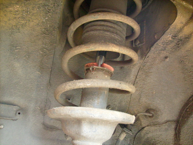

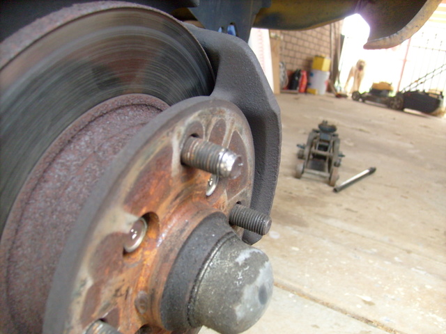

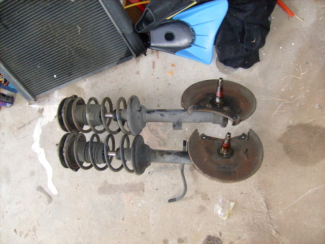

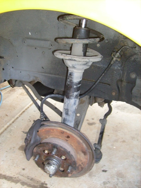

Jason KE30 Posted January 4, 2009 Author Report Posted January 4, 2009 *update* i noticed the other day that my car was leaning to the left a fair bit. i knew that the struts were on their way out so i decided today to get some good ones from upi and replace them. and OMG here's what happened We were down at upi and found some good struts, but do you think that the steering wheel would at least be out of the 'lock' position? no so we spent about half an hour tryin to break it free. we finally got it done and we took them home. once we had to car on jack stand we proceeded to take off the wheels. till we found this: The nuts were only holding on the front wheels by a few threads. which is VERY dangerous. one of the nuts actually stripped one of the studs. we made a decision that we needed longer studs, which turns out is quite expensive, so ryan helped us out and went back down to upi to get the hubs that we had left behind. So we replaced both hubs and discs cause mine had a mass lip on them. We also replaced all brake lines as mine were farked. The struts went in without any problems but for some reason the left hand side is softer than the right, is there a reason for this?? or is it just my car? So now my car is sitting on celica wheels for now courtesy of Ryan *hi five* Anyway, its been a long day and i'm pretty pissed that the person who sold me the wheel nuts didnt notice that they wouldnt do the job properly. oh well. pics!! the rooted left hand side strut new struts! strut fitted OMG IT'S HOVER-ROLLA!! And finally a pic of my car on the celica wheels They will do for now, you will find my old wheels in the for sale thread if your interested cheers jason ps. thanks heaps ryan, couldn't have done this all today without your help Quote
roladude Posted January 4, 2009 Report Posted January 4, 2009 The studs were like that because you had those NASTY spacers on them. The wheels need to be against the hub and there are rings that will make the wheels sit on the hub properly to make it hub centric. The hub is what holds the wheel balanced and takes the weight. With the spacers you had the wheel only sat on the studs and put pressure on the nuts. That and the fact the wheel nuts where only holding onto a couple of threads. Hopefully you can understand what i have read I'm not that good at explaining things :y: Quote
Jason KE30 Posted January 4, 2009 Author Report Posted January 4, 2009 the spacers were only 3mm i don't see how they could've effected the stud that badly. Quote
roladude Posted January 4, 2009 Report Posted January 4, 2009 the spacers were only 3mmi don't see how they could've effected the stud that badly. That they do especially on the front. I used to have mags on an ae70 that didnt sit on the hub properly and i went thru 5 studs before i was told the reason. Quote
KE30_KE35_KE55 Posted January 4, 2009 Report Posted January 4, 2009 the spacers were only 3mmi don't see how they could've effected the stud that badly. It is because the hub boss the rim sits on is slightly tapered 3mm means its loose. Quote
Jason KE30 Posted January 4, 2009 Author Report Posted January 4, 2009 oh ok well i've learnt my lesson. just sellin the wheels that i have and will be buying wheels that bolt straight on without any hassles Quote

SLO-030 Posted January 15, 2009 Report Posted January 15, 2009 It is because the hub boss the rim sits on is slightly tapered 3mm means its loose. That and the fact the guys at bridgestone gave Jason nuts to suit steel wheels. Even without the spacers the nuts ony woulda been holding about 8mm of stud. Incompitent sales people FTMFLooossee. Quote

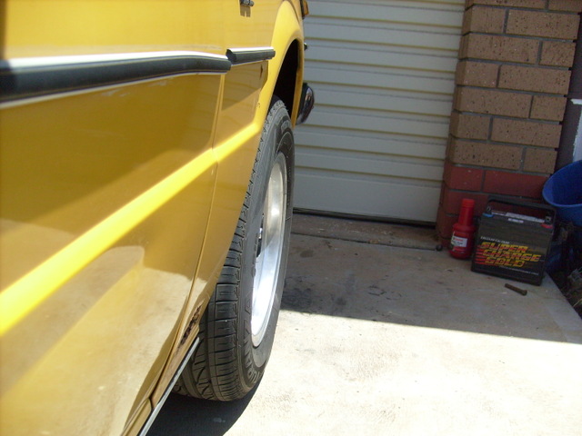

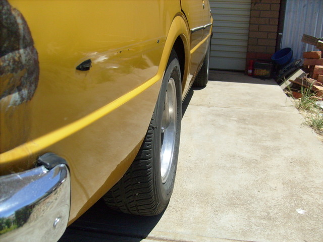

Jason KE30 Posted January 16, 2009 Author Report Posted January 16, 2009 new wheels are on the car!!! got them for $250 with a trade in at a second hand wheel place they look freakin awesome on the car just need some wheel caps to set them off they fill out the guards quite nicely i think but need to lower the front end what would be the best way of doing it? Quote
