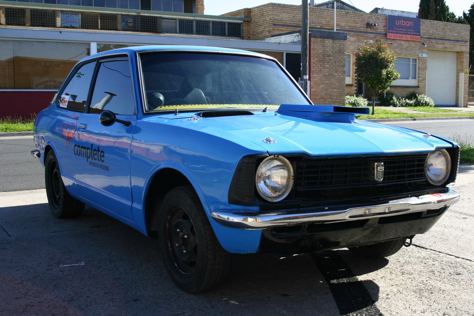

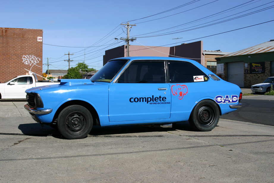

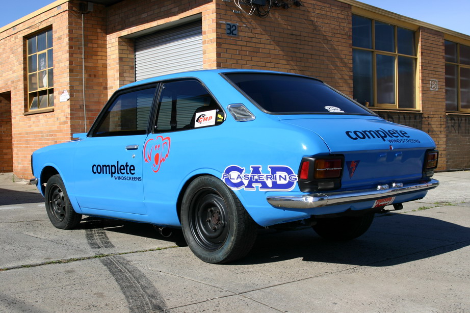

Twin Cam Rolla Posted December 16, 2008 Report Posted December 16, 2008 Nice colour, really suits the car Quote
Gspec Posted December 17, 2008 Report Posted December 17, 2008 A MoPar powered Rolla... too crazy. I can't imaging it will corner well. Is it running the BW35 trans? Makes me want to get my OEM High Performance 265 (4 speed manual) out of my dodge and shoe horn it into my spare T18 for some fun :dance: Quote
Super Jamie Posted December 17, 2008 Report Posted December 17, 2008 what a rad little car, it certainly has no problem getting sideways, the body mustn't know what's going on :dance: not sure if you're aware, but you can fit a 9" slick under the back of a ke20 without tubs, they used to be quite popular as a cheap drag car in the 90s Quote
Corolla 265 Posted December 17, 2008 Author Report Posted December 17, 2008 Its running the big v8 904 trans and a 3k dominator stall Not sure i could fit any wider wheels and tyres under it. its running a 9 inch and 7 inch rims with 205 tyres and its pretty tight. I just bought Racing seats on ebay and will get a harness today Quote

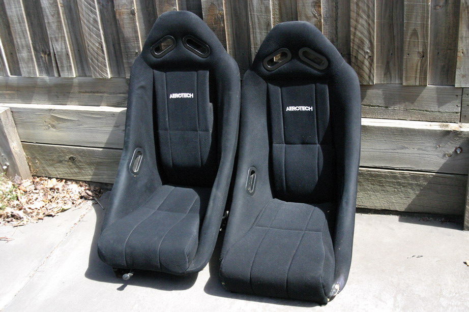

Corolla 265 Posted December 20, 2008 Author Report Posted December 20, 2008 (edited) U tube seach "corolla 265" Here's the seats Edited December 20, 2008 by Corolla 265 Quote

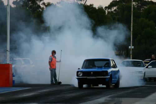

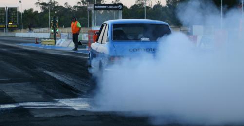

Corolla 265 Posted December 27, 2008 Author Report Posted December 27, 2008 Well i gave it 2 runs at Heathcote yesterday.. Was a bit disapointed with the times but it was a fun day even tho it was 35 degrees. First run got a bit of wheelspin and it ran 14.5@95mph and the second run it coughed and splattered for some unknown reason. Managed to pull a nice 3rd gear burnout in the burnout comp. I let it loose in circles and lost a headlight wich went everywhere. A mate filmed it and i will get it up asap Quote
