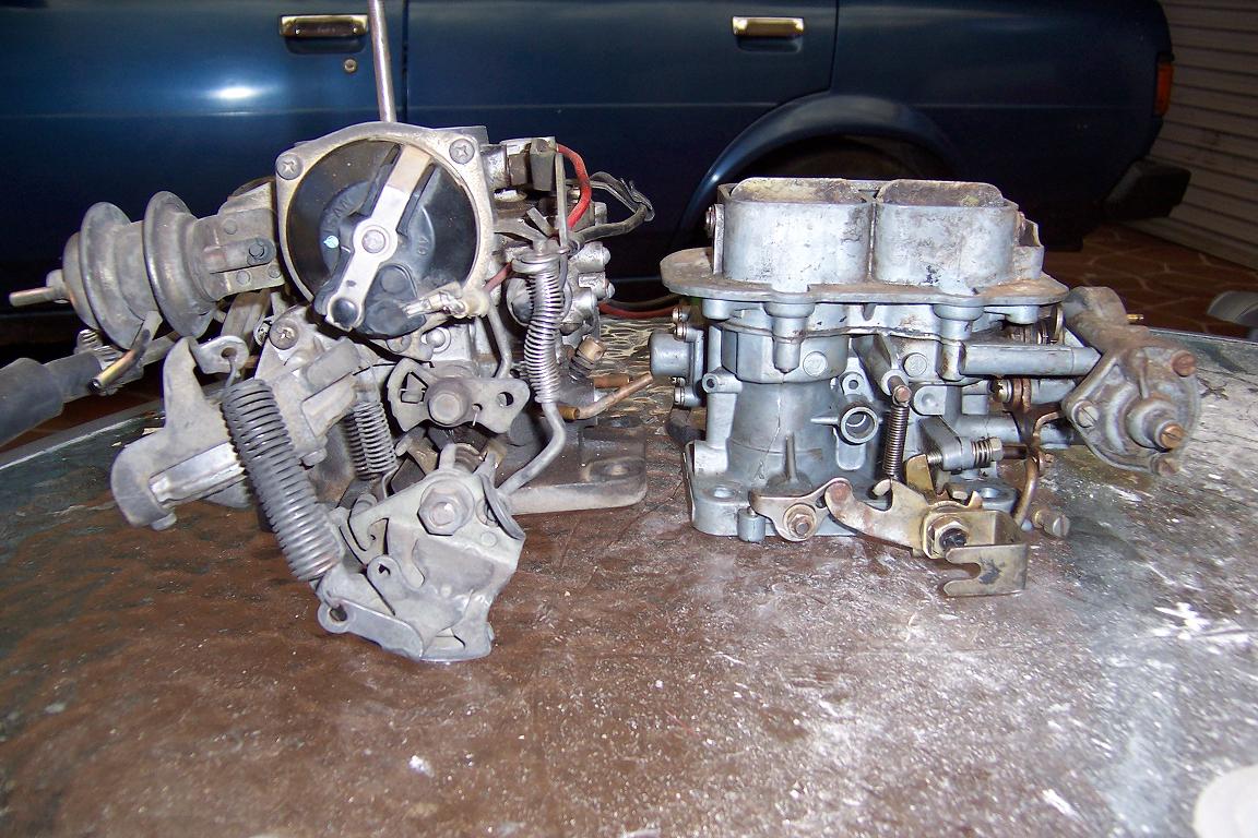

Stixy Posted November 22, 2008 Report Posted November 22, 2008 Hey all I just purchased a lovely little 32/36 DGAV Downdraft Webber for my AE71 wich i purchased from a good mate of mine, it has a 4AC motor and I have heard that they are a bit hard to fit as the accelerator cable needs to be turned 180 degrees???? At the moment I have the Webber and I am getting the adaptor plate from sprints on Monday but after this I’m stuffed as to what to do and what else I need, if anyone could help with some information it would be much much appreciated. Cheers Ben :) Quote

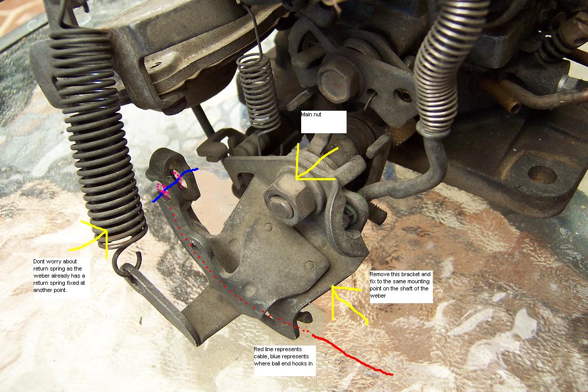

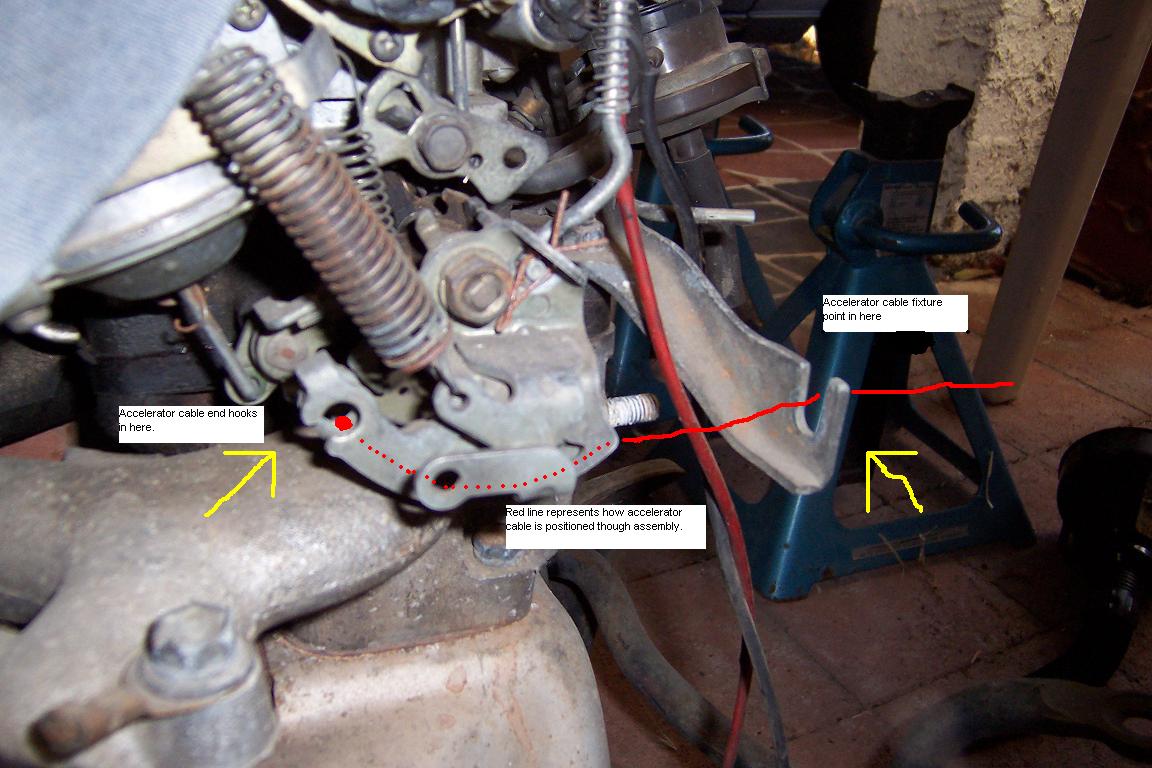

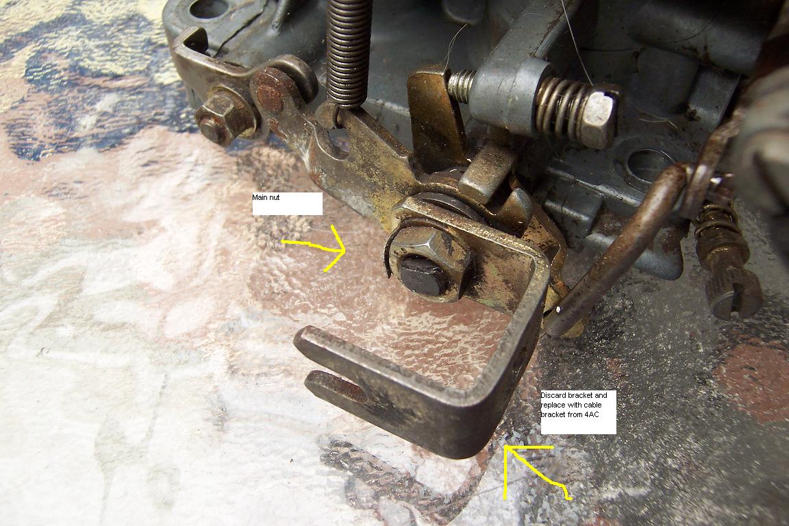

DearmanKE Posted November 22, 2008 Report Posted November 22, 2008 take your throttle arm off the standard carby aNd put it on the webber, then i think you can mod the accelerater cable holder bit Quote
Budowski Posted November 23, 2008 Report Posted November 23, 2008 Ive taken some pics of how the weber should be arranged Quote
