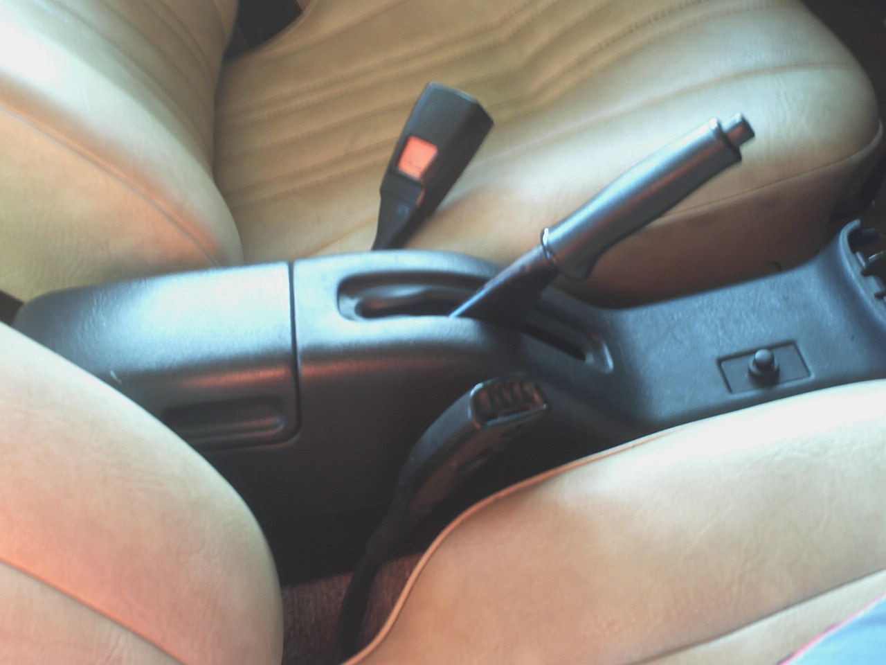

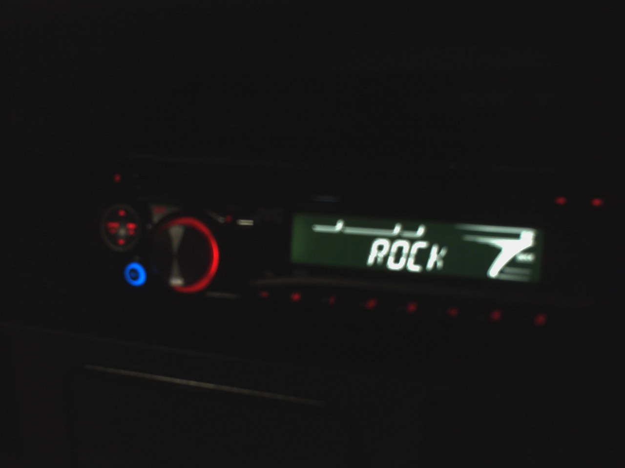

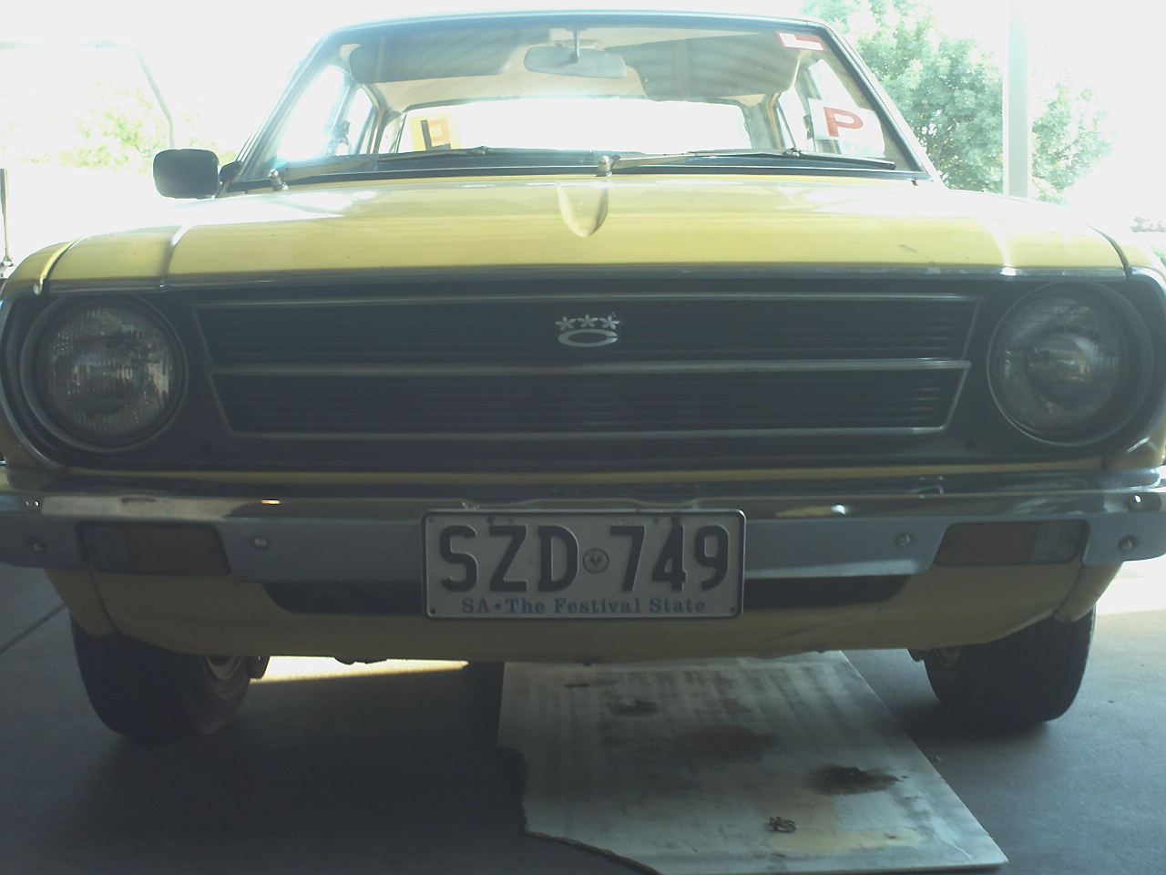

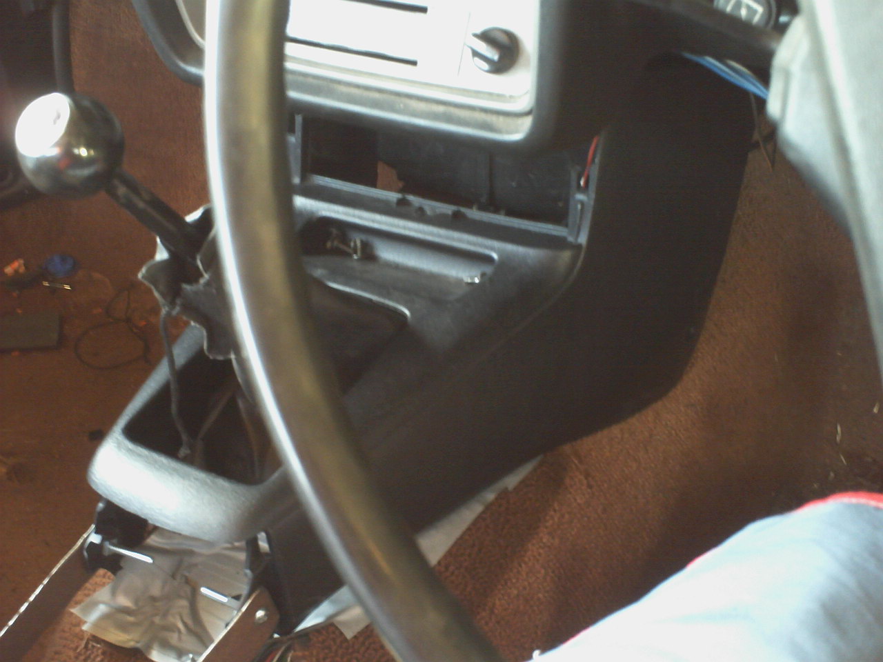

SLO-030 Posted November 14, 2008 Report Posted November 14, 2008 (edited) Well, I figured it was about time to make a project thread about my new Ke30. 1978 KE30 SE 4dr Colour: Canary Yellow Engine. Ke70 4K Trans: ke30/55 4spd Diff: BorgWarner 4.11:1 Brakes: stock Suspension: Flipped leaves and cut coils :hmm: Audio. JVC Mp3 Cd tuner. undecided 4' or 6' fronts. 6" rears. Kenwood 350watt Amp bridged to a Boss 800watt sub in an custom box. I have also fitted a late model toyota console. needs a filler section as the 30/55 K40's shifter is a tad too far forward, will make a mout and stick my tacho and make something around that. Oh don't mind the duct tape. its good for holding things temporarilly while modifiying things Just swapped the dash pad over from a cracked up old one to one that i believe is from DR1FT's old ke55. Also put in the head unit tonight. turned out easier than i thought. I just used modified factory brackets from the AM radio. Gotta love these japs :lolcry:. Looking at swapping the gearbox for another 4spd which should hopefully stop the death rattles lol. thats it for now. will get some pics tomorow. Edited May 16, 2009 by SLO-030 Quote
Tally Posted November 14, 2008 Report Posted November 14, 2008 Sounds sweet az dude, should be good! Quote
Taz_Rx Posted November 15, 2008 Report Posted November 15, 2008 Why not go for a ke70 gearbox, might make your centre console easier? Quote
JiP Posted November 15, 2008 Report Posted November 15, 2008 Nice looking 30 you have there. So what Toyota did you get that console from?? Quote
SLO-030 Posted November 15, 2008 Author Report Posted November 15, 2008 Why not go for a ke70 gearbox, might make your centre console easier? Yea, the console will go together with the 70 gearbox in it as the console was destined for my ke25 before i sold it. But I kinda like the tacho there. see what happens when i get another gearbox for it Nice looking 30 you have there. So what Toyota did you get that console from?? A Paseo, Charl also used one in his ke20. has the center cutout for the handbrake. :lolcry: Quote

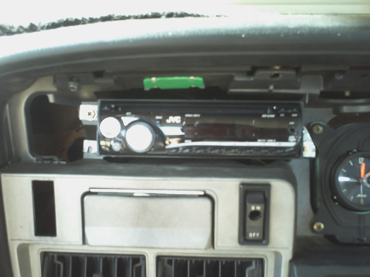

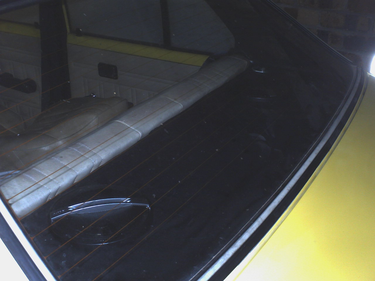

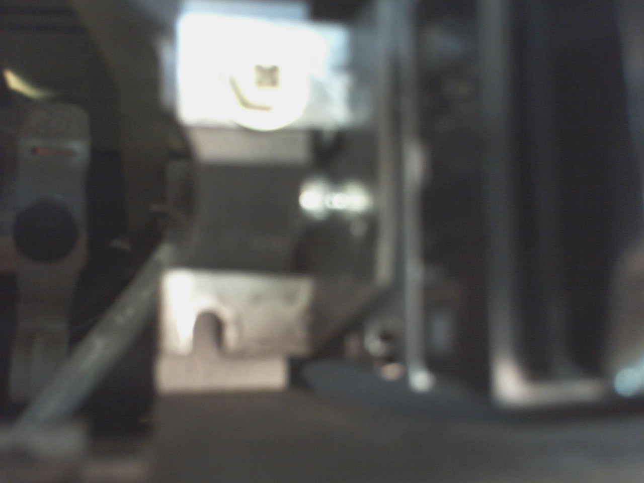

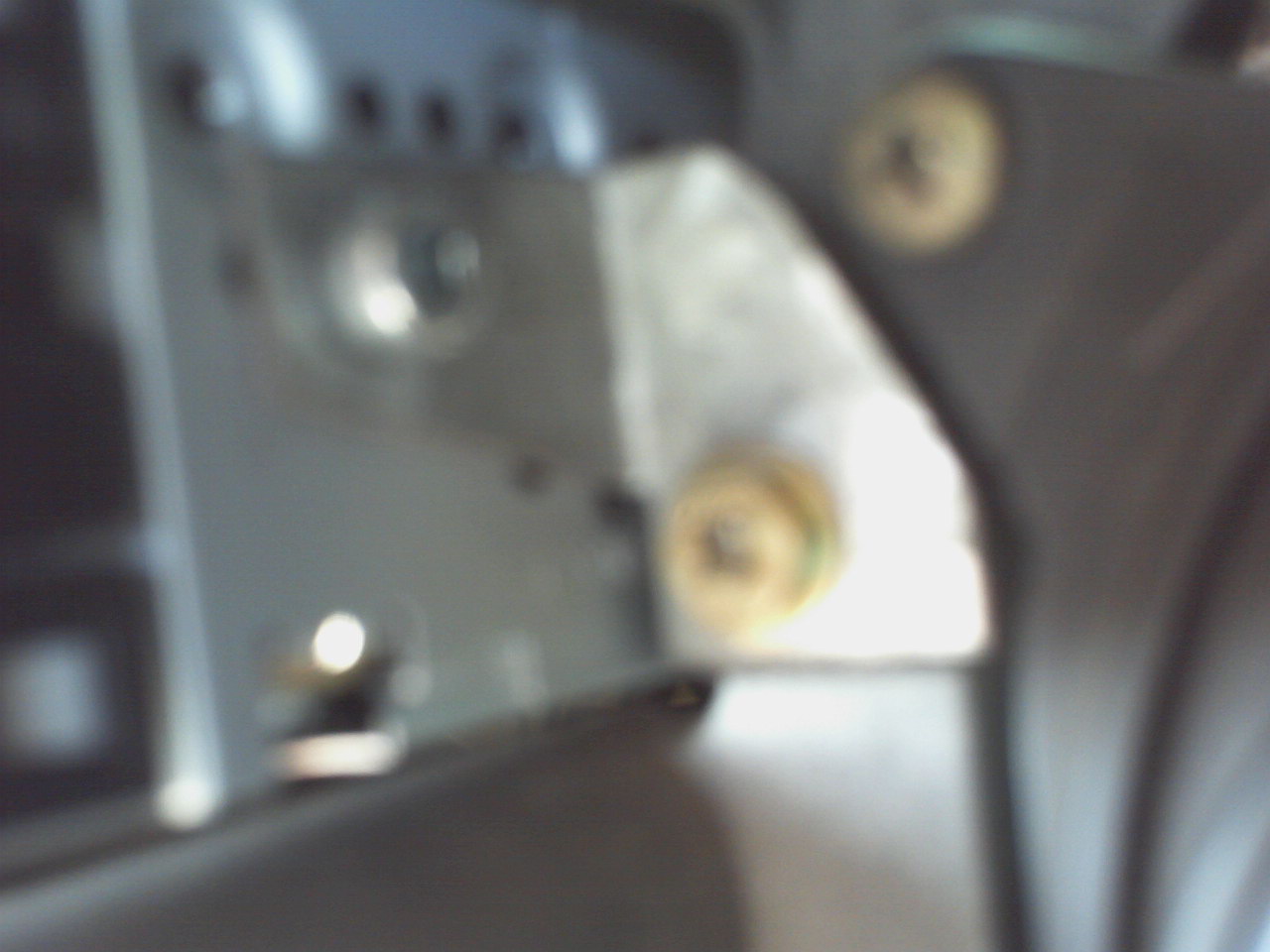

SLO-030 Posted November 26, 2008 Author Report Posted November 26, 2008 (edited) Hey guys, been a while so i thought id update with the work ive done. Heres pics of mounting the stereo. Right Bracket, flipped and trimmed. Right Bracket. Hole slotted out. Stereo In. New parcel shelf. fabric still to be glued under rear screen. Edited January 31, 2009 by SLO-030 Quote

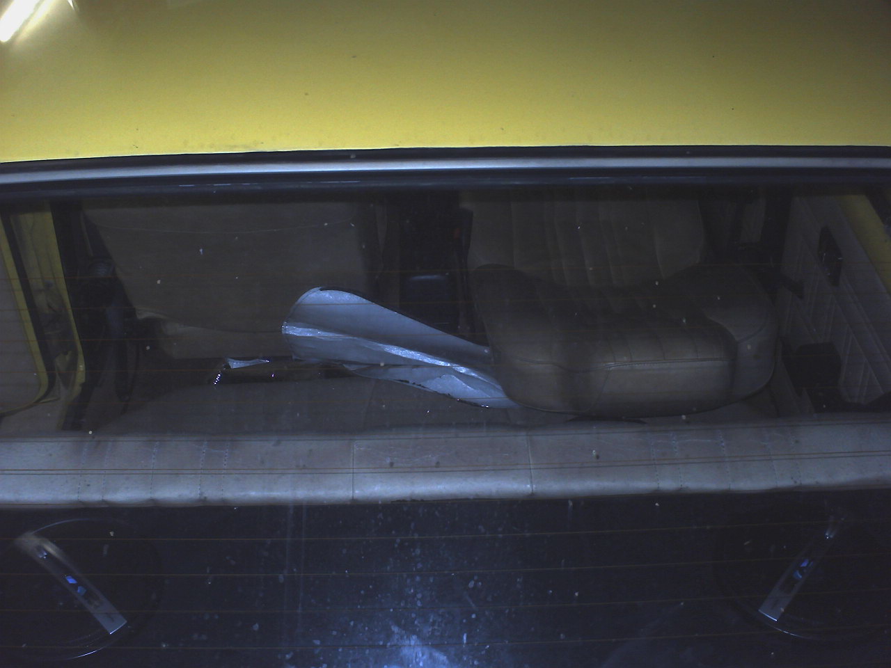

SLO-030 Posted November 29, 2008 Author Report Posted November 29, 2008 Window, basically dropped put of the tracks on an angle =S. Myles was the first person to see the rolla (besides Murderess who took me to pick it up) and YEP, Just had to break something :no2: Took it back to his place and made the little bugger fix it :y: Quote
