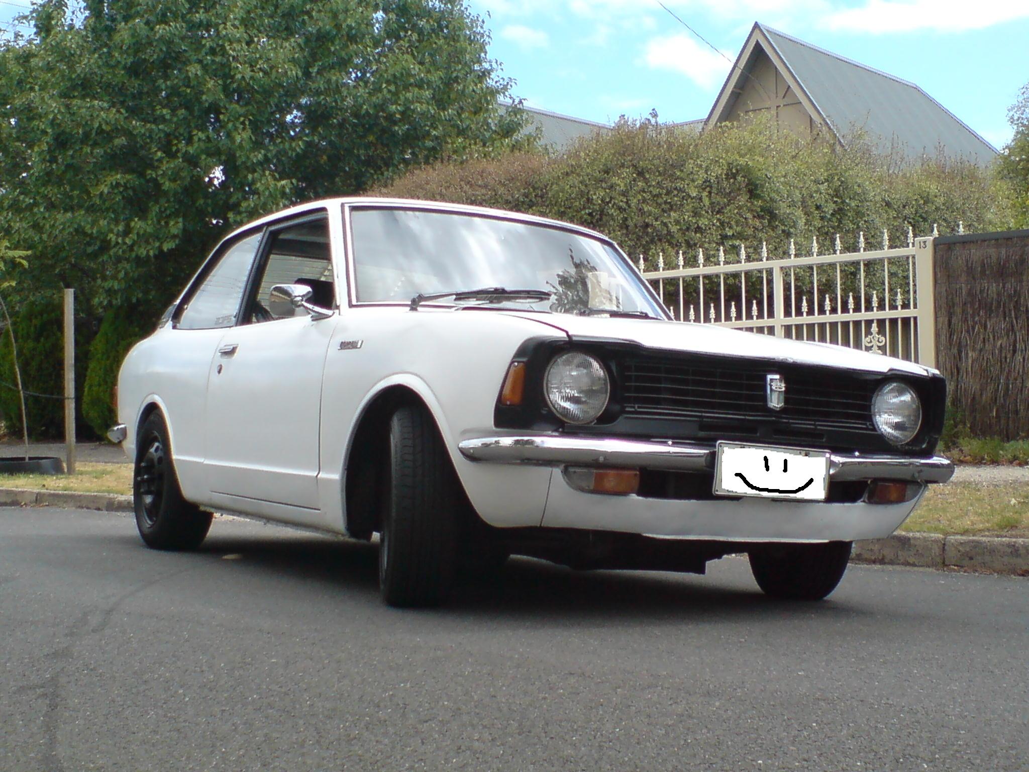

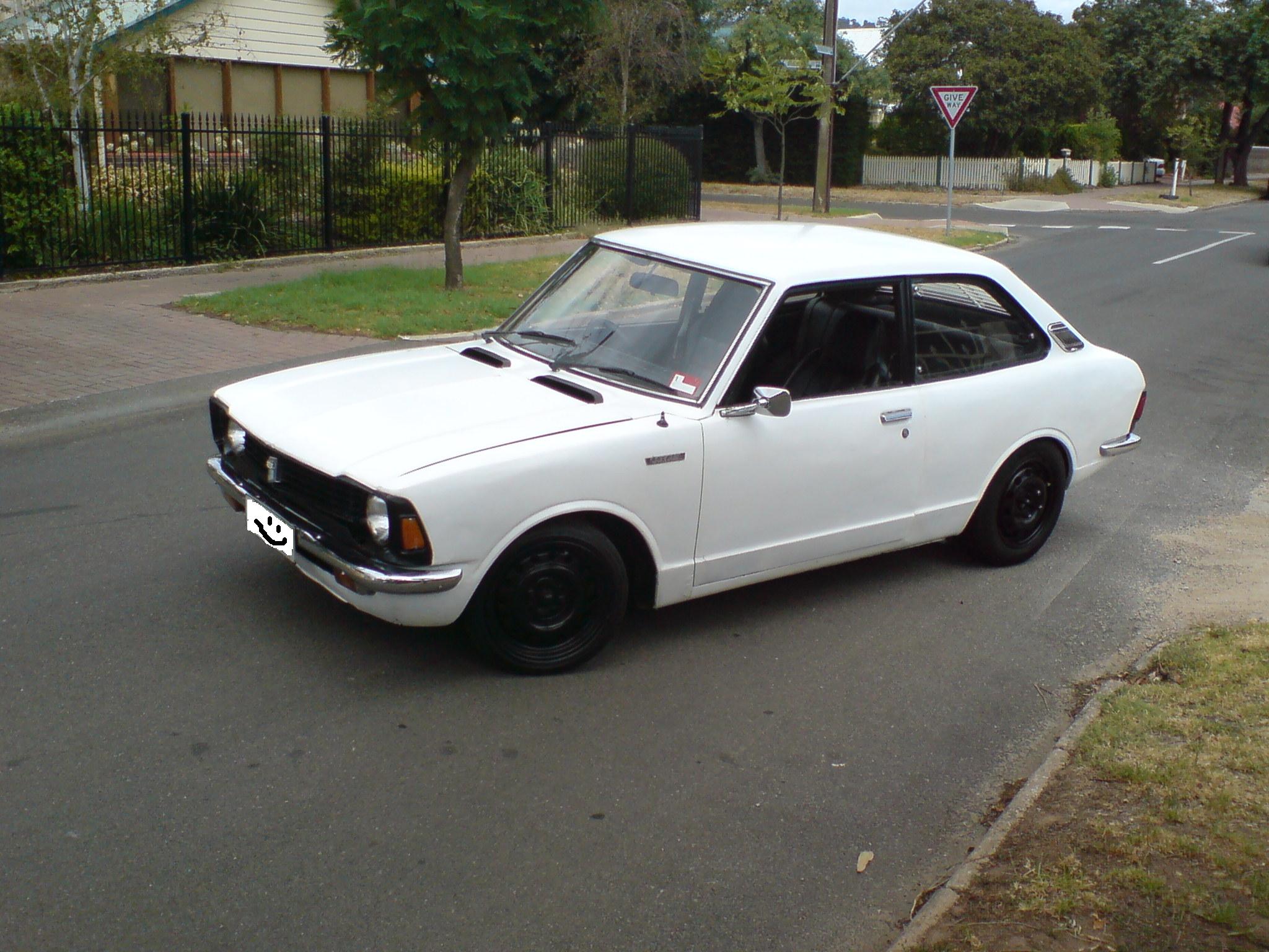

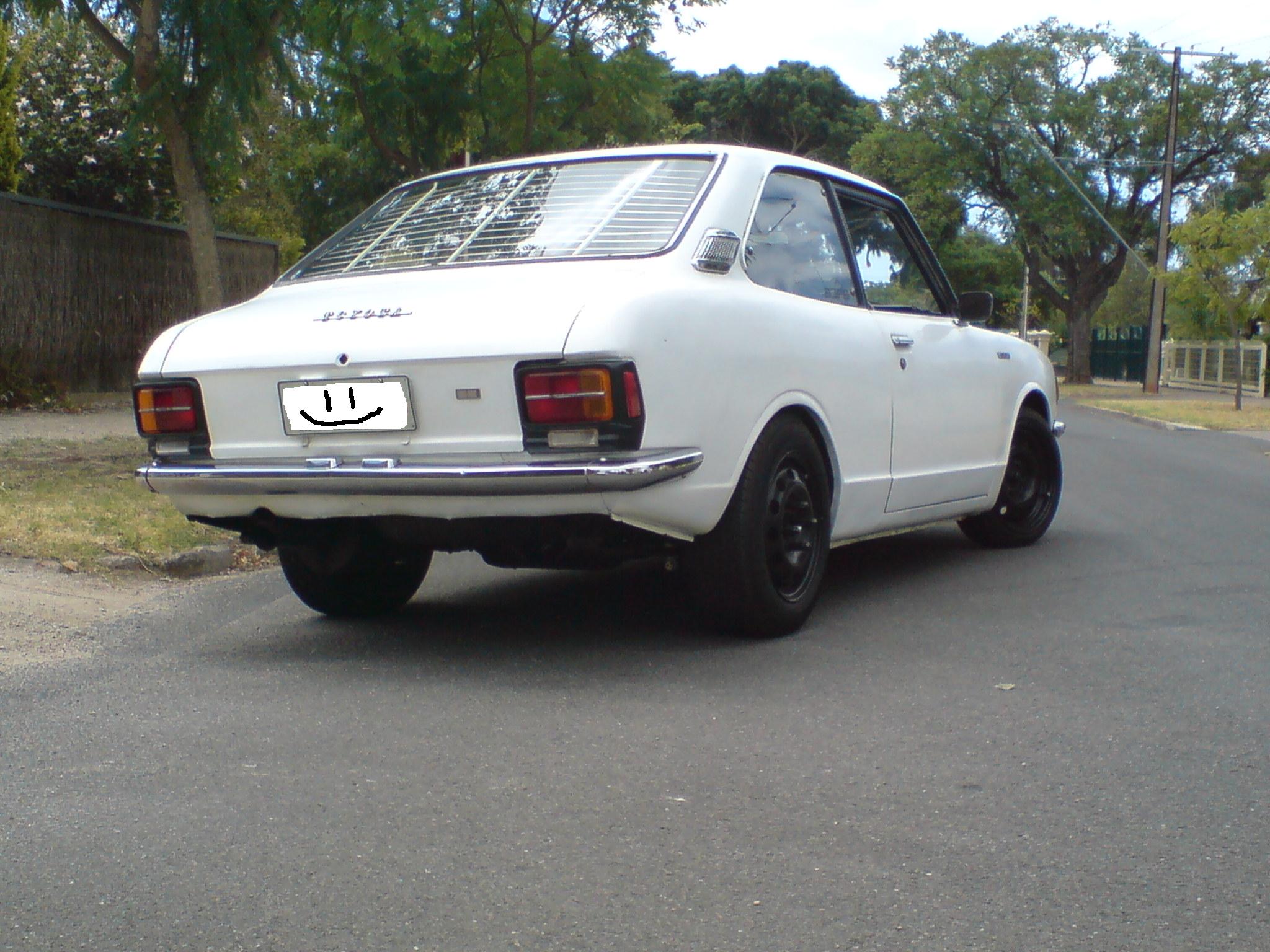

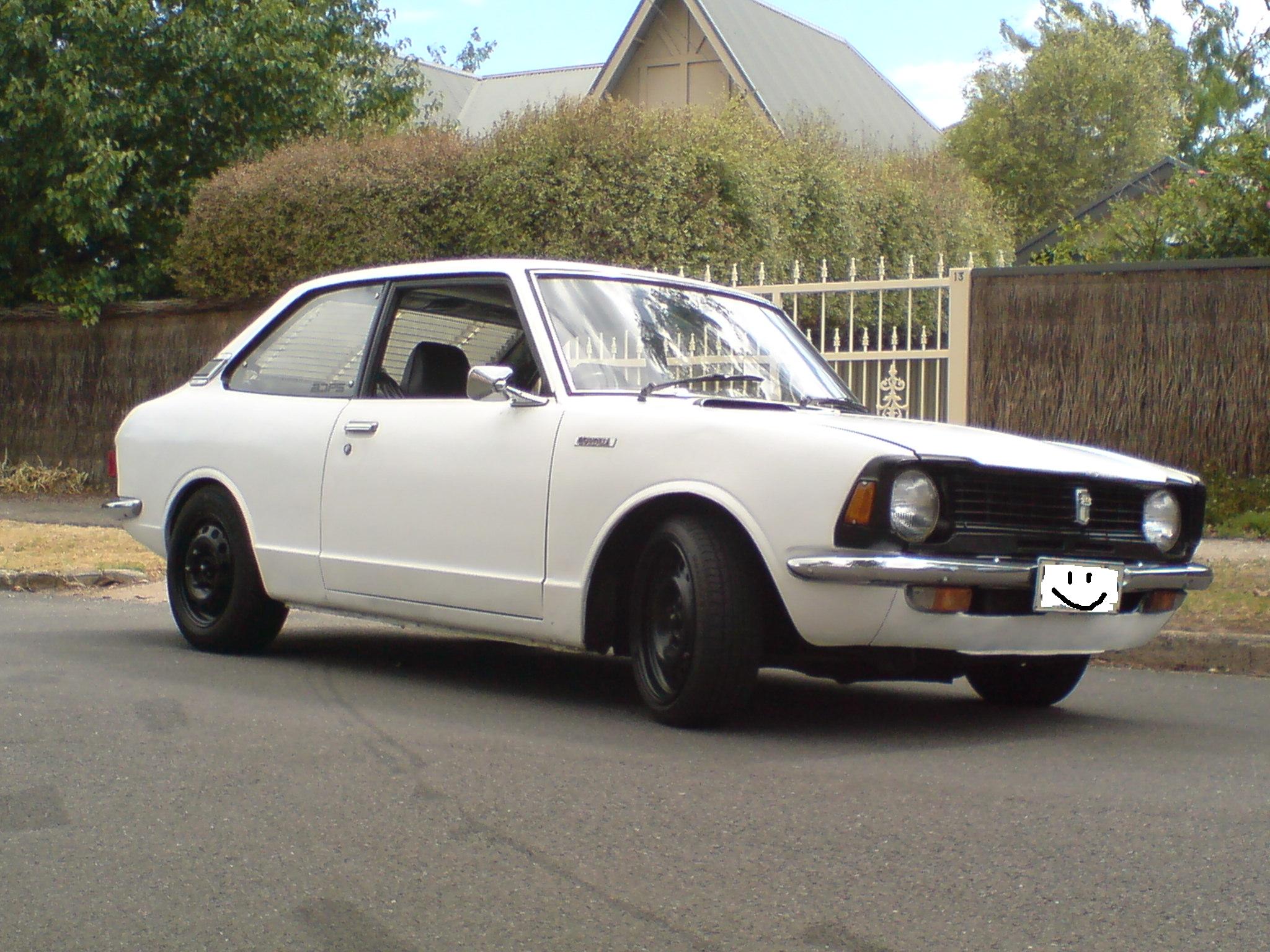

13BT_KE20 Posted February 9, 2009 Author Report Posted February 9, 2009 DRIVING!!! few "issues" though, brakes need to be bleed again and turns out at half an inch of travel between the diff and floor really isnt enough.......... car isnt clean and lightin is pretty crap but heres a few pics anyway Quote
benzo Posted February 9, 2009 Report Posted February 9, 2009 f@$k yeah! looks tough man soon to come - trouble-free skids oh yeah and more power :cool: love your work Ryan Cheers, Ben. Quote
HIGH ROLLER Posted February 9, 2009 Report Posted February 9, 2009 Awesome work Ryan...looks tuff nuts... what's the next step for this skipping rotta?? Mark Quote
greenmac80 Posted February 9, 2009 Report Posted February 9, 2009 wicked work man!! looking forward to seein it! how has your track come up? wider rear or wider front? Quote
furryfrog Posted February 9, 2009 Report Posted February 9, 2009 holy shit that rear looks wide, whats going to happen if you decide to put some different offset wheels probably need some flares. love the numberplate too lol Quote
cuzzo Posted February 9, 2009 Report Posted February 9, 2009 I'm guessing you didnt cut down the lux diff. Quote
13BT_KE20 Posted February 9, 2009 Author Report Posted February 9, 2009 cheers for all the kind words guys, I'm really happy with how the car is turning out. soon to come - trouble-free skids oh yeah and more power :hmm: for sure ben, there a few burnout comps ive got my eyes set on coming up soon more power will come once ive sorted all the other things like the front brakes/suspension, redoing the exhaust and wiring in the stereo and additional guages what's the next step for this skipping rotta?? first up is getting the rear guards/lips rolled then, drive it to the workshop to get the gearbox crossmember modified so i can raise the exhaust, then the front suspension/brake get done straight after how has your track come up? wider rear or wider front? definitely wider at the rear, from the short drive ive taken it on it definitely helps keep the car a little straighter under boost/wheelspin holy shit that rear looks wide, whats going to happen if you decide to put some different offset wheels probably need some flares. love the numberplate too lol the wheels are here to stay! sleeper FTW!!! haha yeh custom plates I'm guessing you didnt cut down the lux diff. the diff has been shorten to suit a S1/2 RX7 so the overall width was 1415mm, which is almost 100mm wider than a stock KE20 diff hence the positive offset rims. The diff came up for sale at the right time/price and with the ratio and stud pattern i wanted and i already had the rims lying around. It ended up working out perfectly really. So it has been shortened but not really to suit a KE20. A long time down the track (who knows how far I'm going to go with this car, look where OKE020 started :cool: ) the rear end might get tubbed and the diff made ALOT shorter and run some dished rims, but then thats really moving away from the sleeper look at the car was originally built to Quote
StasIII Posted February 9, 2009 Report Posted February 9, 2009 sorry but the diff looks a little odd to me. Ive had to panel beat my floor near the diff housing to give me clearence. How bad does it bounce ? Quote
