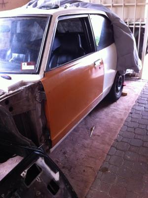

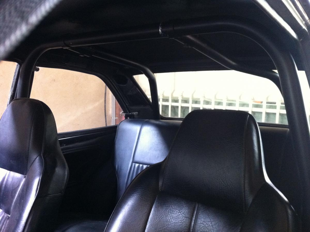

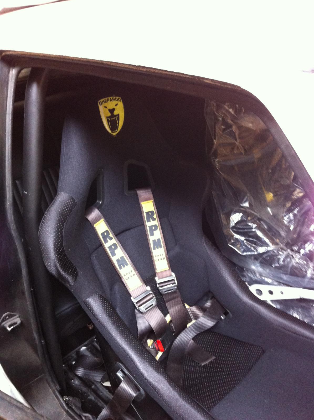

13BT_KE20 Posted May 2, 2012 Author Report Posted May 2, 2012 The look of the car has slightly changed from a sleeper to street/race mainly due to the fact I'm only interested in going FAST and need MORE AIRFLOW. So I started to bolt the interior back in My old passenger door had a massive hole/crack from my side mirror being ripped off by some lowlife Bolted in my new race seats, rollcage, 4 point harness and test fitted my hydro handbrake Quote

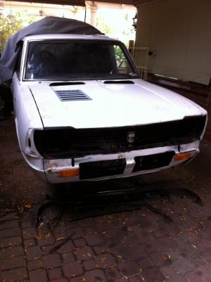

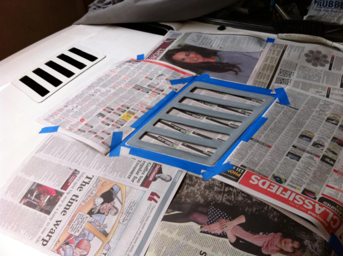

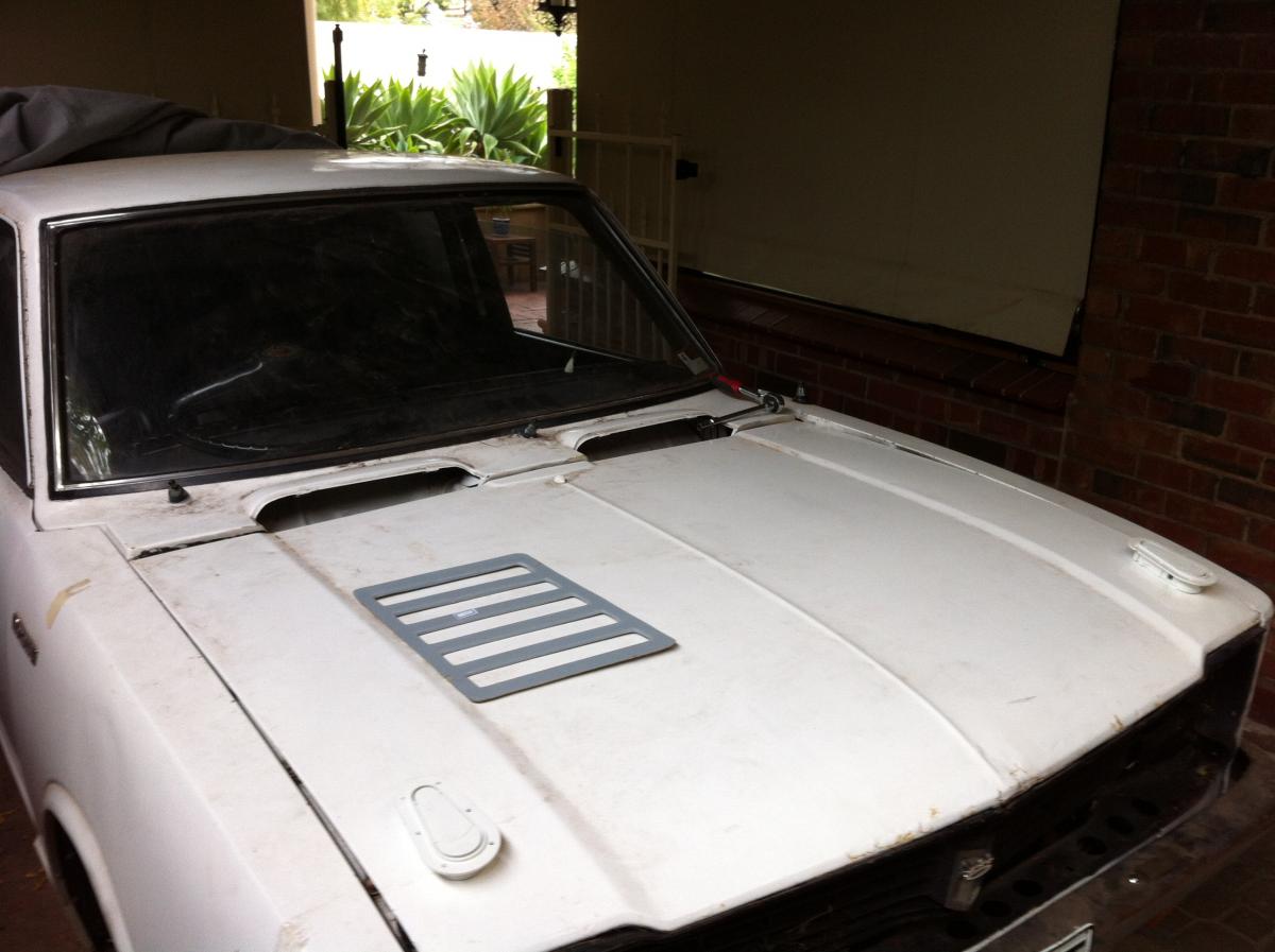

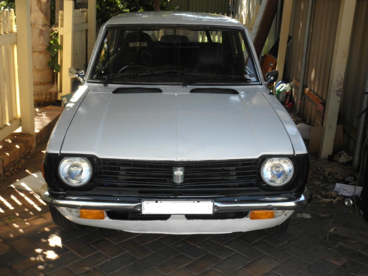

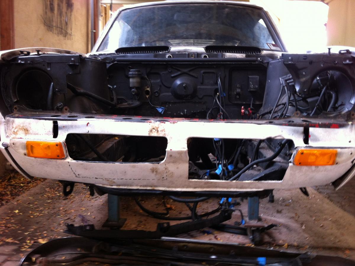

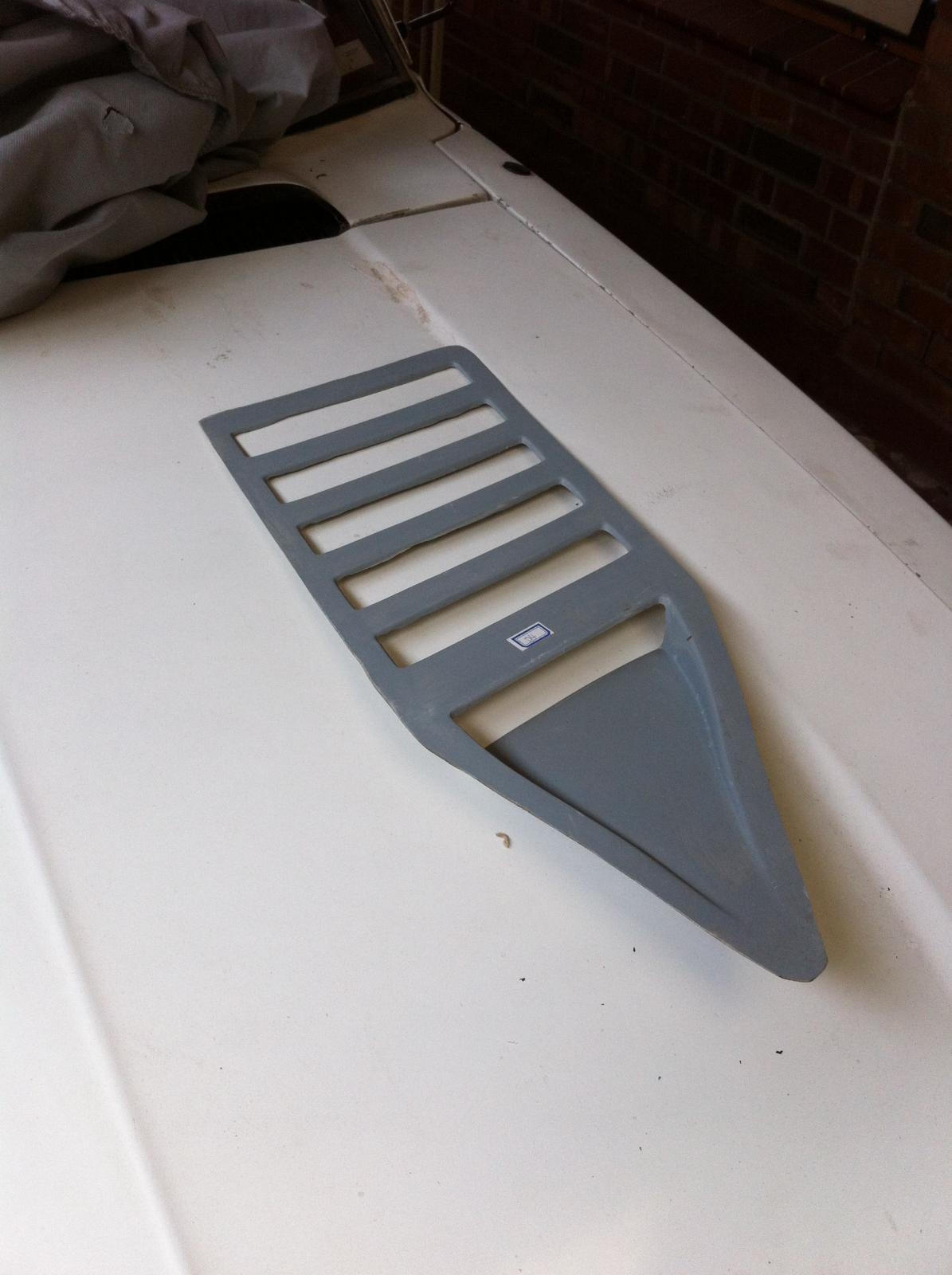

13BT_KE20 Posted May 2, 2012 Author Report Posted May 2, 2012 The next plan was to get MORE AIR IN to the engine bay and HOT air out. I want to decrease overall engine temp and reduce overheating problems from prolonged hard driving. F/G vent above turbo location, aero catch flush mount bonnet pins So i had to attack the bonnet Then i attacked the front valence panel Quote

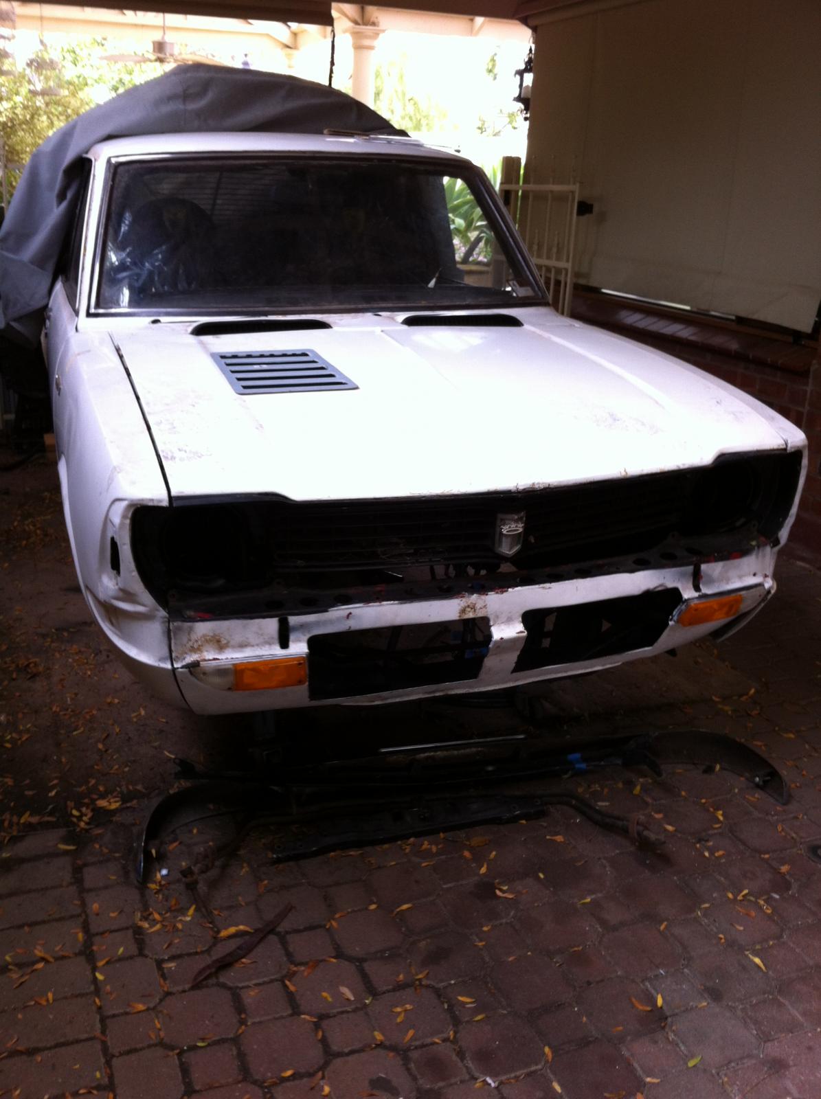

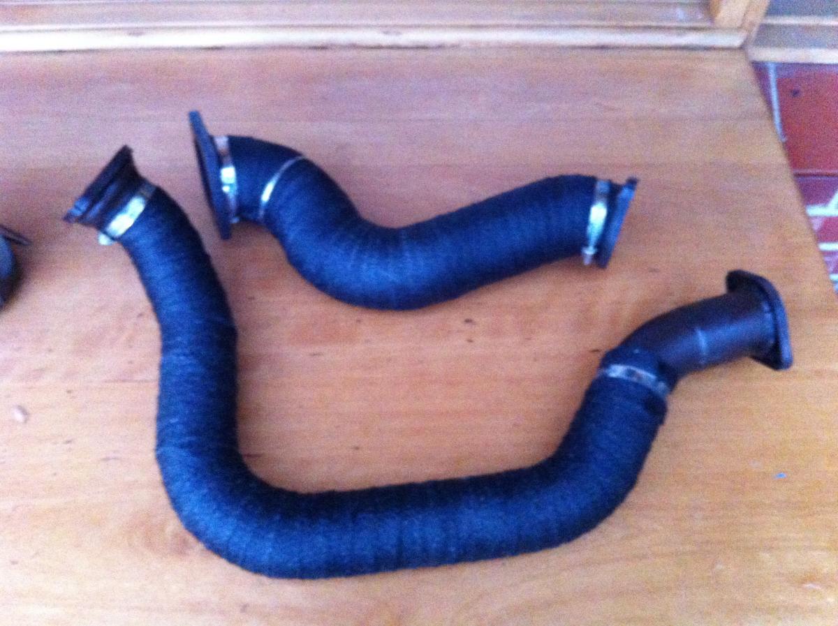

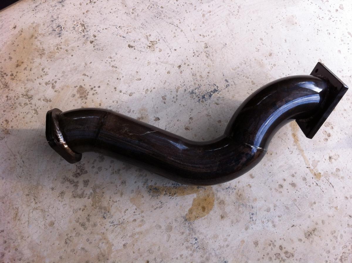

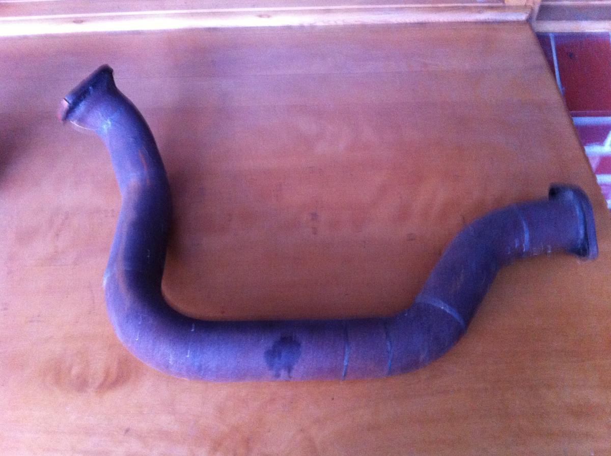

13BT_KE20 Posted May 2, 2012 Author Report Posted May 2, 2012 New look front end before a bit of touch up paint Next was to heat wrap my dump pipe and mid section exhaust, i chose black wrap of course! Mid section before being cleaned and prepped Dump pipe after clean and prep all ready to be wrapped Quote

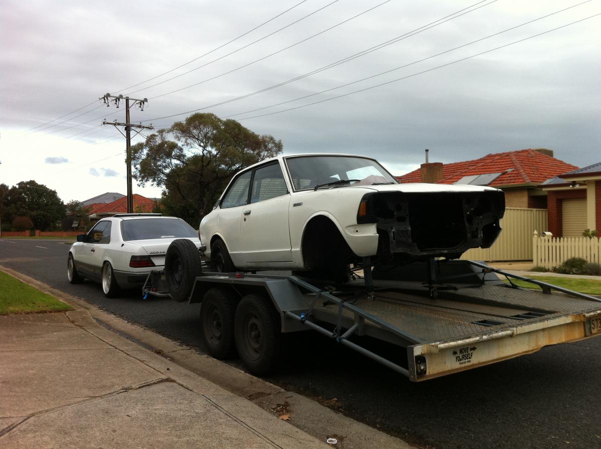

13BT_KE20 Posted May 2, 2012 Author Report Posted May 2, 2012 All wrapped up! Thats 20 metres of heat wrap Transporting, i just like this pic so thought id add it. If anybody can help me with a front end set-up PLEASE let me know http://www.rollaclub.com/board/topic/58449-ke2-crossmemberfront-suspension/ Cheers, Ryan 1 Quote

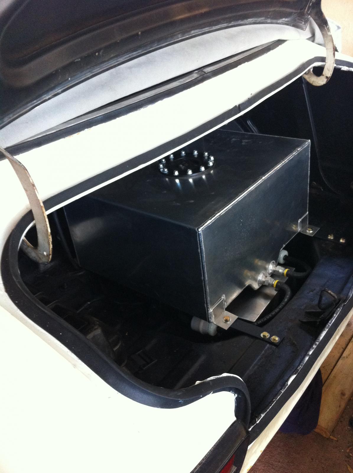

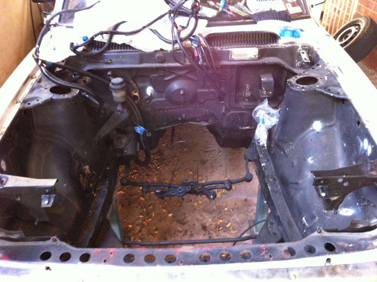

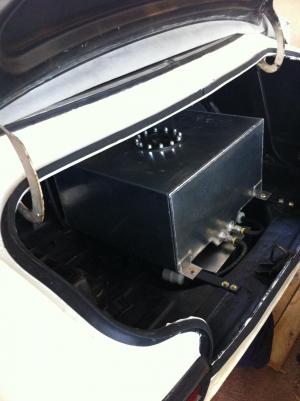

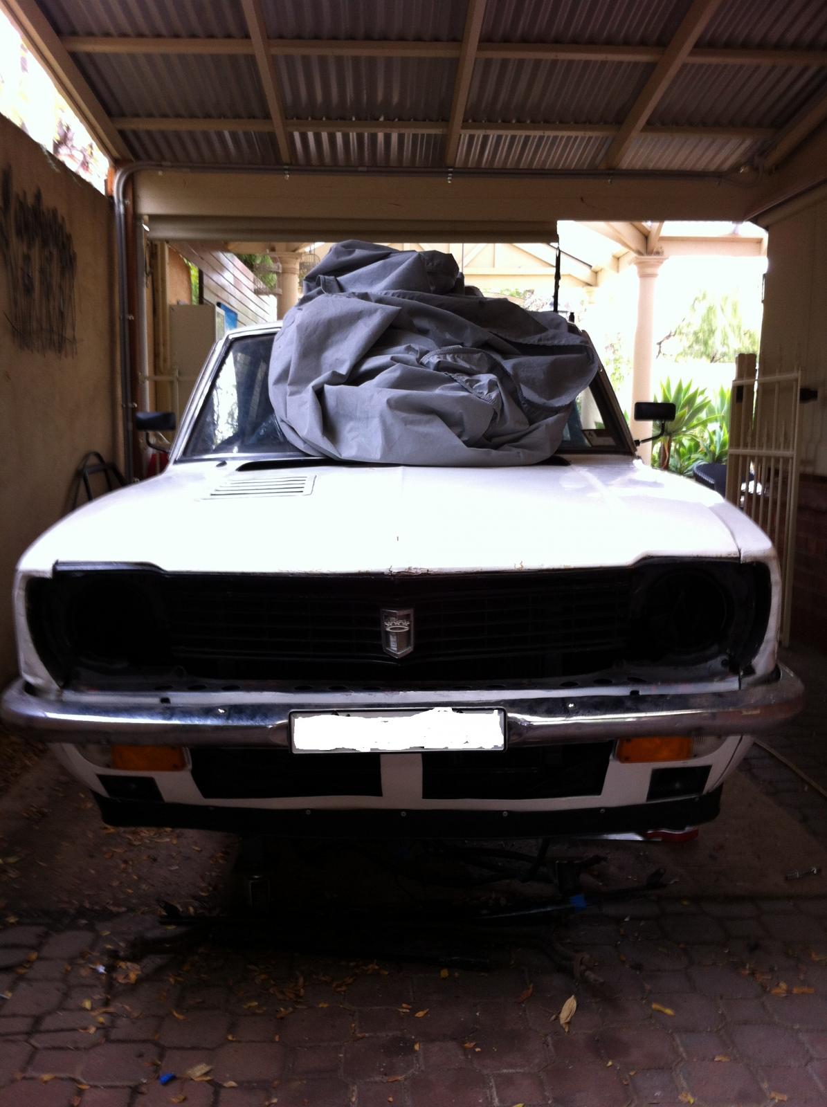

13BT_KE20 Posted May 3, 2012 Author Report Posted May 3, 2012 Old front end New front end, minus a few bits and pieces of course. Next was the boot/fuel set-up, trial fit of everything... 1 Quote

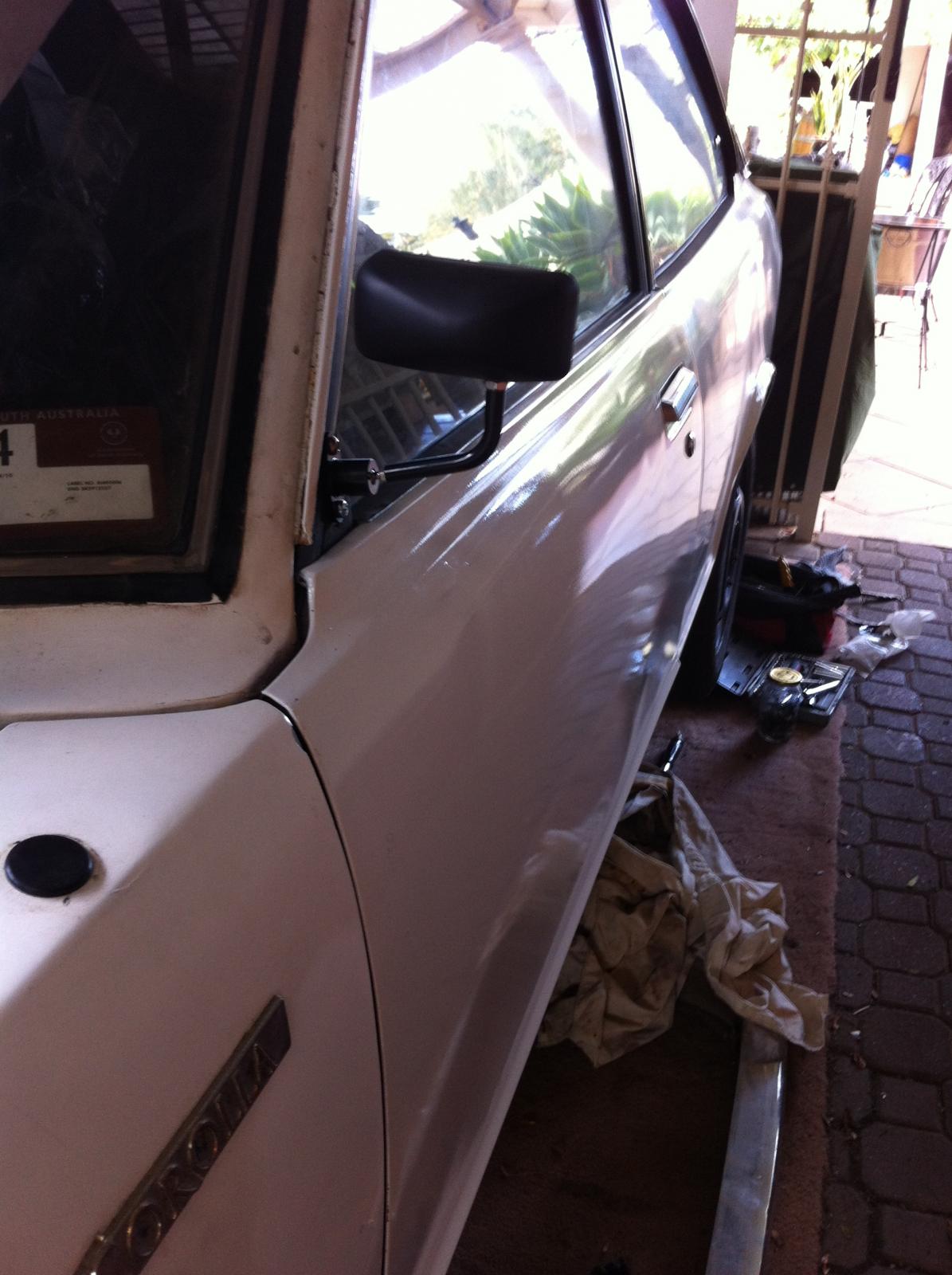

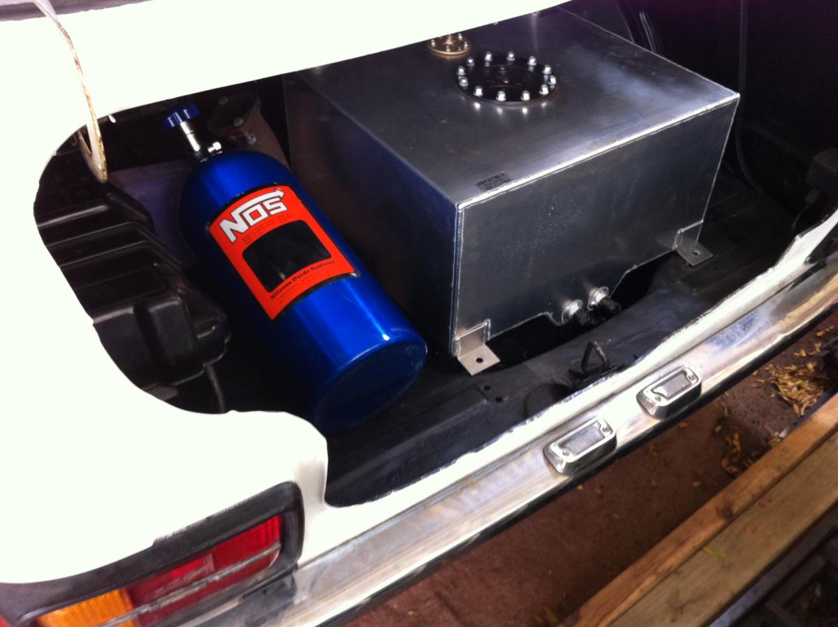

13BT_KE20 Posted May 3, 2012 Author Report Posted May 3, 2012 Fuel system bolted in, new boot seal fitted too (what a pain that was to fit!). Waiting on NOS bottle brackets New side mirrors, door got a can of paint as well Found a matching F/G vent for the other side of my bonnet, don't think ill use the aero inlet at the front so ill cut that off Quote

muv-12a Posted May 6, 2012 Report Posted May 6, 2012 Hey mate, just wondering what brand /size fuel cell you got? Did it come with a fuel level sender? That heat wrap doesn't go far! I bought 18' of to do my extractors and didn't get very far!! Good luck with the rest of the build! Quote

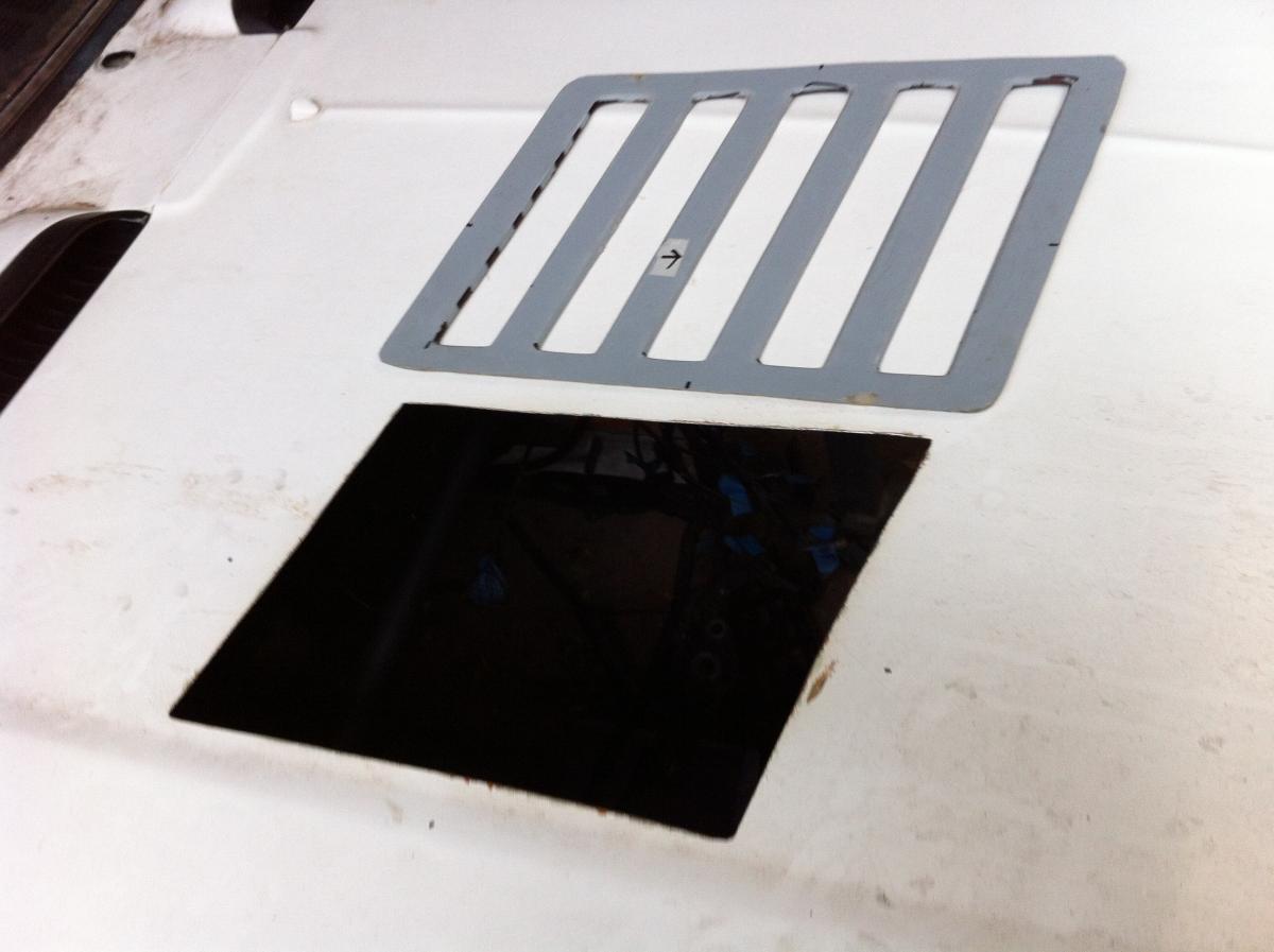

13BT_KE20 Posted May 7, 2012 Author Report Posted May 7, 2012 (edited) Hey guys thanks for the comments, if anybody can help please let me know http://www.rollaclub.com/board/topic/58449-ke2-crossmemberfront-suspension/page__p__587101#entry587101 Fuel Cell is a 57 litre (16 Gallon) Tank, the sender unit included. The heat wrap definitely didnt go very far but i did manage to get it just past the gearbox crossmember which isnt too bad. Cut/fitted/prepped bonnet vent ready for touch up paint Before pic of engine bay, all strip ready for a ckean and prep. After pic to come later.... Edited May 7, 2012 by 13BT_KE20 Quote

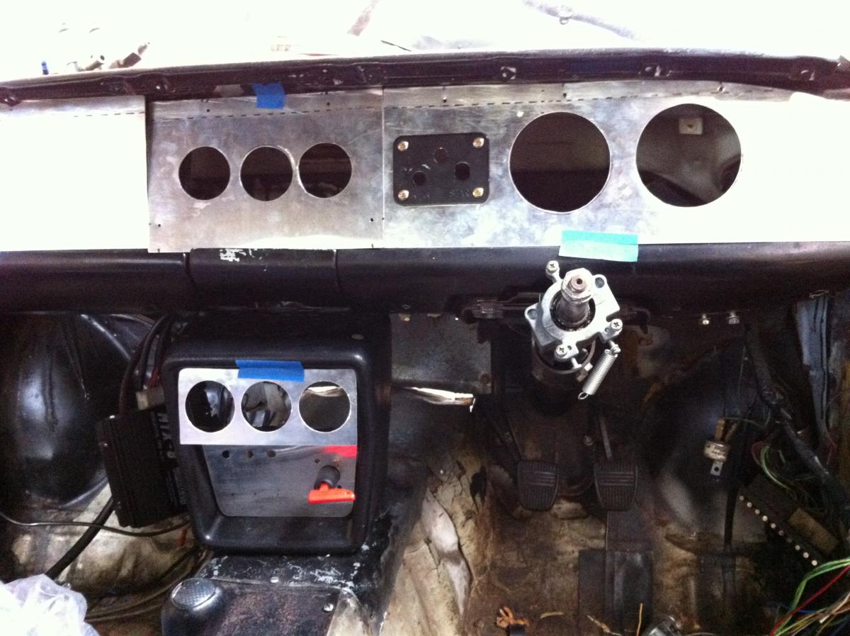

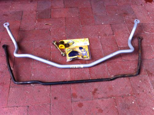

13BT_KE20 Posted May 14, 2012 Author Report Posted May 14, 2012 (edited) After many templates and several different layouts.... I ended up with this, waiting on guages and a few switches New 22mm Swaybar, Whiteline all new brackets, pins and bushes. Small improvement! Edited May 15, 2012 by 13BT_KE20 Quote
Doogs Posted May 15, 2012 Report Posted May 15, 2012 What is the sway bar out of? I didn't know they made anything that thick for a 20... Quote
