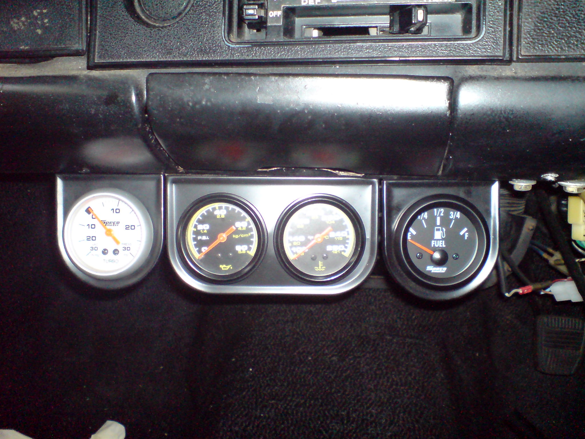

13BT_KE20 Posted July 11, 2009 Author Report Posted July 11, 2009 Hey mate, yeah i had an enlarged wastegate flap, even tried a seperate pipe and divider for the wastegate. My exhaust was 2.5" out of the turbo for an inch or so then taper up to 3". Still spiked (although less) but i think the large gate flap might of been pushing open easier due to more surface area, causing the boost to fall off even more as the revs increased. External gate off the manifold and it was spot on. If you can't get a gate on your manifold you could weld one off the exhaust housing. Hmm, well ill see how i go with the enlarged stock wastegate. Hopefully it will control the boost ok, if not ill upgrade to external one. Mounted my fuel gauge. Boost gauge will be changed to a black face one shortly becuase its the only one which doesnt match :wink: Quote
MYSTIK[RL] Posted July 11, 2009 Report Posted July 11, 2009 Hmm, well ill see how i go with the enlarged stock wastegate. Hopefully it will control the boost ok, if not ill upgrade to external one. Mounted my fuel gauge. Boost gauge will be changed to a black face one shortly becuase its the only one which doesnt match :wink: atleast now you don't have to guess when to fill up while cruising :yes: Quote
Raven Posted July 11, 2009 Report Posted July 11, 2009 Can get VDO black face gauges through work if you need one. :wink: Quote

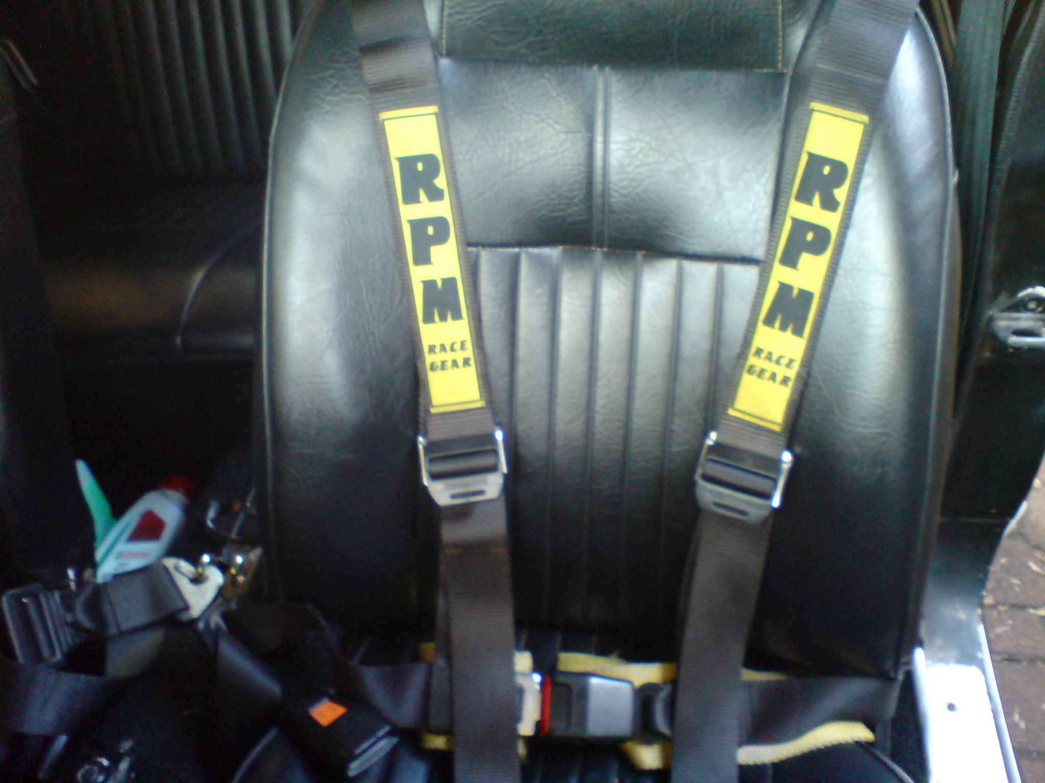

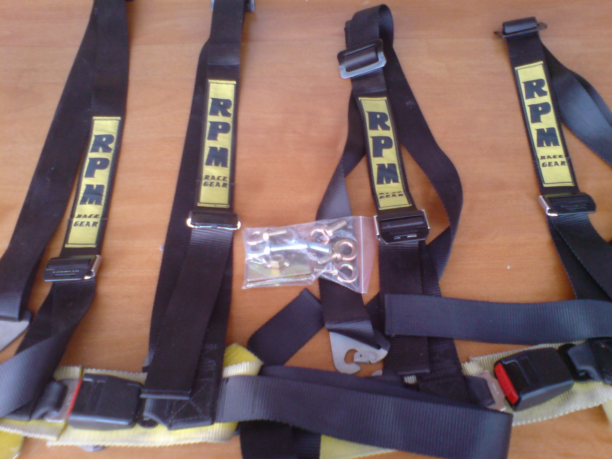

13BT_KE20 Posted July 30, 2009 Author Report Posted July 30, 2009 (edited) had the day off work/uni today so thought i finally get around to fitting my RPM 4 point harnesses ive had sitting in the shed since last year. With the new suspension you definitely slide around a bit with the stock seat and normal seatbelt. Went to Revolution Race Gear on Main North Rd to buy the mounting bolts and plates i needed which werent cheap but you can't put a price on your own safety :D , highly recommend them. Very helpful. Took a couple of hours to fit, had to remove the back seat etc to mount them how i wanted to. Was too dark for a pic when i finished so ill try get one tomorow if i have time. Looking at getting a pair of Cobra "Classic CS" seats too, there a stockish looking seat but have alot more support. Here a pic of the "Classic", the "Classic CS" has a headrest (which is a legal requirement) and makes the seat look a bit more like the standard seat. Edited July 30, 2009 by 13BT_KE20 Quote
SLO-030 Posted August 1, 2009 Report Posted August 1, 2009 Hey man, i got a VDO boost guage here if you want it, black faced too. only gonna get put somewhere in the shed and never used again. its on offer i ya want it. Harnesses are lookin good too. takes awa from the sleeper feel of the car but definatly sleeper < safety. Quote
