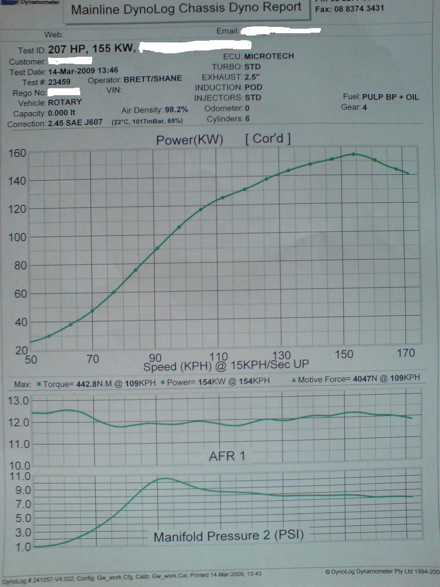

13BT_KE20 Posted March 16, 2009 Author Report Posted March 16, 2009 MYSTIK said: How did she go on the dyno yesterday? ill post up the dyno sheet when i get some free time, it pulled 155rwkw (i think, can't remember off the top of my head). More work and 200rwkw coming soon :lolcry: Quote
MYSTIK[RL] Posted March 16, 2009 Report Posted March 16, 2009 saturday was warmish and plus the dyno room had to be closed because of somedipshit across the road complaining of the noise that and different dynos will read differently, ie 74kw atfw on a dyno day, 2 weeks later i 69kw atfw, on 2 different days tempo wise as well as 2 different dynos. but still a respectable figure Quote
furryfrog Posted March 16, 2009 Report Posted March 16, 2009 Still a good result, its probably dropped in power cause of the thrashing you have been giving it :lolcry: Quote
13BT_KE20 Posted March 16, 2009 Author Report Posted March 16, 2009 SLO-030 said: it went backwards ? :y: vvvv pretty much answers it MYSTIK said: saturday was warmish and plus the dyno room had to be closed because of somedipshit across the road complaining of the noise that and different dynos will read differently, ie 74kw atfw on a dyno day, 2 weeks later i 69kw atfw, on 2 different days tempo wise as well as 2 different dynos. but still a respectable figure furryfrog said: Still a good result, its probably dropped in power cause of the thrashing you have been giving it :( haha 2 new pairs of rear tyres in as many weeks........i don't know what your talking about dude :P Quote

13BT_KE20 Posted March 17, 2009 Author Report Posted March 17, 2009 stupid scanner isnt working so just took a pic with my phone of the dyno graph. Important numbers to note: 207rwhp/155rwkw @ 154Kph 442.8 N.M @ 109Kph :P You can see how the stock turbo makes full boost nice and early and almost straight away starts to drop off, by 7000rpm its only making 6.5 PSI, this will be fixed with the Hiflo turbo and hopefully see the 200rwkw i want, pretty much only need the turbo to get it. Maybe some higher flow secondary injectors too, but thats easy and of course a retune. Quote
Jono Posted March 17, 2009 Report Posted March 17, 2009 i think those mainline dynos tend to read less than the dyno dynamics ones. Quote
SLO-030 Posted March 17, 2009 Report Posted March 17, 2009 13BT_KE20 said: vvvv pretty much answers it haha 2 new pairs of rear tyres in as many weeks........i don't know what your talking about dude :P Yea Fair enough, but none the less. more power than I'm making so a big thumbs up :( :D Has Ryan been up to naughties now that theres less breakable stuff in the drive line? If he has......MORE THUMBS UP :y: :( :bash: :bash: :) Quote
oke020 Posted March 17, 2009 Report Posted March 17, 2009 Hey mate when i used to run a highflow on my 13b the boost control issues became worse, finally got it sorted by welding up the internal gate flap and putting an external gate on the manifold so that might be something to look into. Shortly after that my 20 was into the 10s running 10.60s @ 125 :P had a jatco 3 speed in it, transbrake, was running 16psi with a 40 shot on the brake, pump fuel, i was thinking at the time that on race gas and 20 odd psi plus a little more giggle gas and 9s would be possible on a good run. My highflow had a bigger front comp housing etc so probably no ordinary highflow. Quote
13BT_KE20 Posted March 18, 2009 Author Report Posted March 18, 2009 oke020 said: Hey mate when i used to run a highflow on my 13b the boost control issues became worse, finally got it sorted by welding up the internal gate flap and putting an external gate on the manifold so that might be something to look into. Shortly after that my 20 was into the 10s running 10.60s @ 125 :P had a jatco 3 speed in it, transbrake, was running 16psi with a 40 shot on the brake, pump fuel, i was thinking at the time that on race gas and 20 odd psi plus a little more giggle gas and 9s would be possible on a good run. My highflow had a bigger front comp housing etc so probably no ordinary highflow. yes i know exactly what you mean about the boost control, most people find that they get an agressive boost spike early in the rev range. I have found this to be due to the fact people run a 3inch exhuast and dump pipe, which is in fact to large (flows too well) for the small factory wastegate and causes the spike. My car runs a 2.5 inch dump pipe and exhaust for this exact reason, my boost controller is set at 10psi so infact i don't have a boost spike. The stock turbo simply isnt big enough so is resticting the flow at higher RPM and hence drops off to the 6-7psi (stock boost) in the top end. I will be getting Adelaide Turbo Services to rebuild/hiflow my turbo, i will be retaining the S4 exhuast housing because a S5 one wont fit without bashing the strut tower (which i don't want to do). The wastegate will be enlarged and i will be running a 58mm front wheel, i think stock is about 45mm (?). This way it will be a straight bolt in/out job, no need to change the exhuast or IC piping. Basically swap the turbo over and swap the 550cc secondary injectors to 12AT one which are 850cc then retune the thing. ATM i would be wrapped with a 12 sec 1/4 after the turbo upgrade a low 11 sec 1/4 Quote

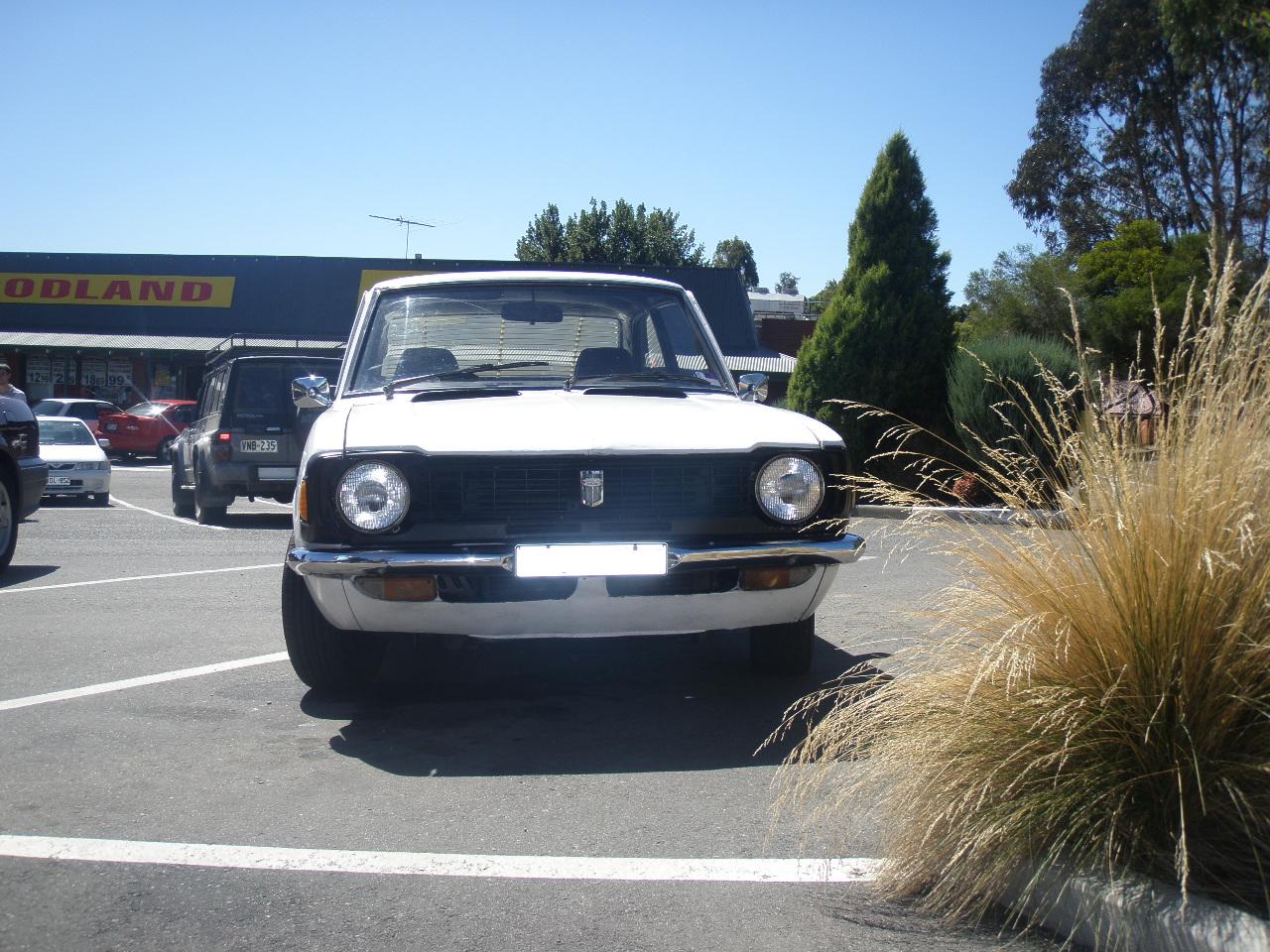

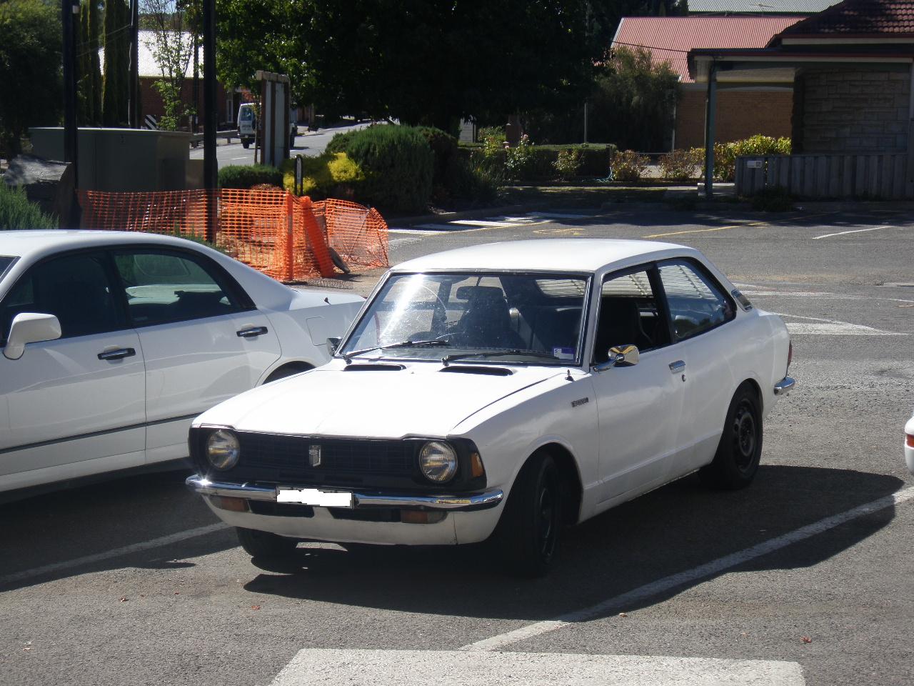

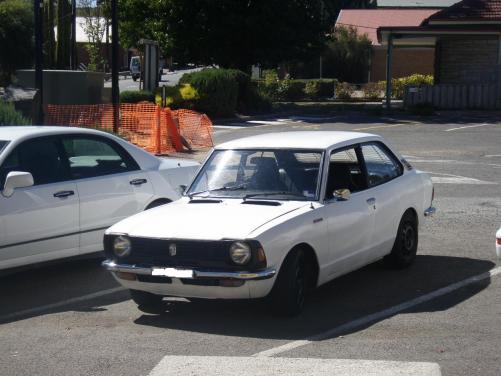

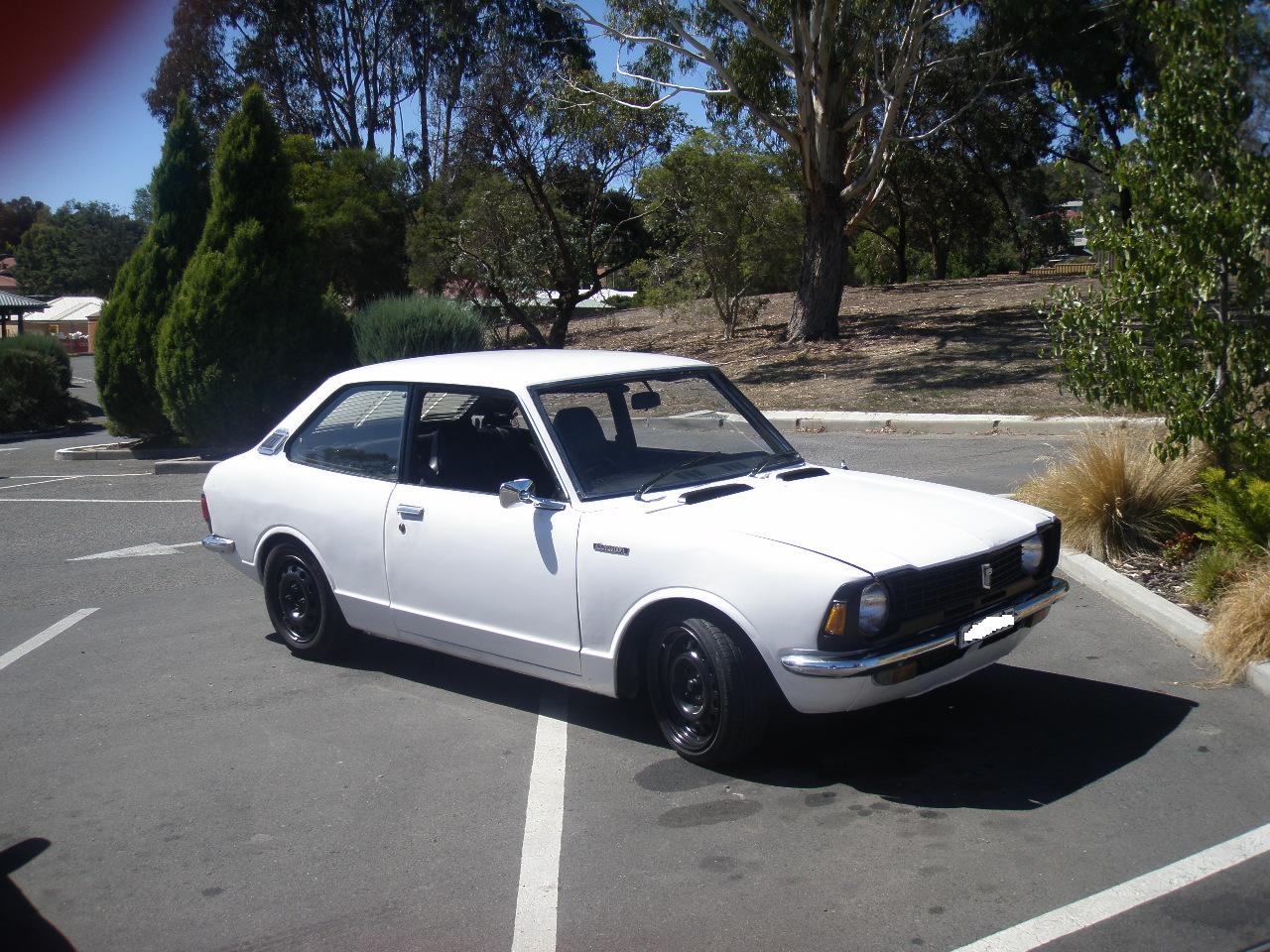

13BT_KE20 Posted March 30, 2009 Author Report Posted March 30, 2009 Couple of recent pics from the bday cruise over the weekend, updates coming soon :) Only a keen eye will spot it.... sitting in the loby pub carpark Quote
