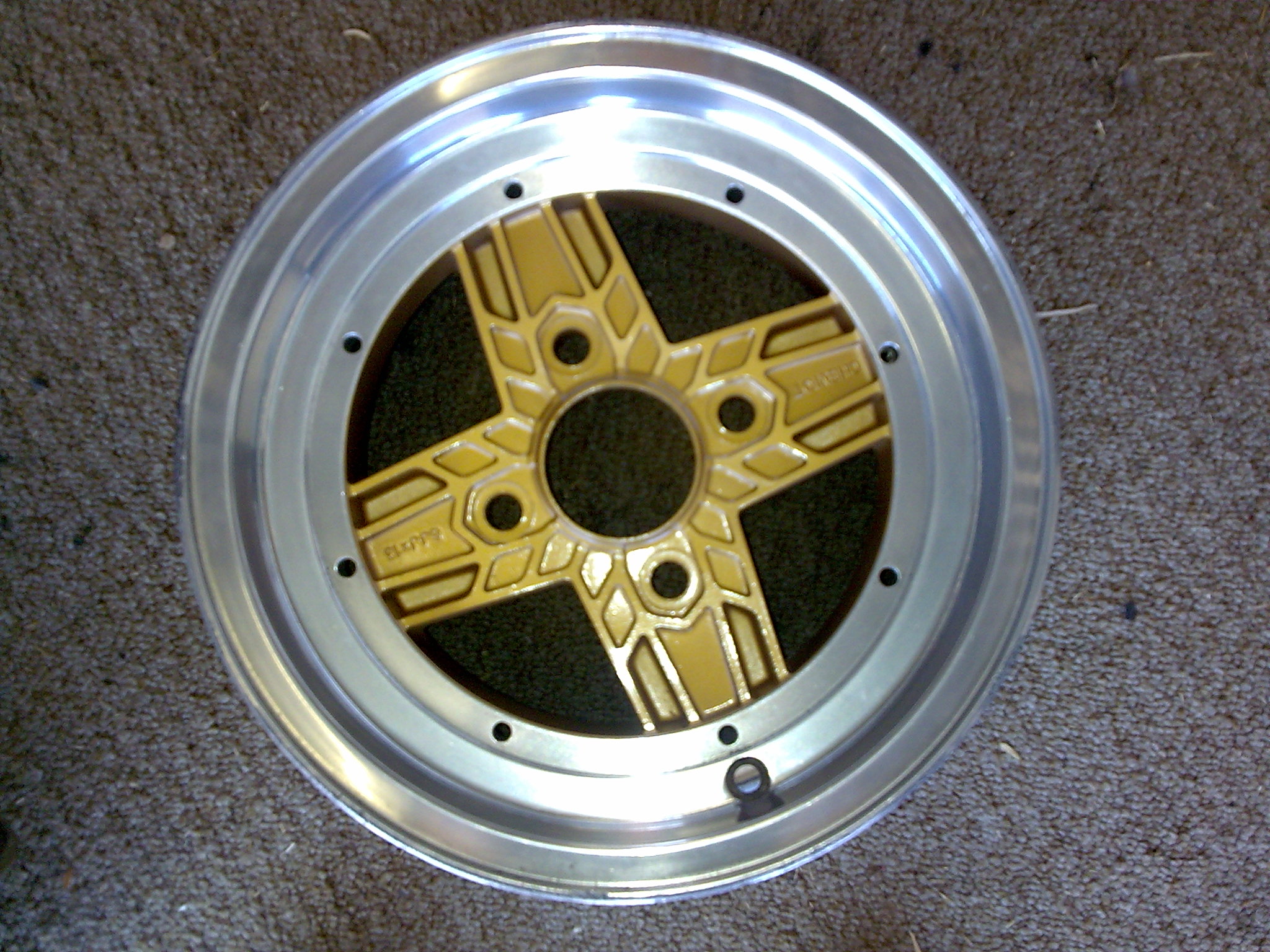

The wheels that looked awsome in the photos now look like crap from sitting in the weather for over a year so i have to redo them again which is a pain in the ass.
